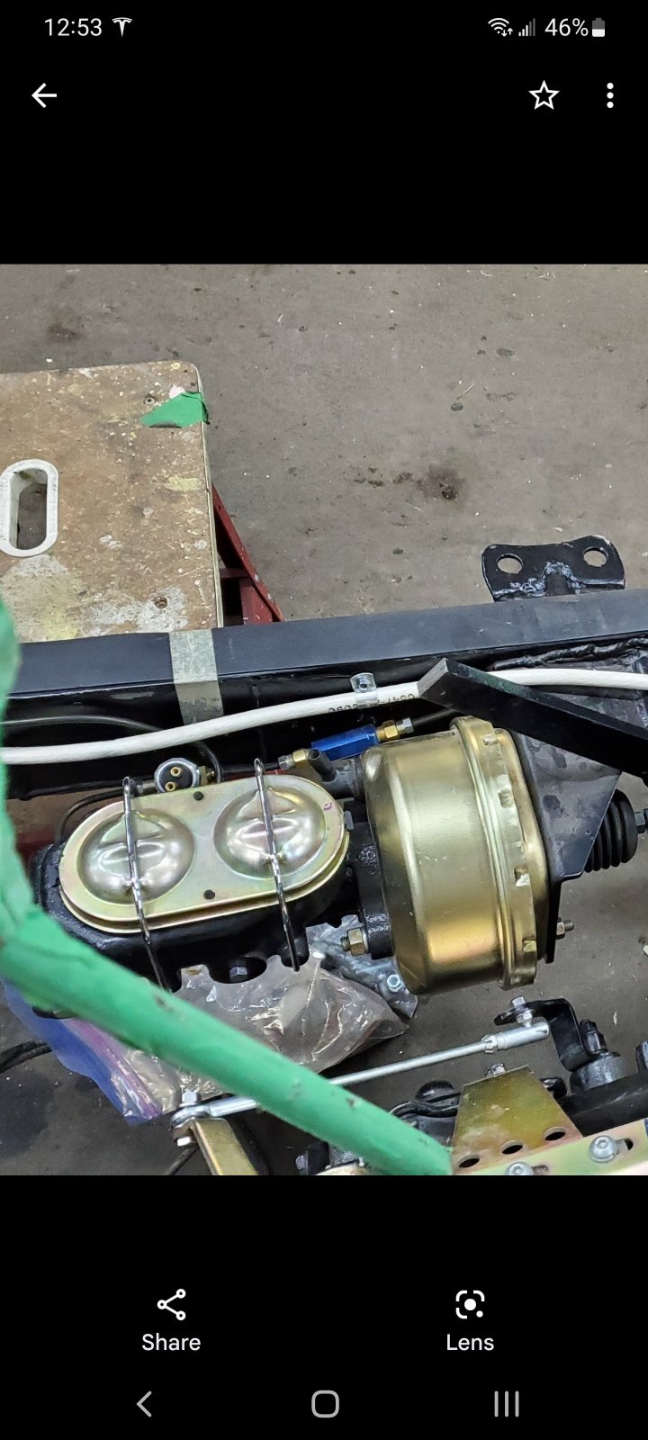

    My car is finally done, I've taken it on a couple test runs, have had a few issues and fixed them, but I have a brake issue that's perplexing me...

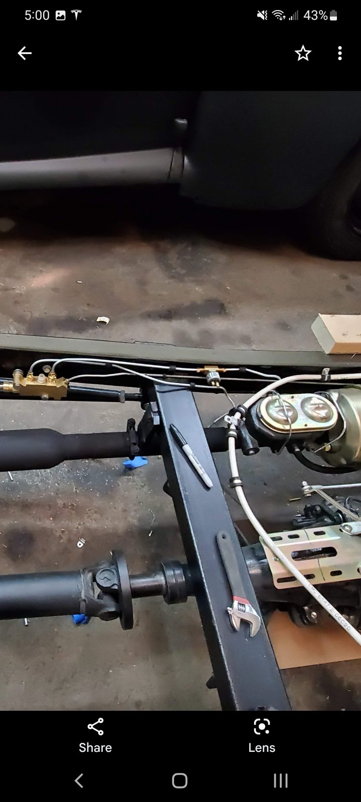

    I'm using a GM proportioning valve (see pic) and brand new disks on front, drums on back. Power ***ist booster under the floors.
    The brakes feel great while driving, but after 15-30 mins, the front pads will lock to the disk and not let go. The 1st time, I cracked on bleeder and it was fine, made it home no issues. Next time I went out, drove 30+ mins fine, got 2 mins from home and full brakes on the front again. Released the bleeder and fine again...
    3rd time, drove about 15 mins, had no issues, parked in the garage and after 10 mins, tried to turn the wheels, locked again. After a few hours, and not cracking the bleeder, they started to turn, but still a fair bunch of friction. Front discs are very HOT.
    I'm wondering how much of this is a heat issue, it's been very hot here... Not sure what I can do to remove a bit of brake pad material to avoid heat expansion?
    Thanks for any advice

    Check that you have brake push rod clearance; i.e. MC piston is fully released [out] against the retaining ring otherwise the piston will block ports and when the brake juice heats up and expands it can't return to reservoir.

    The rod from pedal to booster, as well as the rod from booster to master. The booster/master rod usually has a very fine tune length to it, and you probably need to know the specs to adjust it.

    99% sure your setup is not fully releasing the master cylinder. It is probably a push rod adjustment as others have said.

    Do you have a brake line, brake cylinder or proportion valve stationed close to an exhaust pipe or muffler??

    We know nothing about what type front brakes it has...are they GM type calipers that mount on bolts, and slide side to side as needed? or are they Wilwood 4 piston calipers that need to be shimmed to get them centered on the rotors? Or ????
    After he checks for pushrod free play, maybe we can get into the calipers...

    You shouldn't have to, you did that to get it home didn't you? The again, maybe it's that proportioning valve getting to hot? Well, that you have to move as in relocate or build a shield.
    But as Junkman pointed out as he's experienced it, your picture to me says it's far enough away?

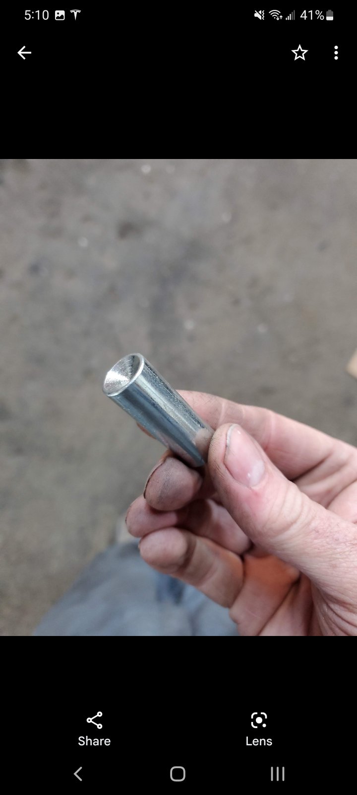

    Found a pic of the push rod that came with the brake cylinder kit. I'm not sure how anything in the rod can be adjusted, but I'm open to ideas. I went under the car (2 days ago) and had someone press and release the brake a bunch, it seemed straight, no binding, and seemed to come back out... Screenshot_20220819-171020_Photos.jpg

    The piston in the master cylinder needs to return to the fully "out" position when you release the brake pedal. If it stays "in" a little bit, it will cover the compensation port and not allow the fluid to return to the master cylinder, causing the brakes to remain engaged.
    That's what you need to check. Make sure there's some free play. Perhaps measure how far the pushrod sticks out of the booster, vs how deep the hole in the master cylinder piston is, all measured relative to the same surface.

    What you are holding in the photo is not a BOOSTER PUSH-ROD but a MC PISTON ADAPTER to use a deep bore MC on a shallow bore MC piston design.
    Your problem(s) are most likely in the rods adj (MC and BOOSTER). Was this a complete kit that came ***embled or did you ***emble from service parts? If a kit, the booster push-rod should have been adjusted correctly by the vendor.
    You cannot shim or remove lining material on a sliding/floating caliper ***embly as once you energize the calipers, they will over-ride any attempt as such.
    Once you have straightened this out, flush and bleed the system as the fluid in the caliper(s) is overheating and causing the drag (due to the incorrect MC/BOOSTER ADJ), and is most likely burnt. The pads/rotor overheat due to drag and the fluid expands causing the lockups. You don't want it finding it's way upstream (as in replacing the pads by compressing the caliper pistons and not opening the bleeders to expel the burnt fluid).
    If you need more info on how to adjust he push-rods, just ask. Is the MC (GM) a CORVETTE DISC/DISC style? You have DISC/DRUM, correct?

    Heat shield around that proportioning valve may be needed.

    That’s not the pushrod. That’s the insert that goes in the M/C plunger to work with a short pushrod, generally used with a vacuum booster. The same M/C can be mounted without the booster, remove the insert, and use a long pushrod. These are aftermarket “muscle car” parts. The two pushrods are non adjustable, so *should* be right ***uming all parts from the same supplier and matched.
    When ***embled, there should be slight clearance between the end of the pushrod (sticking out of the booster) and the cupped end of that insert. The clearance allows the M/C plunger to fully return when the pedal is up.
    If the pedal doesn’t fully retract, it could also keep the plunger from fully releasing. That’s why people are asking about the return spring.
