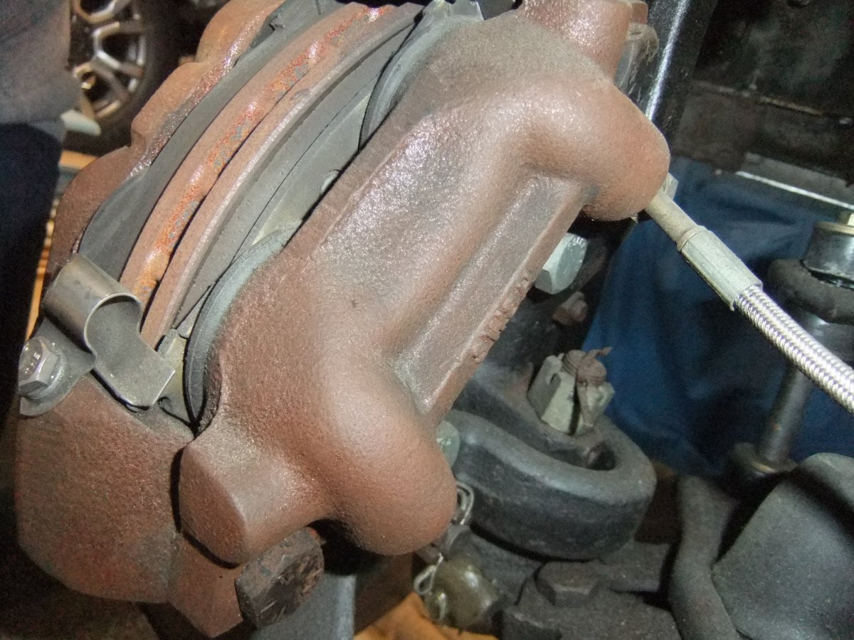

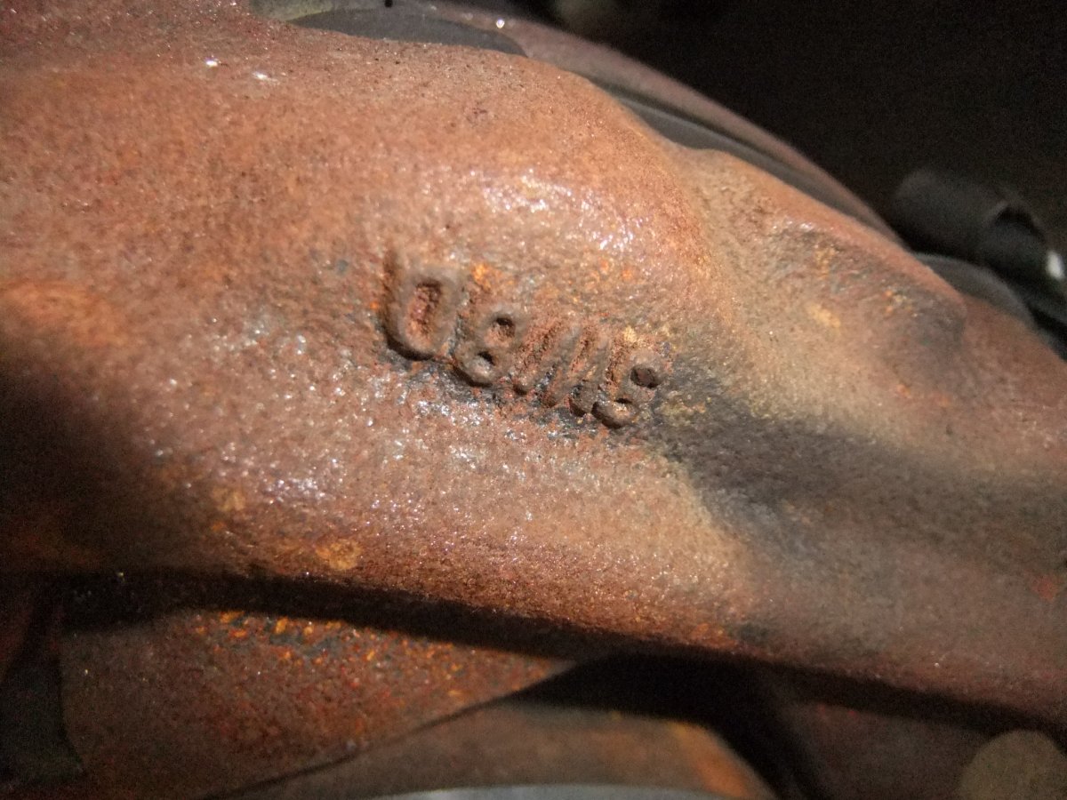

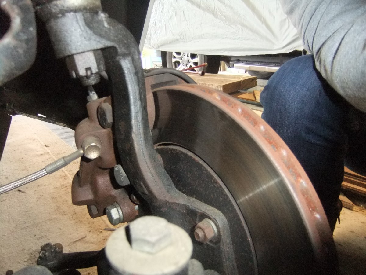

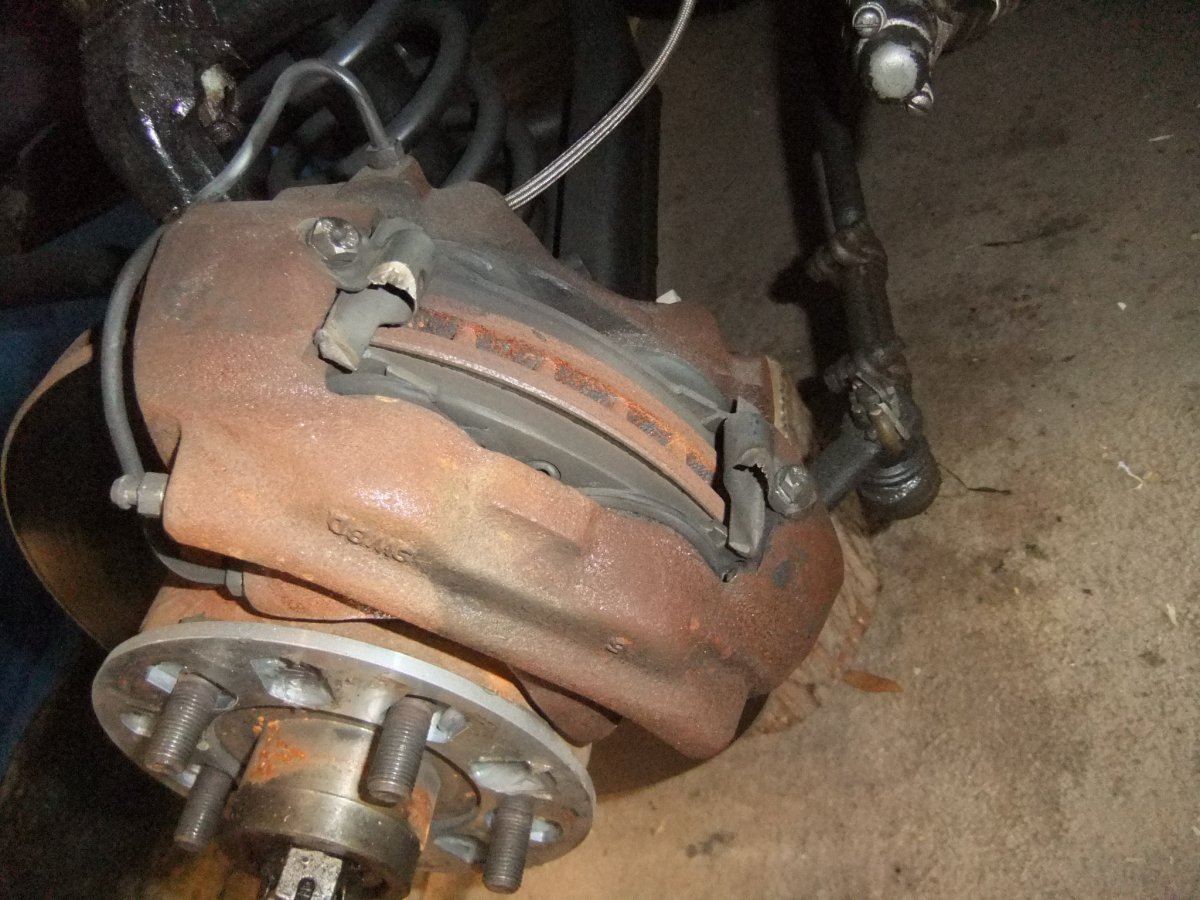

    My buddy who is n,t on the HAMB or computer literate has a 57 T-Bird which was imported into Australia and then sold to him here in Tasmania. It had disc brakes fitted to it in the USA and we need to i.d the conversion in case he needs to order parts in the future. Just wondering if any one can i.d the rotors or calipers or indeed if its a retro fit kit from a supplier. Ashleys various Nov 19 001.JPG Ashleys various Nov 19 002.JPG Ashleys various Nov 19 005.JPG Ashleys various Nov 19 010.JPG Thanks for your help.

    looks like early Mustang. As in, from the mid 1960s.

    Yeah they sure look like the kelsey hayes 67 mustang calipers

    Ya know ,I kinda thought they might be Mustang.
    As usual, the learned folks on the HAMB come through again!
    Thank you ,will pass the info on.

    Stainless Steel Brake Corporation are re-bobbing those KH calipers, rotors look like 70/71 Torino..
