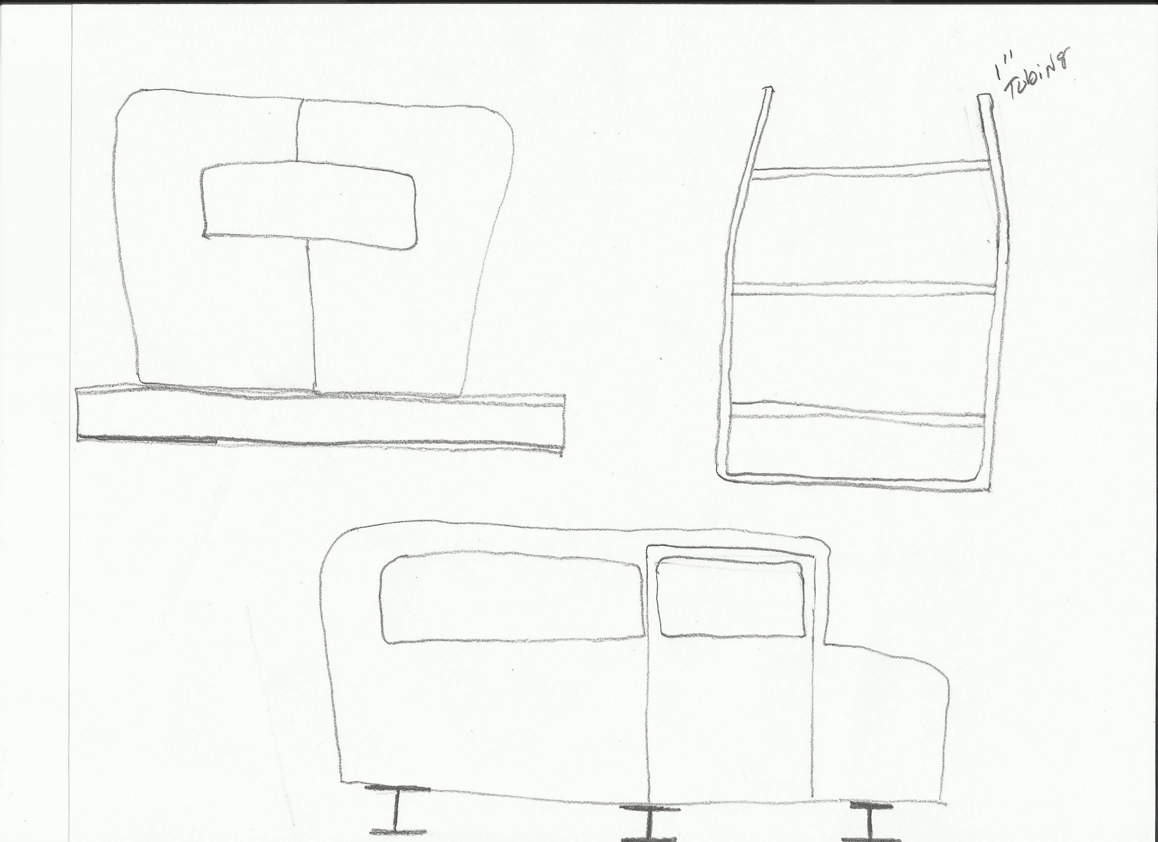

  16. skidro69
    Joined: Jan 2, 2013
    Posts: 91
    skidro69
    from Dothan, AL
    Looks like the last guy was in the same shoes as you. Dirt cheap, first time and butchered don't go together well. If the bottom is solid, you can get some I-beam or even square tubing, lay it on the floor, and set the body on it, with the beams running left to right. Then use short peices of the same stock to use in the back where it is cut, and anywhere else that u need support, to have the same height. then clamp it all together, and tack it. U can then build a sub floor, from 1.25" or 1.5" square tubing, that will set on a frame. I put 1" on scetch, but i think 1.5 will be better if it fits in the body where the old sub rails were. Good luck!
      194.3 KB
      72
  17. skidro69
    Joined: Jan 2, 2013
    Posts: 91
    skidro69
    from Dothan, AL
    Here's another great idea from Skidro!
