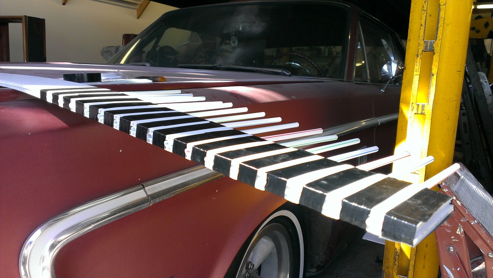

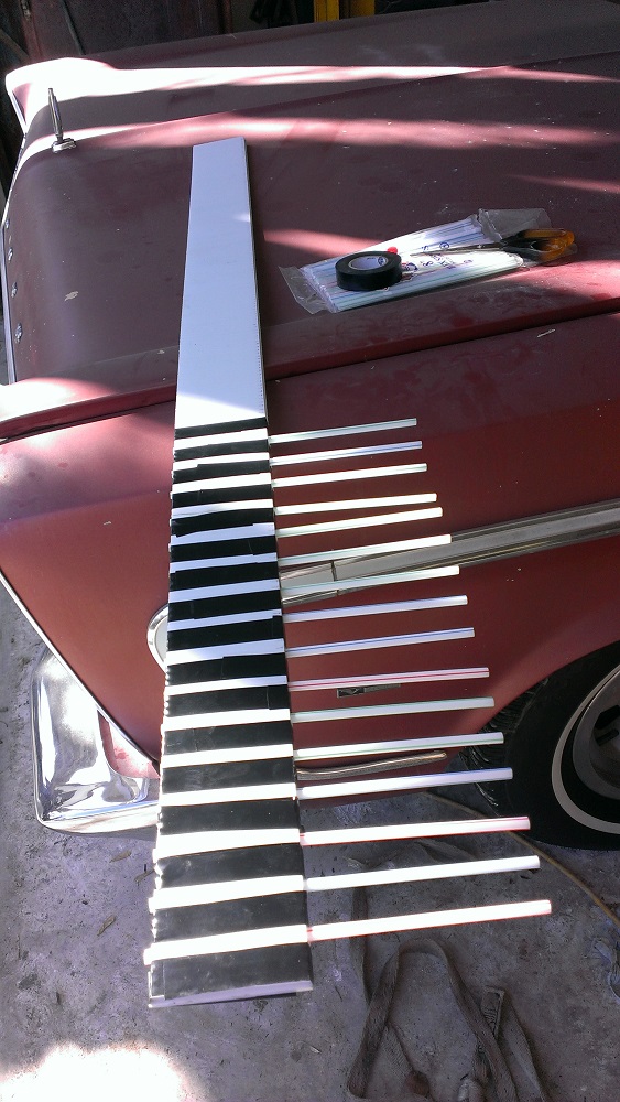

  18. Here, you inspired me. Cheep, easy to handle, easy to make. Sign board straws and black tape.
    Made between posts. Lengthen straws as per last post. This one is four ft. long. Attach two for eight feet.

  20. I can grab 1/2 of this setup at lunch :) wink wink
    Not familiar with "sign board", will that hold itself on an 8' span or go saggy?

    Yep it'll go saggy which ever you use. A pair of straight 2x4 s is used to support it. mark the 2x4s up side so that you can reproduce the patterns.

  23. You could call it the MacGuage.
    Doubled up it is fairly sturdy. Home Depot or Lowes will have sign board. It's like cardboard only plastic. Strength is relative to the direction you cut it. You can get a 4X8 sheet at a sign shop.
