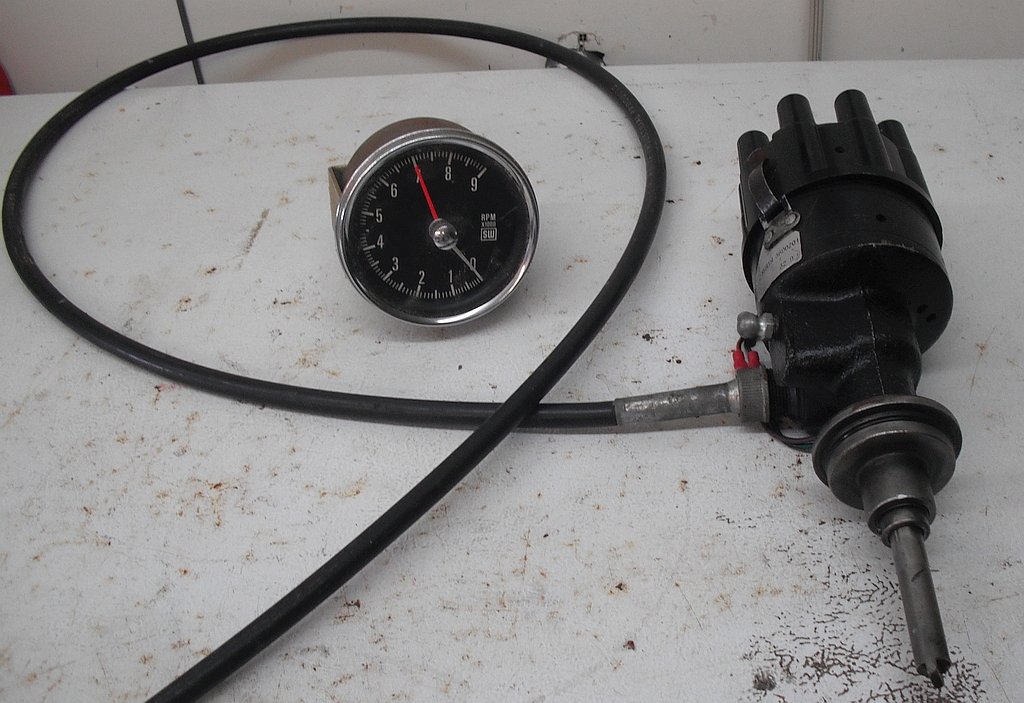

    A tarantula with a 950 3bbl, my cast iron tach drive distributor, and some vintage cal-custom valve covers would definately make a statement...:)
    warbird1, saltflats and brad2v like this.
