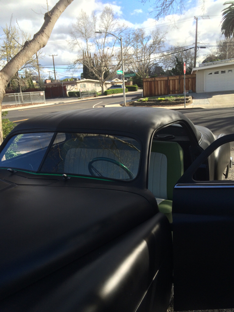

  1. Hey fellas I am in the process of refreshing my 1950 Dodge Wayfarer business coupe and I am wanting to switch up my wheels. My question is what kind of wheels do I need if I wanna run lancers or fiesta style caps. I want to run 15" wheels. It currently has 14"smoothies on it.
    Also are lancers and such full cover caps? I am pretty much a novice when it comes to wheels and tires and that is a big part of the overall look of the car in my opinion.
    Sorry for being all over the place but if anyone has info and sources on the wheels I'm after it would be greatly appreciated.
    Pic of the current wheel set up

  13. Here is an update on the wheel situation, in trying to do something else I went ahead and switched to some 57 lancers and I like them. But I am probably gonna still get some caddi caps or even some 59 lancers as well to switch them up every so often. ImageUploadedByH.A.M.B.1426050478.209788.jpg ImageUploadedByH.A.M.B.1426050504.205095.jpg ImageUploadedByH.A.M.B.1426050521.256527.jpg
    I also got my seat upholstered and am debating on what to do with the floor. ImageUploadedByH.A.M.B.1426050617.732130.jpg ImageUploadedByH.A.M.B.1426050643.284422.jpg

    Just to pick nits, the Lancers you have are '58 style, not '57. Now...just a minute, before you howl that I am mistaken. :eek: The '57 and '58 Lancers were the same wheel cover EXCEPT for the background color in the center circle. The '57s were light colored, the '58s had a black background. :)
    Ray

  20. any full hubcap will look much nicer if you paint your wheels..dark color like the body..that pissy ivory make your witewalls look like gansta tires (very wide whitewall)
  21. I'm liking your coupe too. Nice choice on keeping the wheel covers Dodge as well as traditional! You asked about what to do with the floor - if you mean covering, my thoughts would be a green darker than the upholstery and in a loop style to carry on the traditional feel of your custom. There, problem solved! :D
