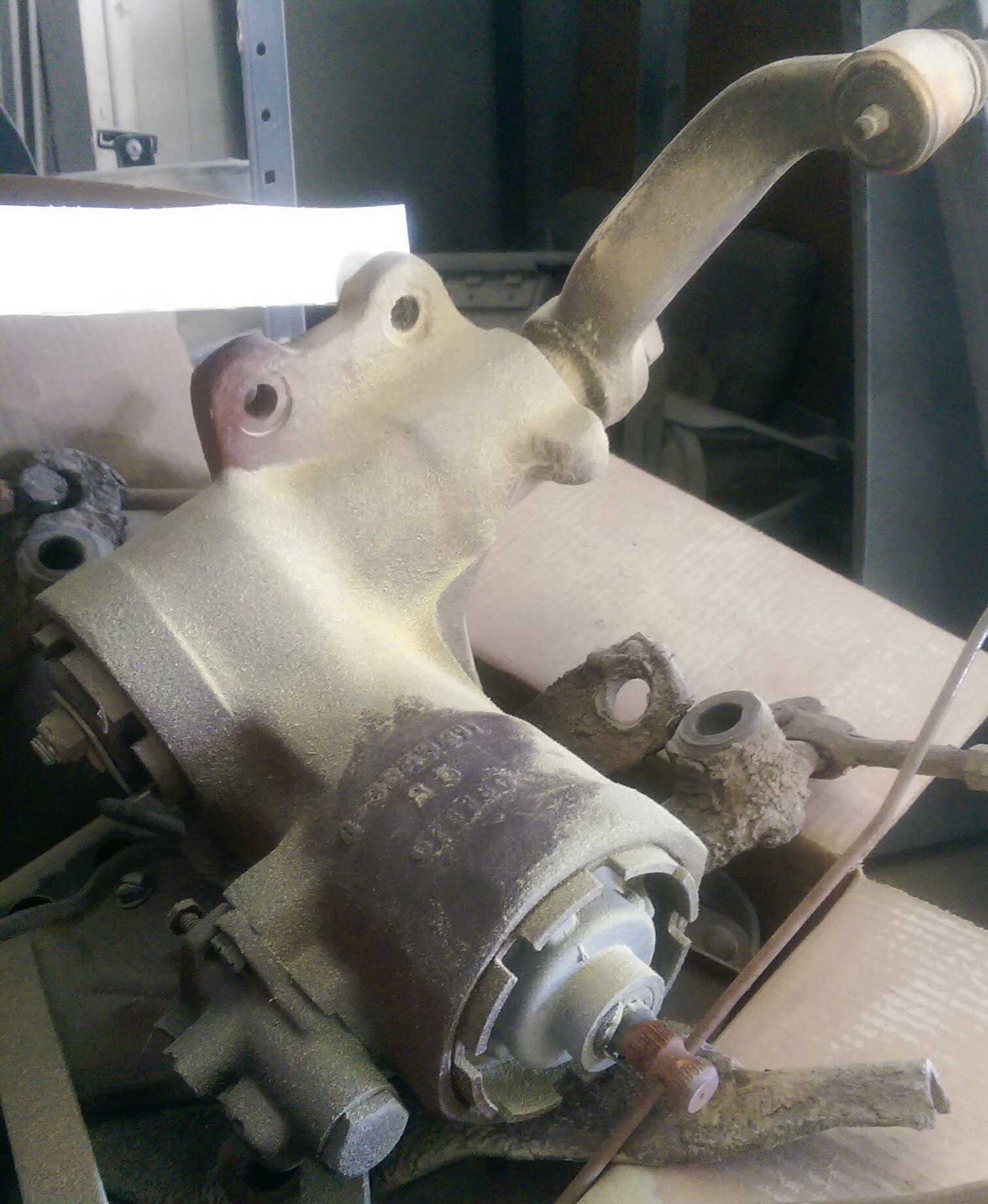

    I could use a hand identifying this steering box. It's origin is unknown, other than it came with my Studebaker.
    Any help would be appreciated!
    Thank you,
    -Phillip
  2. squirrel
    Joined: Sep 23, 2004
    Posts: 59,983
    squirrel
    that's a Chrysler power steering box, used in the 60s-70s on most of the Dodge, Chrysler, plymouth cars

    Yep,early mopar.Great for cowl steering.

    I've been looking for that answer for a LONG time, I cannot express my gra***ude enough.
    For the bonus round, is there any chance you would have a recommendation for a compatible, smaller box? This thing is m***ive and really cramps my engine compartment. I bought a 1971 Chevy Impala pump from the 350ci ch***is to help push the fluids.

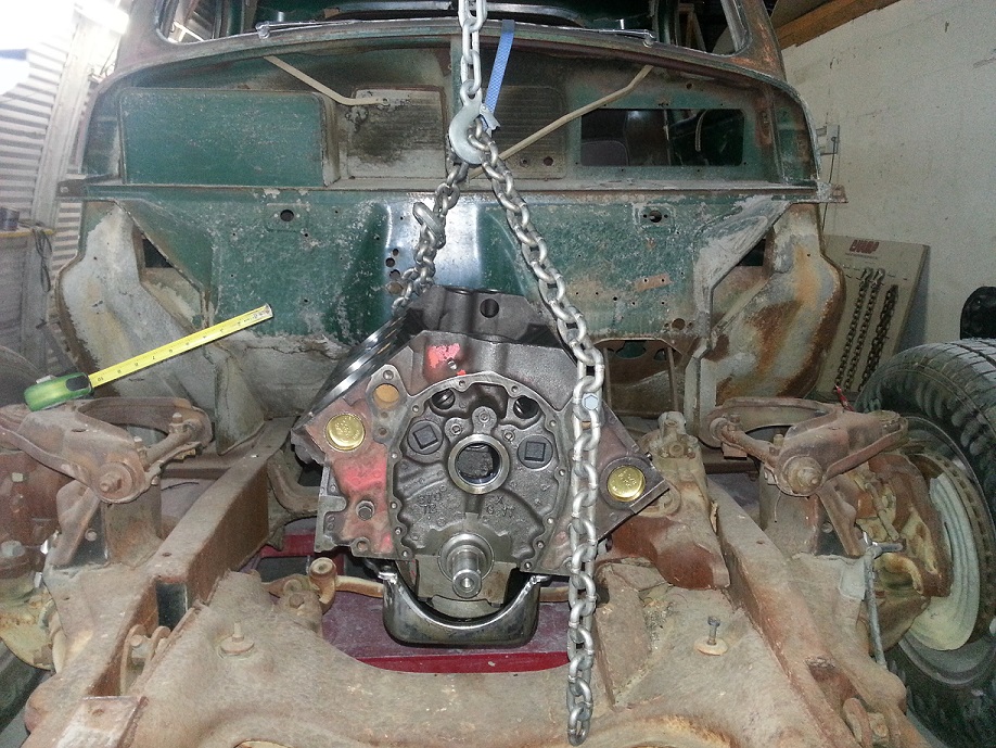

    I don't know what you're dealing with...where the steering linkage is, what the frame looks like, where the engine is, etc. posting pictures of where it has to mount might help others help you. Putting power steering in a stude is something only a few guys have done.

    Here is an image that almost shows the box. I may have other pictures, and will keep looking. Perhaps I'll find a cell phone photo.

    Oh...you didn't tell us it has a Volare suspension installed in it already. The box you have it what you need, although there is also a manual version available. It's a pain mounting an engine in a car with one of those subframes.

    Sorry, I just ***umed that a simple box for box swap wouldn't require the 1-off setup details. Technically, what you're looking at is 1991 Ford Thunderbird, at least, according to the receipt that was in the pile of misc truck papers.

    The suspension in the picture you posted is from a late 70s Dodge Aspen or Plymouth Volare. it is not a 1991 Thunderbird.
