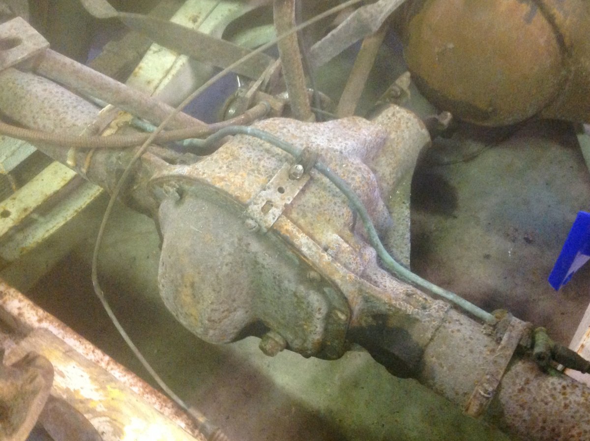

    Enclosed are a couple other shots of the differential, to be honest, I think it's going to be gone through and then sandblasted and coated. I think it will look good on the shelf. Just so amazed at what they did back then?!

    looks like a Dana/****er/Salisbury cover on it. Did you get a chance to look for numbers? This is a model 44 cover

    look in this area, both sides, top and bottom, front and back. This is a 60, which is a bigger one.

    That definitely looks like a small Dana. As Squirrel pointed out it should have a number cast into the back side of the case. You could also take the back cover off and try and google it by the shape of the bolt arrangements if it is lacking the cast in numbers.

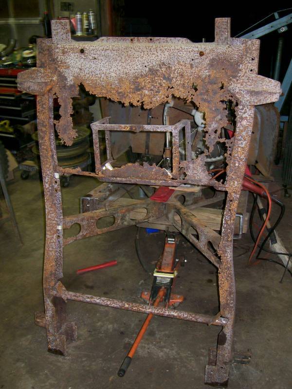

    The tires on car had first experienced flat tires allowing the car get closer and later the trailer tires flattened and then the trailer and the SS sank into Mother Earth. The year I bought it a new trailer was sourced and the remains winched out of the ground.

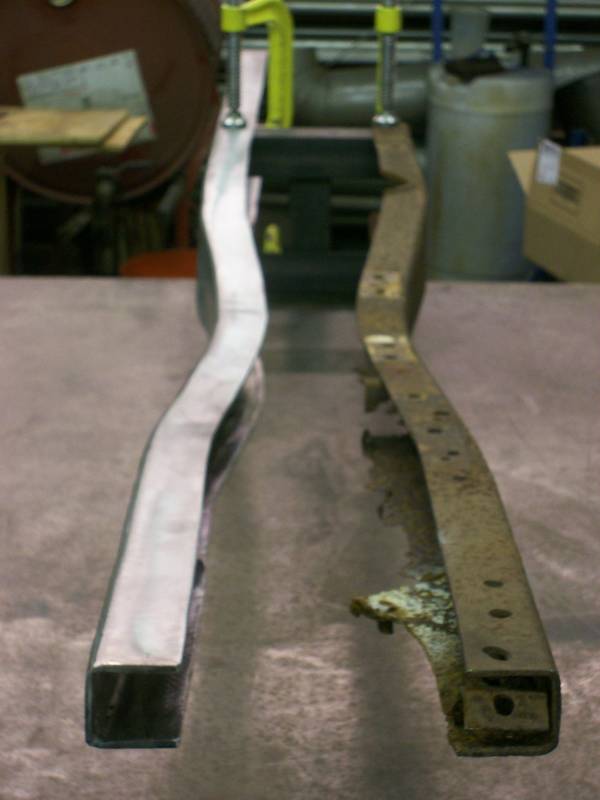

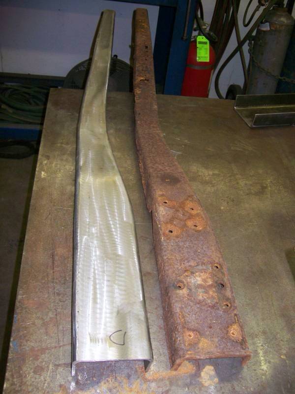

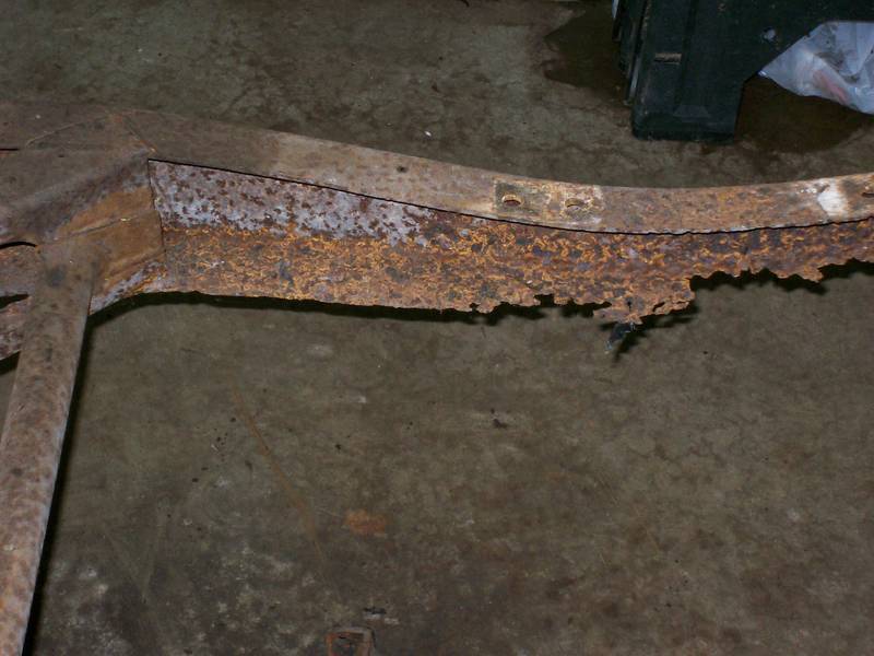

    While most of the frame was fine, the rear third of the frame rails and rear apron were perforated with corrosion and very thin.
    The rear frame was remade by myself. It was actually here that I noticed someone made from scratch some frame rails for a Ford hot rod, so I did the same. These are some of the pictures of the progress. My goal was to have it sitting on 4 wheels structurally sound, and now it is just perfect.

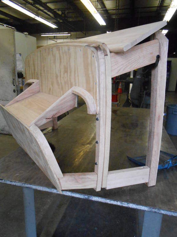

    The wood work is the cowl/firewall which represents the substructure "beneath" the metal body. The differences in dimensions are far from symmetrical, as one side of that cowl was 1 1/2" different from side to side.
