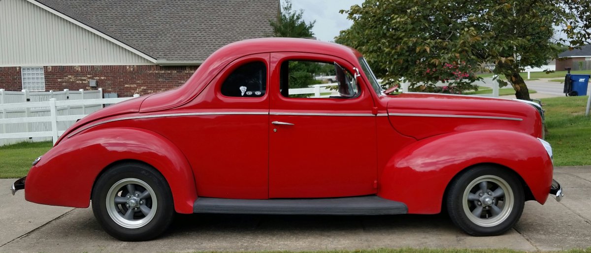

    Bought a driving street rod project years ago, 100% Henry steel, new floor, fresh 2 stage paint, interior, mechanicals needed attention, seller burn-out on project. I knew rear wheel wasn't centered in opening then. I get an occasional tire rub, could resolve with smaller tires but I'm tired of looking at the non centered wheel. I plum-bob'd the frame, cross member (MII), and axles, measured diagonals, spot on. Club member who is actively building (but doesn't have time to take it on) says loosen the mounts, remove boards, etc. but NOT front clip, get a bunch of guys and just do it. My WAG is everything above the frame must be close to 1,000 lbs?
    Anyone done something like this?

    ??? On many 40's the rear is not centered in the fenders--even stock ones are off. Have dealt with this on many 40's. Moved the rear end. Got a good picture? is it parallel leaf springs in rear?

    I think it's the one in the avatar, could be a little lower in the back too.

    The axles are spaced perfectly, hate to change that? I've changed all the mechanicals, put a Comet 8" in, don't know what the leafs are from. Have blocks on it which have caused wheel hop. I've got so much time and $$ in this I'd like to fix the body. The LR is forward about 3/4", I'd like to resolve this and put painted wheels on it. I don't want to tackle that hood alignment, shops have been locked down and probably a few went out of business, tough to get someone to look at it. This site is giving me a security error uploading pic, I'll try to do it seperately. Thanks!
