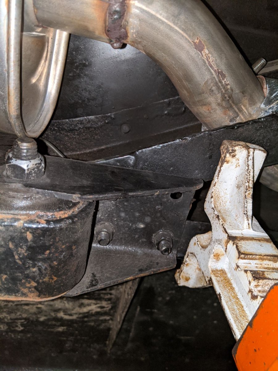

    Kinda hard to see but the front mount is at the juncture of the frame and the X member, possibly the spring is too long? I swapped out a Blazer axle with discs so I assumed the springs came with it? No ideas.
  21. ^^^^^^How many bolts are holding that spring shackle to the frame, two on just the outside frame rail? That could be a cause for the rear axle to shift side to side and rub on your inner fender in the picture above.

    No--fix what you have--those springs and brackets look odd to me and I have done a bunch of 40's
  24. I dunno, but it looks like someone cut and welded the shackles?
    Looks to me someone came up with what looked like a easy bolt in with little thought or comprehension about proper engineering.
    Not a disaster because the frame hasn't been hacked, but I would suggest a known quantity bolt-in from Chassis Engineering/Heidts to replace what you have. Same deal, but proper. And make sure everything is square at the same time.

    olscrounger and X38, great looking cars, what kind of suspensions are you running? To your points I suspect the springs, whatever they are, are too long for this application? I'm anxious to see what Eaton Spring proposes though it won't be cheap. I've been at this car for 12 years.

    Yes, it's not time to buy new springs for those hokey mounts. It's time to buy a whole new kit with a good stance built in. Do what olscrounger suggests. Most kits are pretty much a bolt in anymore, so the only real fab required might be some brake lines and exhaust.
