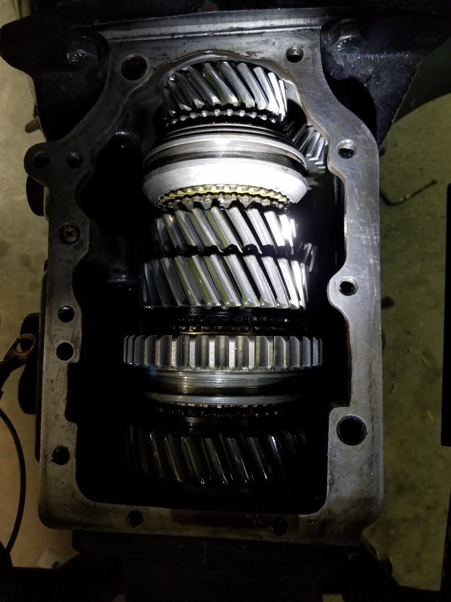

    I have a 1966 Mustang 4 speed top loader behind the 8 BA in my roadster. I know the transmission is good as it came out of my brother in laws car which he has owned since 68. Worked fine no problems at all. I had converted it to a T176 Jeep shift tower. It was working fine for a while with no complications then it got locked up in reverse and wouldn't come out. I pulled the shifter out of the top cover and was able to finally get the cover off. After looking at what I had I decided the stuff was simply too worn out to handle shifting properly. I had bought it used off a Jeep with a lot of miles on it. Pivot pin holes were wallowed out and so on so I decided to replace the top cover. Got a new cover, installed a new shifter, and put it back on the ******. Drove the car for a little bit and the same thing happened. Locked in reverse again. I figured maybe some of the other components must be as worn given the age of the Jeep so I replaced all the shift forks, the lug on the shift arm (which was worn a lot), and the spring loaded reverse loc lever (not sure what it is officially called?) Put everything back together and reinstalled it in the transmission. Shifted it in an out of 1st., 2nd., 3rd., and 4th. no problem. Shifted into and out of reverse no problem at first. Then it locked up again. So, I have a couple questions for those with knowledge of the 4 speed top loader. First is there something I am overlooking? The reverse idler gear slides back and forth on it's shaft easily as I have moved it with a screw driver to align it when I put the cover on. I can move all the shifter forks on the bench easily enough by hand. I have lubed everything up well. What am I missing? Second is how important are the two dowel bolts that align the cover to the transmission to all of this? Would not having those installed make it so the shifter forks are not in the correct position to slide fore and aft? Didn't have them from the start but found out about them by researching the web. Any thoughts or help appreciated. Really tired off putting this cover on and off the transmission with all new parts and getting no where.

    Thanks woodsnwater. I figured the old spring loaded reverse detent item was worn and that was why it was slipping out so I replaced it along with the reverse shifter fork. I now have all new parts inside the case along with a brand new cover and a shifter. Still didn't want to go into reverse. I put it back on the transmission and put 4 bolts in it just for testing it. First to second, third to fourth ok, no go into reverse? Can slide the reverse idler gear real easily with a screw driver so I'm stumped?

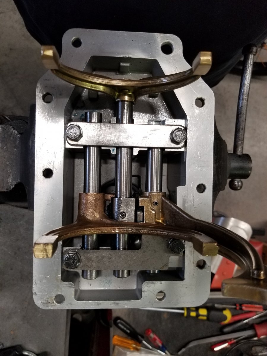

    If you clamp the shift cover in the vise and go in and out of reverse and other gears does it all feel smooth?

    If I put the cover upside down in my vise as in the second pic above, I can grab the shift forks and move them forward and backward like the shift lever would when shifting. I am just doing what the shifter would be doing but from the bottom with my hands. They all work with no problem. All feel tight as I would expect new parts to feel but can move them easily enough. The reverse interlock is new (I know that doesn't guarantee anything) as is all the forks and the lug on top of the 3 to 4 slider. I can move the spring loaded reverse gate easy enough with a screw driver so I can tell it will move out of place to allow the shifter to locate in the slot to move it into reverse gear. Only problem is when I put it on the transmission it won't go into reverse. Yes I have aligned the reverse gear so the fork sets in place over it when installing. I appreciate the suggestions and ideas. I sent an email to David Kee Toploaders to ask about the dowl/alignment bolts as there are supposed to be 2 in the cover and I don't have them. Never did. Their bolt kit doesn't either. Their reply is they don't use them at all. Still thinking they should be there though as they help locate the cover and the shift rods parallel to the centerline of the gear cluster below it. Without them I wonder if it gets twisted during install and it's enough to not allow reverse to work?

    @GordonC is that picture you posted of the shifter flipped? The reverse fork is supposed to be on the right shift rail looking at it from the bottom.
  28. GordonC
    Joined: Mar 6, 2006
    Posts: 3,504
    GordonC
    20201224_144920.jpg Yes. Sorry as it was reversed upside down when it came in from my phone to the desktop and I had to flip it around I didn't get the orientation correct.

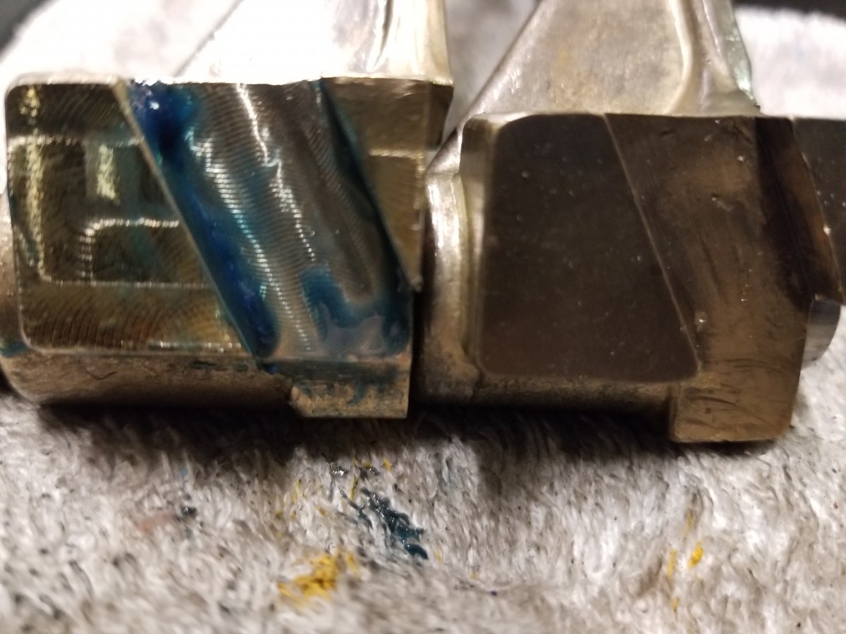

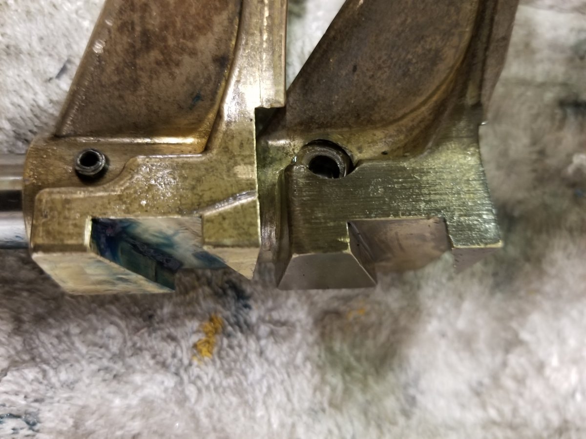

    Well I took the advice of 51box and flipped the cover over and clamped it to the edge of the work bench, installed the shifter, and tested it out. Did find some interesting stuff. What looks to be happening is the first to second fork will usually go back and forth straight without problem but every now and then if the shifter moves off line just a little bit the 1+2 fork moves a little to the side and catches the reverse shifter fork and pulls it forward out of position. Just a little which then causes everything to get locked. I could almost make it do it every time. I did find some differences between the old reverse fork and the new one in a couple areas that were critical when measured with my micrometer. I removed the new one and put the old reverse fork back in and got the same thing. The new fork was about .050 thicker where the slot comes up at an angle. Shown in the pic below. I thought maybe this was the reason the 1+2 fork was grabbing it and pulling it forward but after putting the old one back in that isn't it. It still did it. I also thought once installed the forks have to follow the gear cluster underneath in a straight line forward and backward but that also failed to hold the fork in the proper location and the 1+2 fork pulled the reverse arm forward again and again it locked when I reinstalled it on the transmission to test it. The new fork is on the left in the pic below and they are both just slid onto the shaft to get the pic. Still plugging away at this but I haven't made any headway in solving this.
    Saltflats I will check that closely but I didn't see anywhere that might show scuffing or rubbing of the fork.
