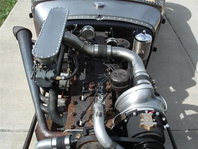

    How about supercharging an otherwise stock straight 8 in the manner of the McCulloch on a flathead ford. It's almost a fixed cost modification if you have any sort of fabrication skills. A supercharger costs about the same whether you put it on a straight 8 or a sbc. You could even use a turbo.
    Or select a 4 banger with a stout bottom end and large cooling p***ages, lower the cr a bit and boost it up to 20 psi with a supercharger and intercooler.

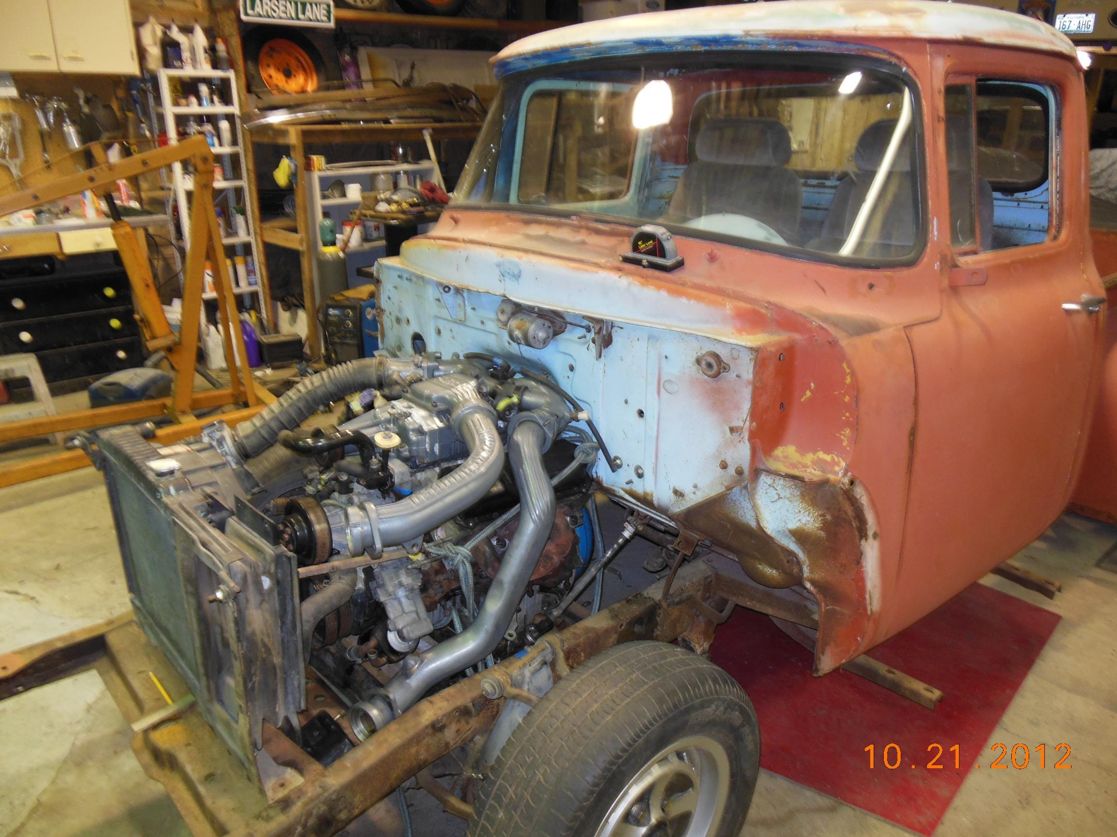

    did someone say 3.8L - how about t-bird super coupe v6, super charged?
