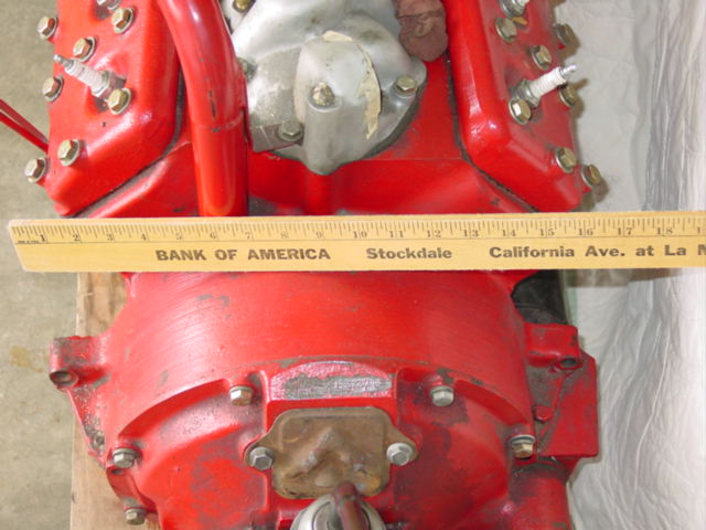

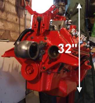

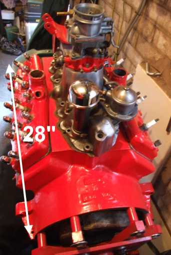

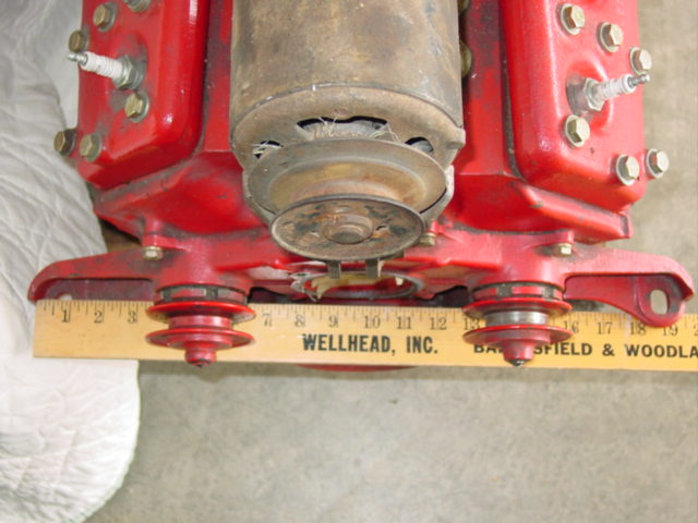

  9. Droptank
    Joined: Jan 15, 2004
    Posts: 122
    Droptank
    Here's some photos.
    Looks like 18" between holes on front mount and 10" for trans mount. Front hole to rear hole is 37" straight line.
  10. I`d kill for those waterpumps
    as you can see my V860 is slightly different than a normal one
    monkey

  11. unclescooby
    Joined: Jul 5, 2004
    Posts: 5,009
    unclescooby
    from indy
    The pictures and measurements help a ton. Strangely, they confirm what I found out too late. I'd only had one flathead ever and it was about six years ago. The "bellytanker" dragster thing I have that was missing it's flathead from the original owner really takes a V8-60 and not the B8A that I have. I went to put it in the other night and realized the problem immediately. I should have measured it first instead of assuming. This car just gets weirder and weirder.
