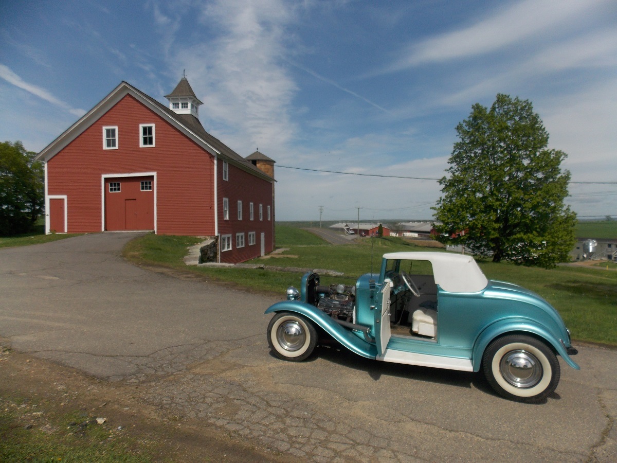

  13. jimgoetz
    Joined: Sep 6, 2013
    Posts: 517
    jimgoetz

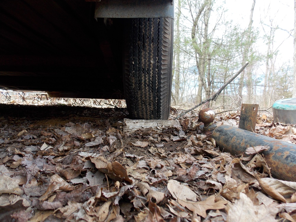

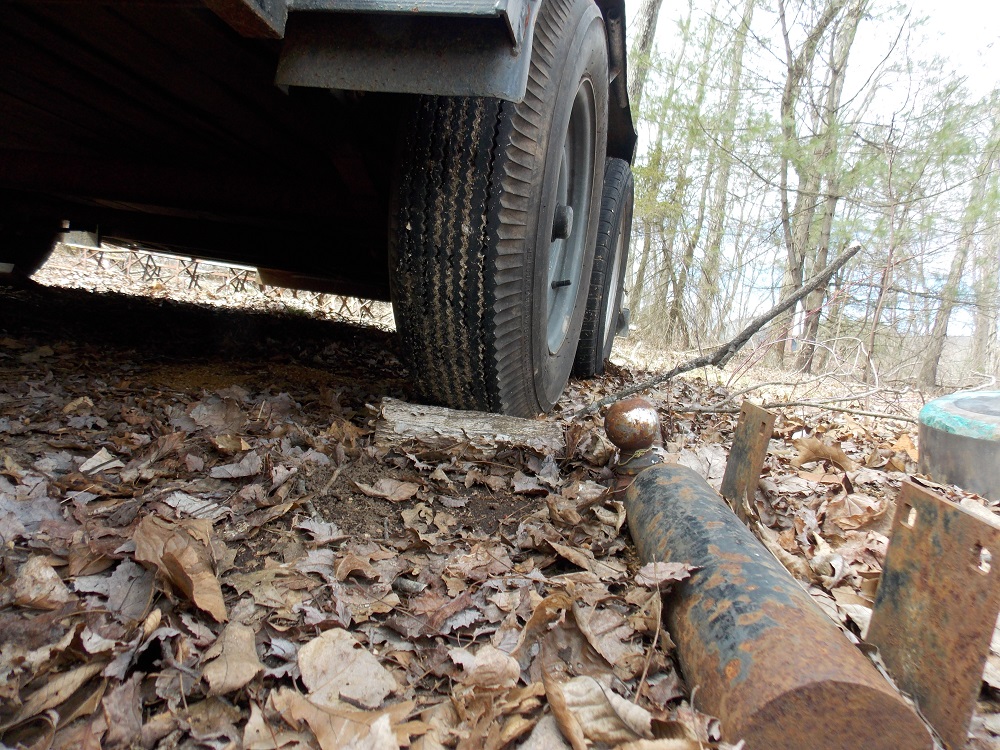

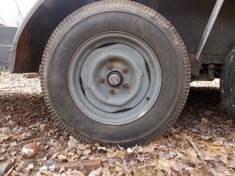

  17. F&J
    Joined: Apr 5, 2007
    Posts: 13,288
    F&J
    On a skinny tread tire like a Firestone 670-15, that imaginary kingpin line would be fine if it was at least somewhat under the tread. It's not supposed to intersect the ground at dead center of the tread width.
    You said earlier that you prefer a bigger tire on the front, compared with the modern trend of always using a very tiny tire these days...so it might look OK to you.
    When you mocked up that TT, did you try to imagine what clearance you would have at the caliper if you went with the custom-ordered deeper backspace? I'd be concerned about that because returning wheels gets costly
    Would a pic of a Firestone B/W 670-15 bias tire mounted on a chevy 6" wide steel wheel help? Unfortunately it's not on a car, it's on my car trailer. It would only show how a narrow treaded tire looks like on a 6" wheel rim.
  18. wildwest
    Joined: Jan 20, 2007
    Posts: 411
    wildwest
    That picture would help, thanks ! especially if its from the end enough to see what kind of bulge the tire has.
  19. F&J
    Joined: Apr 5, 2007
    Posts: 13,288
    F&J
    these wheels are 73-up Chevy pickup...those were 6" for sure.
    DSCN2428.JPG DSCN2429.JPG DSCN2430.JPG DSCN2431.JPG DSCN2432.JPG DSCN2433.JPG DSCN2434.JPG

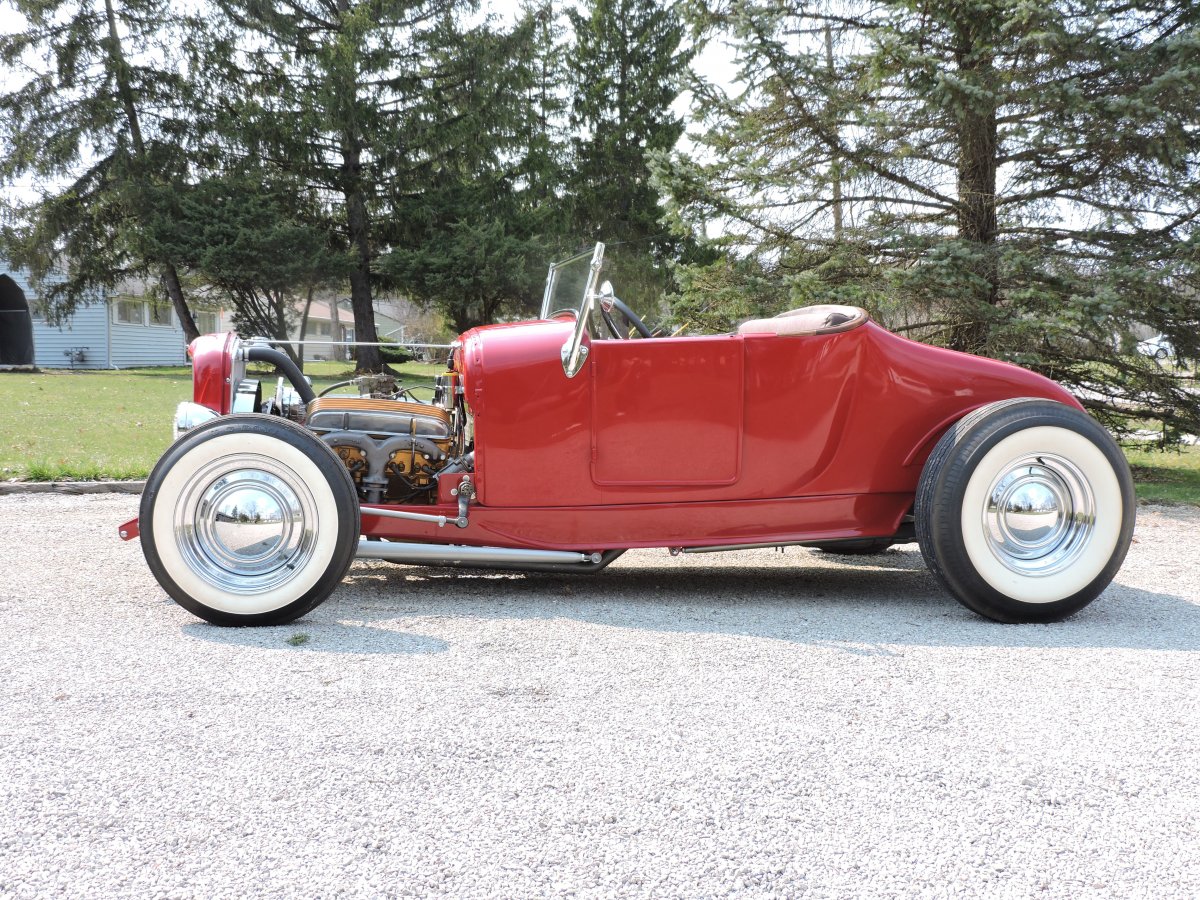

    Hi there! I also looking for wheel size help.. I'd like to get some diamond back "auburn deluxe radials". I already have some 15x7 rims and wondering if anybody has 6.70 tires on 15x7. Wondering how it looks like.. I only found these pictures of someone selling that set some time ago (here on instagram: https://www.instagram.com/p/DJHhISXNmCF/ )
    475999170_10236423254783741_5077675381519931483_n.jpg 476690133_10236423286584536_8228451560860763976_n.jpg 476210792_10236423227463058_4333377120338773523_n.jpg 475815464_10236423207062548_4153731509563271565_n.jpg 475477148_10236423175021747_8423213227608284915_n.jpg
    I'm wondering if anybody else has 6.70-15 tires on 15x7 and could post up some pictures.

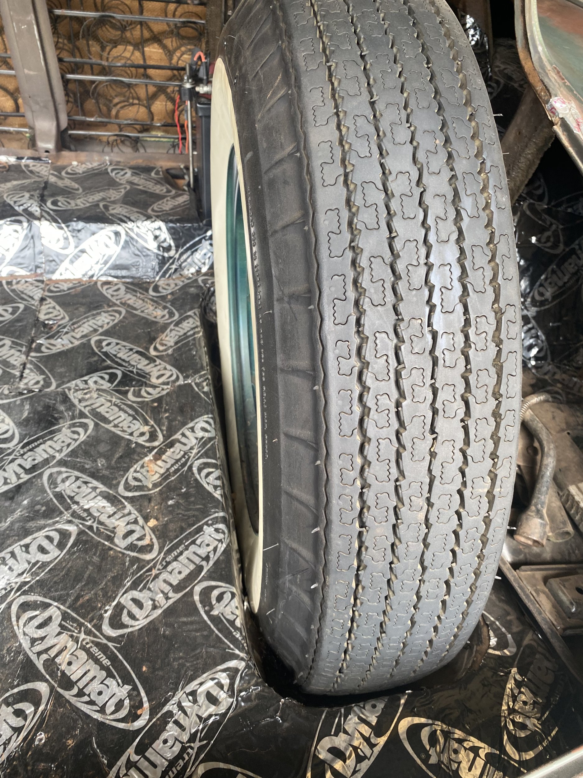

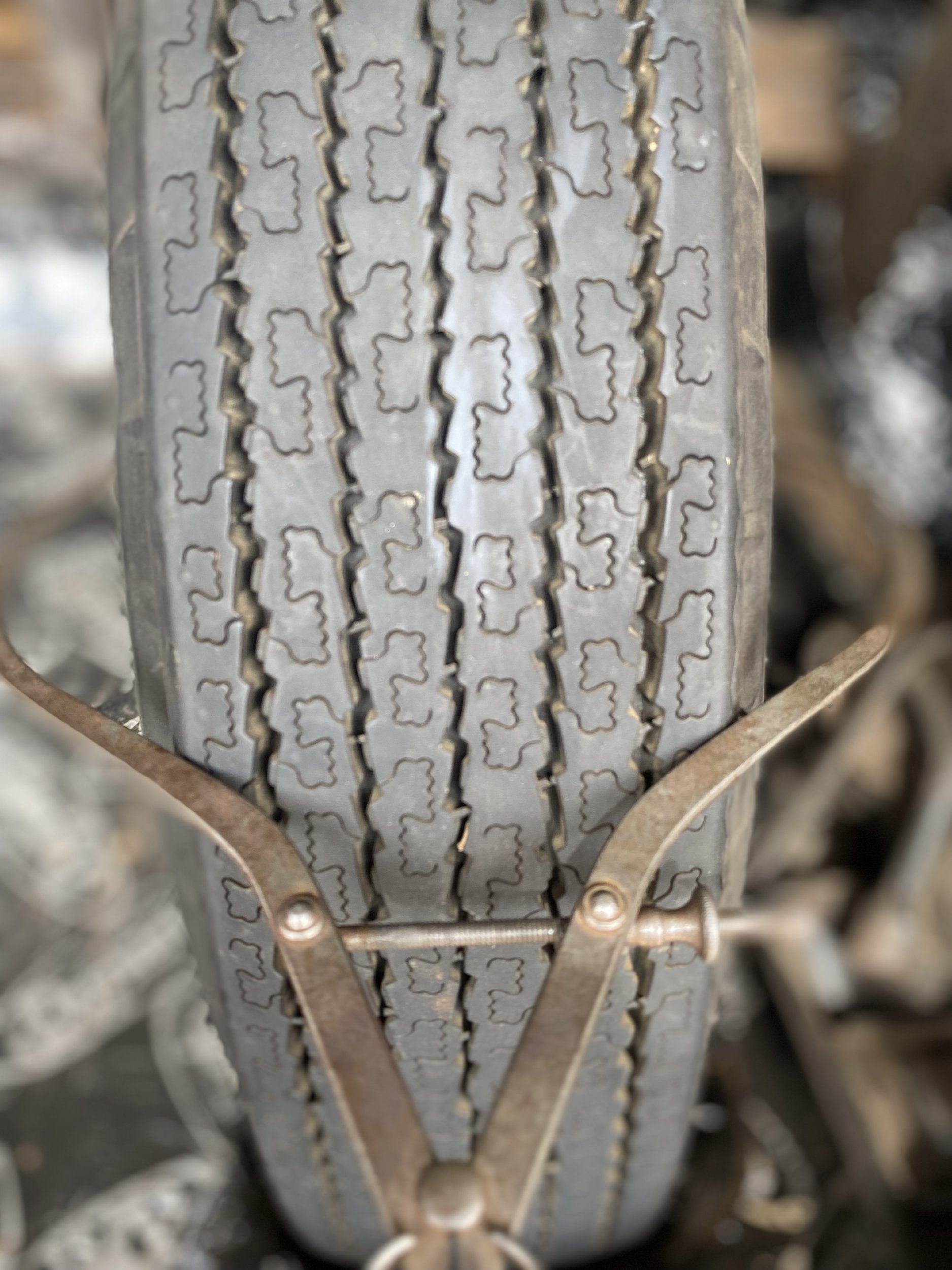

  23. 50chevytx
    Joined: Feb 4, 2018
    Posts: 99
    50chevytx
    Here is a 6.70 15 on a 5 inch also Coker radial IMG_3013.jpeg IMG_3015.jpeg IMG_3016.jpeg
