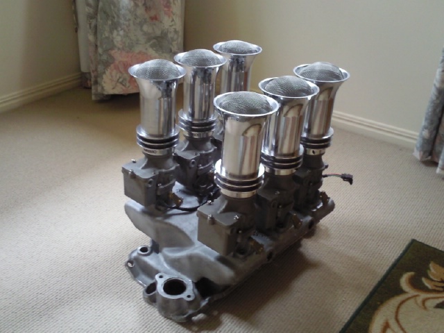

    You start with a short throw air press like this and make a series of tapered dies and shims and press the dies into the tubing and as long as everything is square and your shim progression is the same, there wont be any differences between 1 and 100. The air press which is your most expensive tooling, it can be used for other things and the dies and shims made out of rems and scraps.

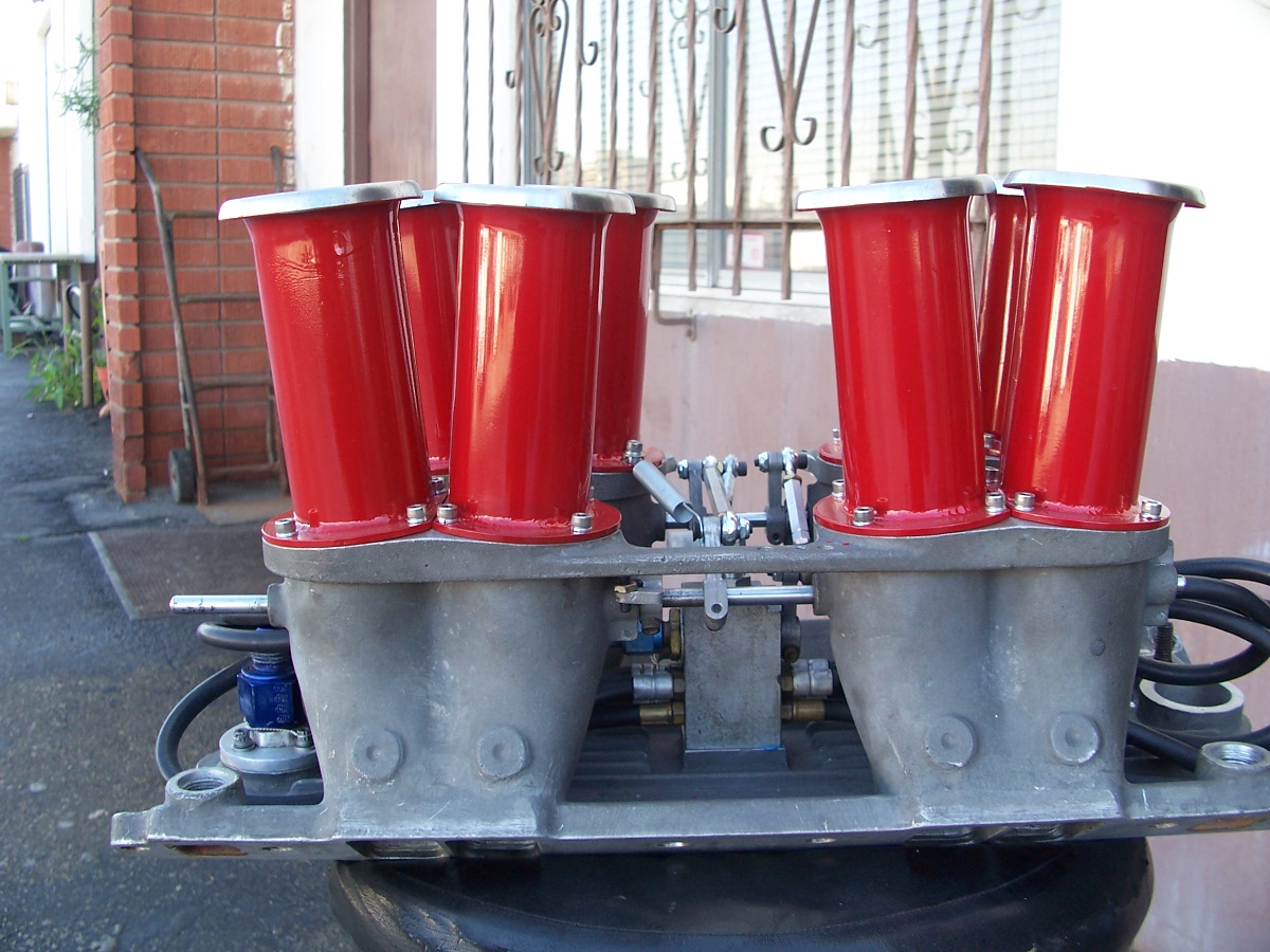

  5. Let me show you what I've made and tried to sell at local meets and shows with very little success. I wasn't interested in trying to sell these things on the internet but thought I could sell a few here and there. The gauge panels I said I would make them and get $ 150.00. I did make one of the tri-power air cleaners for a friend and charged him $ 100.00, it cost me about $ 80.00 to make. I think if you want to do this you have to really market them properly. I wish you the best with this. Pictures are your friend.
  6. that's awesome man....I was thinking about other ways to make them besides metal spinning.....what it your opinion on using a hydraulic press instead of a short throw??

    By using the short throw the ram is in a fixed location and will only go down so far each hit. By using shims to raise the peice or on top of the tapered die to lower it, each hit will be the same over and over again, need more flare?- throw another shim underneath , somthing very hard to acheive with a standard press unless you build some sort of veneir stop for the travel. Most shop presses are not that square or precise enough to get repeatability either also tonnage is hard to control.
    You would be far better off job shopping this deal out there. You would have to do to many to recoup investment. Making a part is easy, marketing the part is what kills the Idea. You need to make it for pennies to sell for dollars,making somthing for dollars and getting more dollars is very expensive, and as a bunch of hotrodders, we are a cheap bunch
    those stacks shown, after about 20 min of dialing it in , only took another 10 min to do them all
