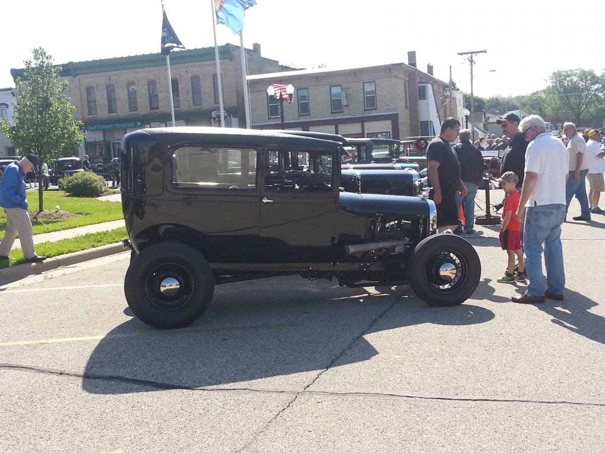

    F286FAE8-629E-4F56-B807-B94319044BC9.jpeg You can get the sedan down with mechanical brake as said and Will be as Good as juice brake with properly adjusted system. This is a Buddys *****en Model A ford sedan with 1932 front spring hangers and 1934 axle if I remember correctly .

    -Wow, that stand is PERFECT!

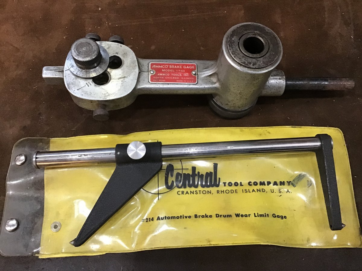

    image.jpg A few tools to help set brake shoes are a must for full contact as most are thru experimentation or trial. As well as brake drum size being on or close to the max should be a NO No. the Armco brake gauge slides onto your spindle and the pin on the other end will act as the brake drum. This is so you can adjust the shoes with out the drum and use a feeler gauge to get 100% shoe contact. The central gauge measures the drum ID and a set of calipers would work as well but most folks dont have calipers 12 inches or a inside micrometer..
