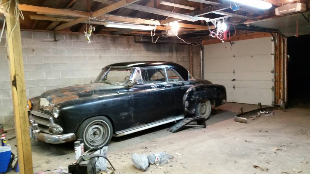

    Hey everyone, been a member for a little while now but haven't posted til now. I recently acquired a 51 Chevy Bel-air project that is a liiiittle bit of a Frankenstein. It's a 51 Bel-air body sitting atop a 1978 Pontiac Catalina frame with a 350ci and 350TH trans. The previous owner mounted the body to the frame so that the front end sits about 2 to 3 inches lower than the rear. It has a pretty tough stance to it because of the rake that it now has, but unfortunately it looks like there will be some clearance issues with the fender opening when I install the wheel and tire set up that I want to go with. The PO put 14 inch rims out front to ensure no tire to fender lip interference. I am swapping out to 15 inch wheels up front but I don't want to have to try and find a lower profile whitewall tire to mount on them to ensure clearance so I'd like to lift the front end enough to give me room.
    My task that I need some guidance on is raising the front of the body to get it where I need it without distorting the front end etc. I'm not sure about where I can lift from and how to raise it enough to get spacers and bushings into place. Any thoughts or input would be much appreciated!!

  7. chiefharlock
    Joined: Mar 30, 2013
    Posts: 14
    chiefharlock
    Here is the car as she currently sits in my garage

    Looks nice. If everything else is good raise the front wheel openings.

    Offset rims will get you out of the fender lips, but they look bad, or they look like a car with a frame swap and too wide a track width. Hubcaps can hide a lot of it, finding hubcaps that look good and fit a 15 inch wheel may be challenging.
    Fixing the channeled body, I'd cut out the existing mounts in the rear and level the body then make new mounts. You may be able to do this with the body blocked up on the frame, won't be much room to work though. Can you post pics of how the frame is mounted to the body now.
    I like the stance in the pics you posted, not sure if that's before or after you made changes
