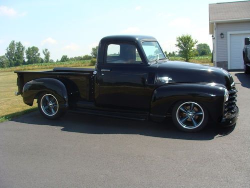

    I found this truck driving the backwood roads of Illinois,, He wasn't home otherwise would have stopped, so I grabbed a pic ,, as I like the stance,,
    I also found a gut in town removing a rearend from q 57 wagon,, Ill stop by and see what his intentions are with pics,, I saved all the info you have all posted and will start acquiring some items to get the ball rolling,, Thank you!! Its greatly appreciated!
