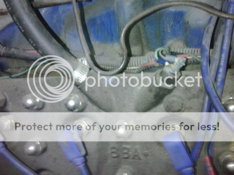

    P***ENGER SIDE
    DRIVERS SIDE
  20. daddio211
    Joined: Aug 26, 2008
    Posts: 6,012
    daddio211
    I beleive the driver's side is a "loop" where it can p*** through (in series) to the p***enger side. Whichever side is hotter drives the needle up.
    This doesn't solve your dilemma of running seperate temp gauges as you'll need a new sender for the driver's side, and they're inexpensive enough you should really just buy two.
    Hope that helps.
    By the way, this wasn't a factory wiring schematic. Factory wiring only measured the p***enger side head.

  21. captaintaytay
    Joined: May 24, 2011
    Posts: 1,250
    captaintaytay
    Then if I got correctly I need two of these. One of each wired to each gauge.Thank you. I'm just weak at electrical.:eek:
  22. daddio211
    Posts: 6,012
    daddio211
    Nope, you need NONE of that one and two of the single pole type. The type pictured is a p*** through, and since you're running individual gauges you want each sender dedicated to its own gauge.
    I'd post pics of mine, but they're mechanical not electric. Let me know if you think it'd still help.
