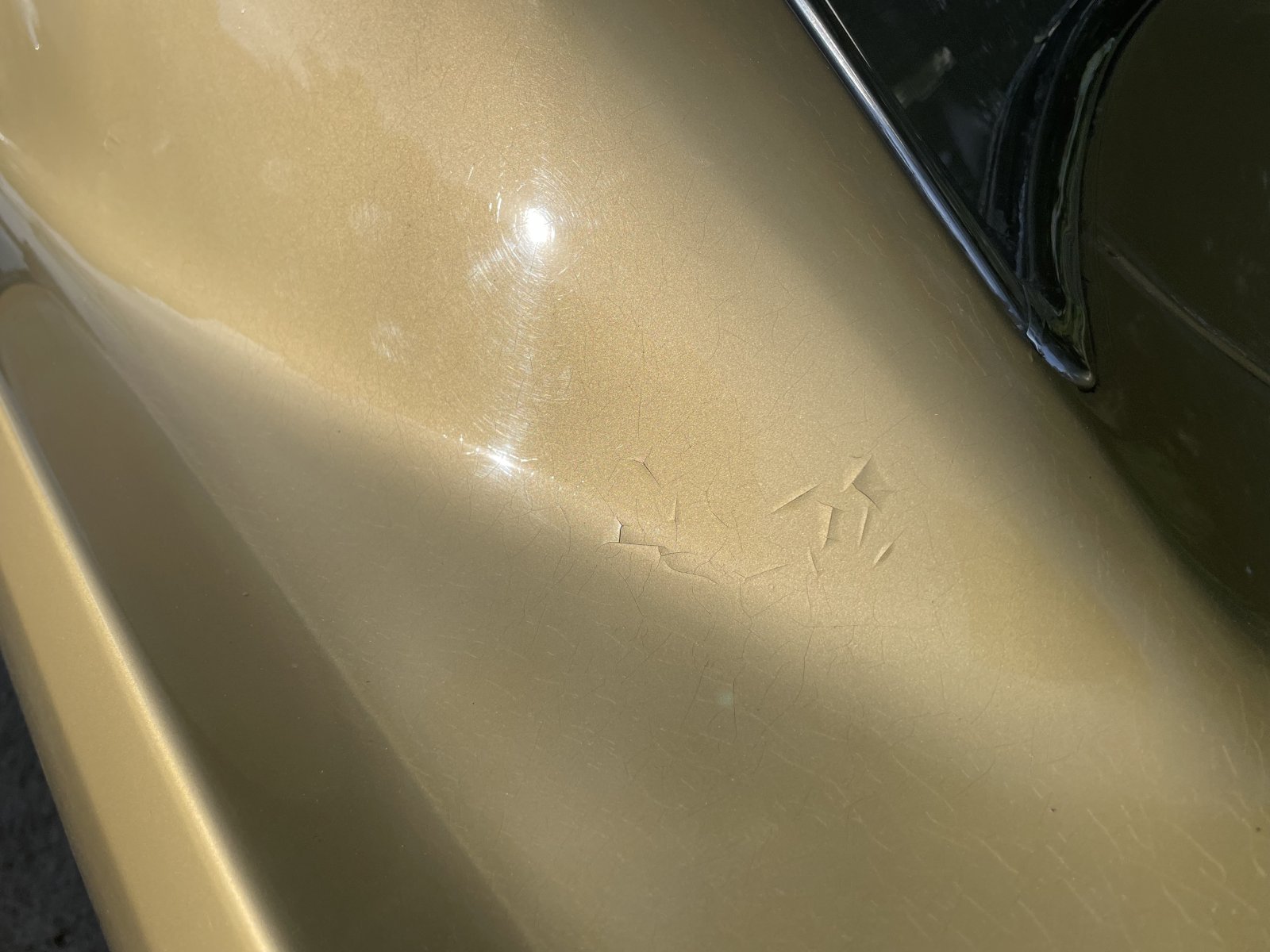

  1. 40k miles. 340 auto, original interior.
    Zero rust
    Has some paint issues
    trying to give him advice on the paint.

  6. Doesn’t look like it’s been hit
    It’s the cleanest muscle car sheet metal I’ve seen in a long time.
    The paint cracks look like lacquer. The entire car has cracking.
    But no visible body work. My neighbor located a previous owner that said the paint was cracked when he bought it in 90.

    Nice car , just curious what’s your advice on the paint?

  11. Current value vs value after spending $$$$ to spray it
    Looks like stacked up lacquer primer that’s cracked.
    The lead joints doing this is common
    Only option is to strip off the bad and repaint.
    My opinion is to leave it and enjoy it.
    Cost to repaint will probably be a wash for adding value.
    The rest of the car is very original.
    I’d just cruise it if it were mine.

    Just like manufacturers had issues with White a couple decades ago, there were issues with some of the paints/colors in the late 60s. Famously, Plum Crazy/InViolet faded badly. The metallic Greens and Golds also had issues.

    That was my thought, I’d drive it until the cows came home or the paint fell off which ever occurs first.

  20. I agree on the cracking however as I recall, GM was the only manuf. to use lacquer so it may have been painted at some time. :)
