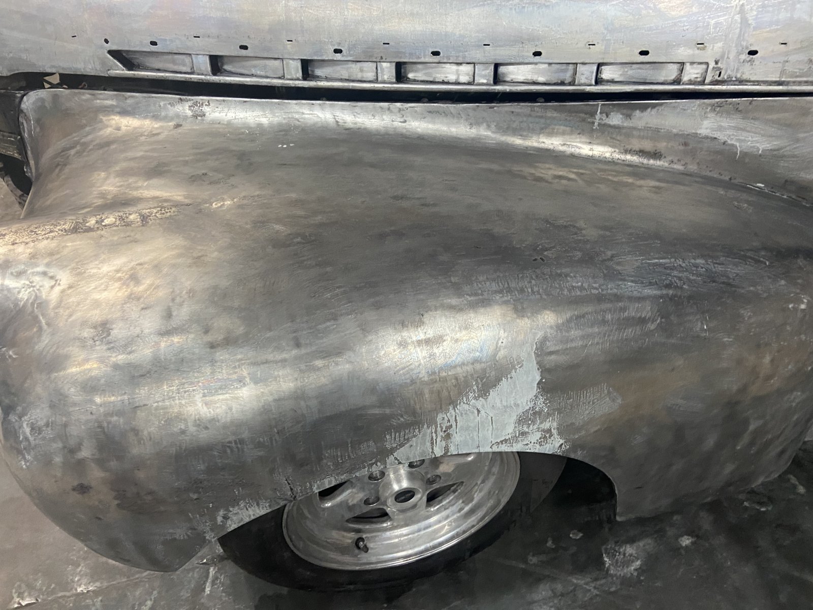

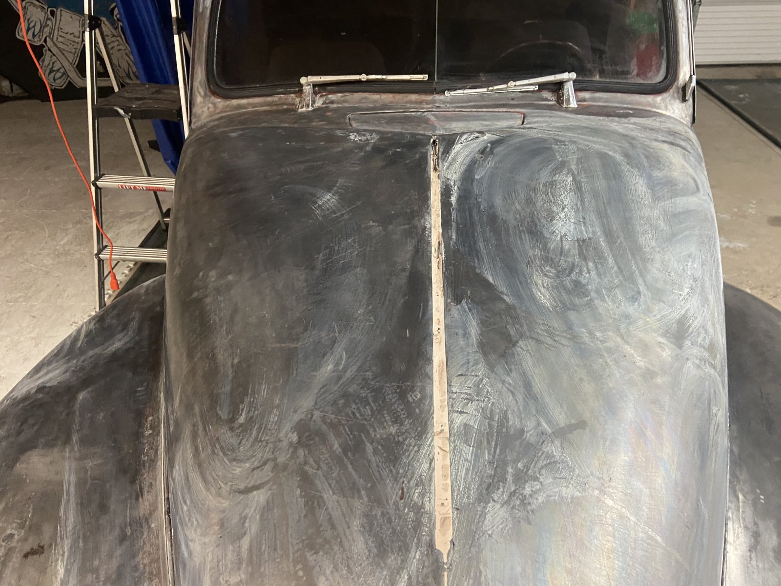

    I “think” I neutralized all of the OSPHO off my entire car tonight. It supposed to be a nice weekend here in Michigan and I’d love to get a coat or two of primer on the 41.
    Heres the steps I took: I re-wet the car with OSPHO one panel at a time, let it set a minute or so, scrub with a scotch brite pad, poured a liberal amount of soap/water over it to rinse, and then wiped off with a clean rag (new one each time). Then I came behind it and hit it with wax and grease remover.
    80% of the car looks great, however I do have the dreaded white streaks and chalky finish in spots. Though it wipes right off with a dry cloth. Does this mean I missed some OSPHO? Is the best course of action to just restart the process in those areas? I also read on another forum to hit the whole car with 80 grit on a DA, wax and grease remover after, and then spray epoxy an hour later…. I know for sure next time I will steer very clear of this OSPHO mess, lesson learned…
    Any ideas on the next course of action? Thanks!!!

    I think I would re-wet the places with the chalky finish, hit it again with the scotch brite pad, re-rinse and dry it off again. I suspect those places probably have some residue left, but I would not want to add any more OSOHO into the situation.

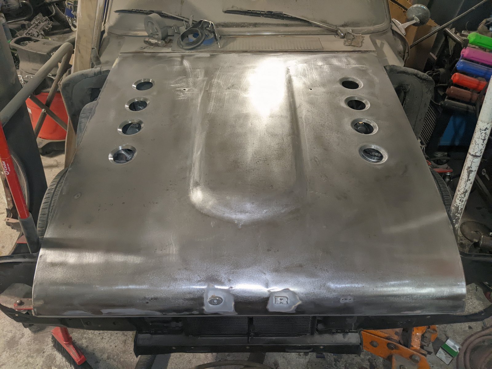

    This hood was treated and allowed to dry. Once fully dry, I wiped it down with mineral spirits and a red scuff pad. This is how it looked once dry.
    If you look at the instructions, you will see that no mention is made of neutralizing it.
