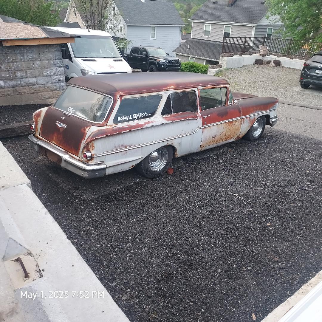

    I like OSPHO. what I do is pour some into a small container or spray bottle, using an old toothbrush, i spray or dip it in the OSPHO and spread it around. the brush allows me to get into cracks & crevices and to spread the pooling. i let it dry and then brush paint over with oil based Rustoleum (inside doors and floors). I have done surface parts of this 58 and just let it dry, no paint. 58home4.jpg

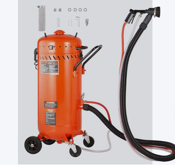

    Have you used one of these dust less sandblasters? I've read mix reviews on them.
  18. 29Sleeper
    Joined: Oct 25, 2023
    Posts: 1,058
    29Sleeper
    from SoCal
    No - looks like one of those products that works well for the specific scenario in a demo video but not in real world use.

    I didn't find this product online, but the other gl*** blast media products I found say that they do peen the metal.
