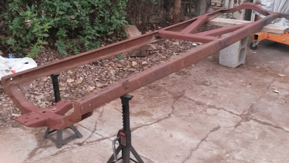

  1. I'm starting with the pile of parts I've ac***ulated over the years from cast aways and freebies. The frame is a pre-26 T I had laying around that I always knew I'd build someday. I also have some tweeked 1926/27 frame rails I plan on using for crossmembers & step up pieces. The body is a cut down '27 T touring and motor & driveline will be all Model A. I'm looking to emulate the post war style as much I can on my tight budget. 20161009_131134.jpg

  2. cool, but let's see more

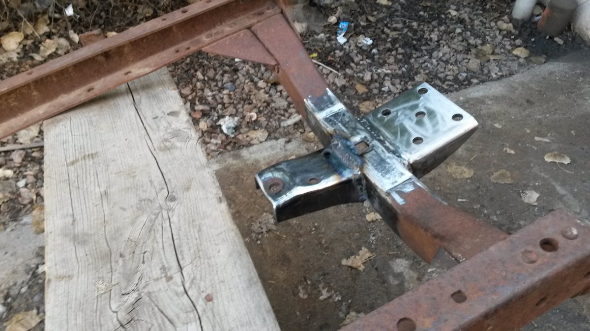

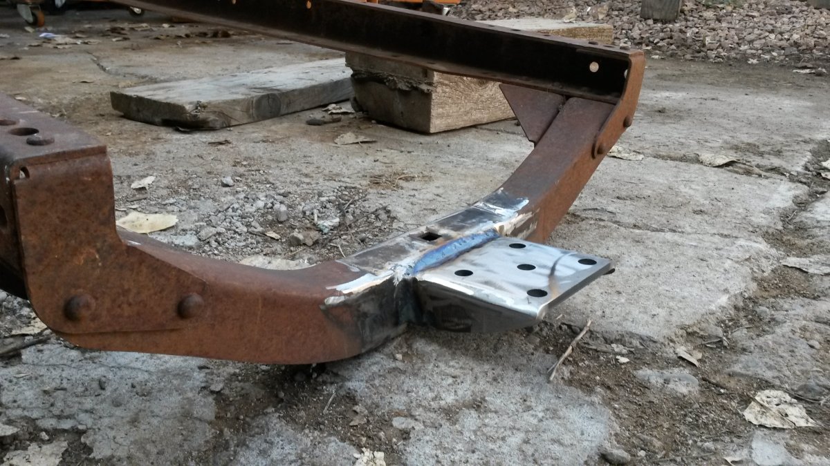

  4. I made the front motor mount from the end of a 1926/27 T rear crossmember. It just needs to hold the front yoke motor mount of the Model A engine. 20161010_164248.jpg 20161010_155300.jpg
    patmanta and bct like this.
  5. Just an observation -- You're putting a lot of twisting stress on that flimsy T crossmember. I've been restoring Model T's for more than 15 years, and most of the front crossmembers I see have cracks in them. And those cracks occurred without the added stresses of hanging the spring out front and extra horsepower. I don't see any cracks in yours, so that's a good thing. But I'd suggest reinforcing it somehow, perhaps by "boxing" the bottom of it to resist the twisting forces you're putting on it. And you probably already know this, but those frame rails will need to be beefed up some as well.

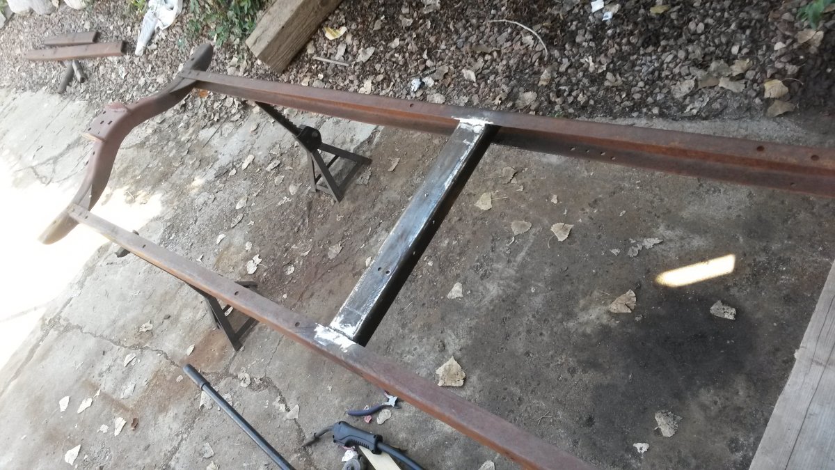

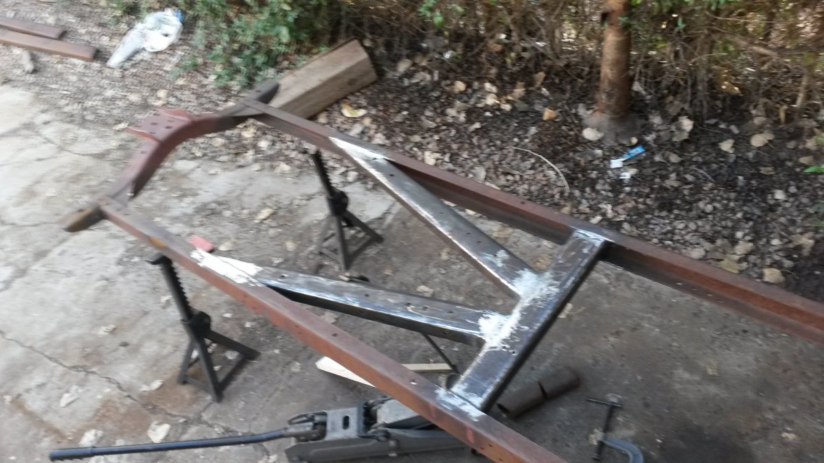

  6. 20161011_144331.jpg 20161011_160315.jpg Now on to the center crossmember. I used some of the straight pieces of my extra '26/27 rails to make this.

  7. Yes I welded in some reinforcement on the bottom on the front crossmember.

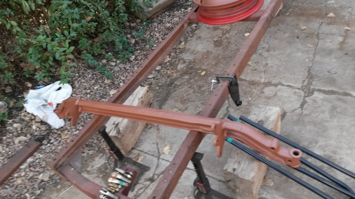

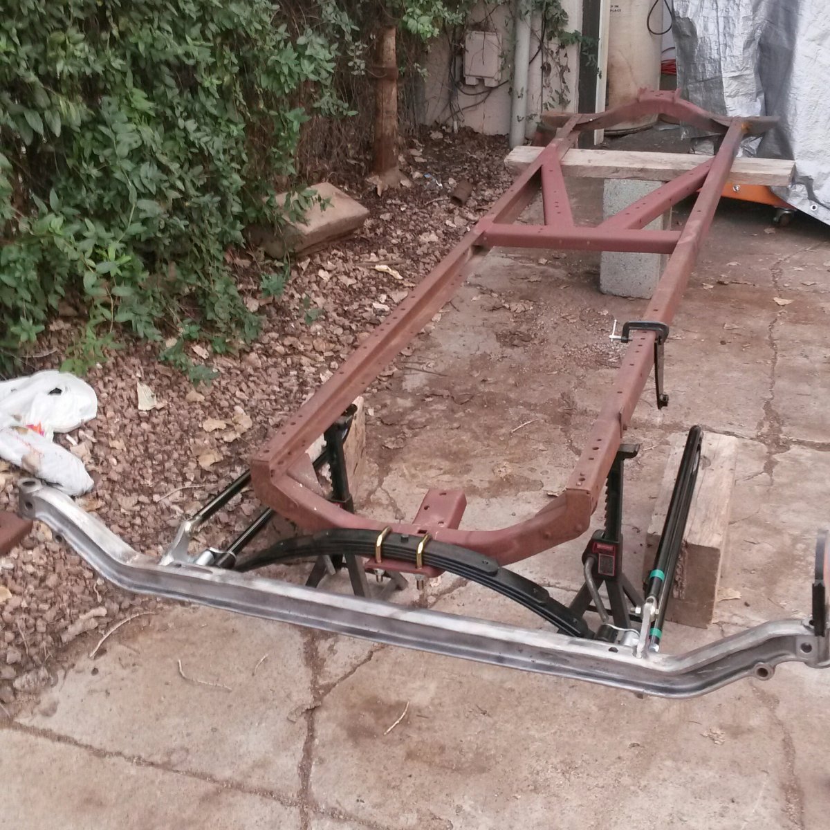

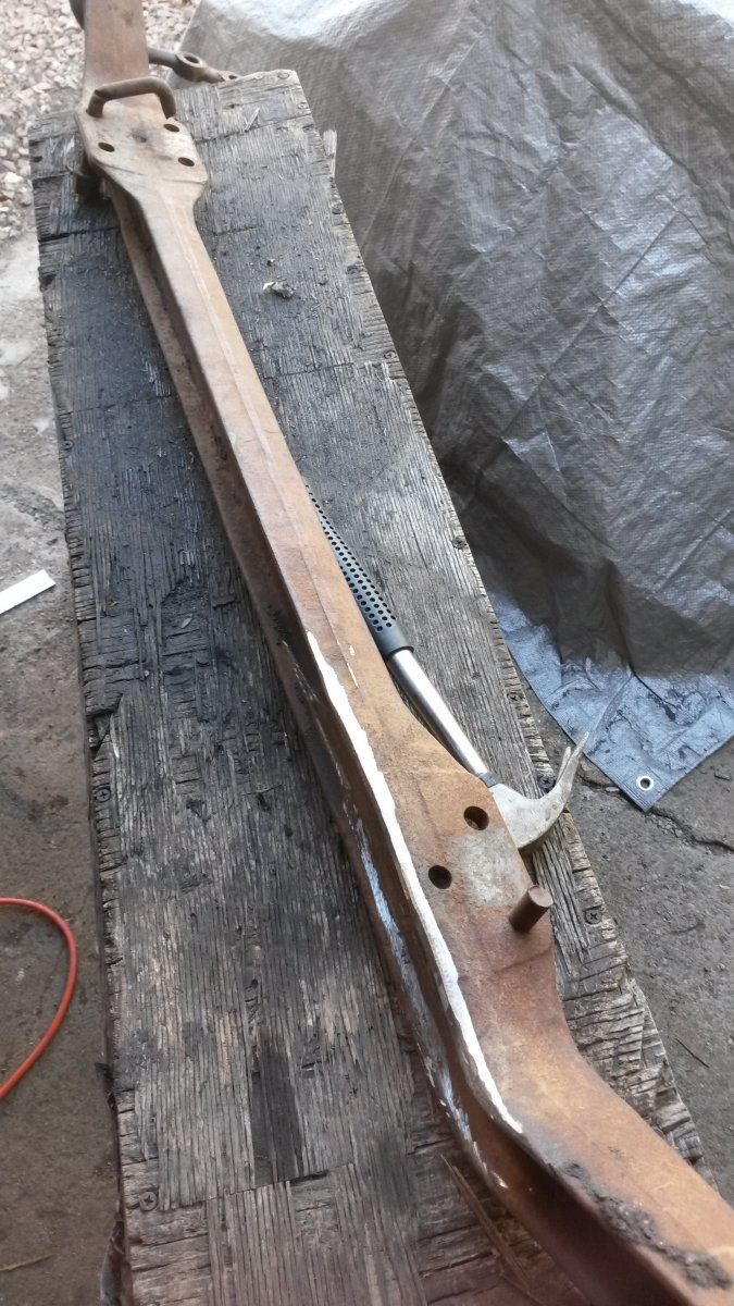

  10. For the front axle I had to use what I had which was a '48 F1. I ground off the dual spring flanges and used some weld on spring/hair pin axle brackets I had on the shelf. Yall are probably going to say "that'll look like ****!" & "That axle is too wide!" It's actually the same width as the '48 p***enger car axle I used on my last build. 20160917_155104.jpg 20160924_190128.jpg

  11. 20161003_181358.jpg 20161003_181408.jpg Ok here's where I had to spend some money. Hair pins and spring from Speedway all mocked up.
    46international and bct like this.

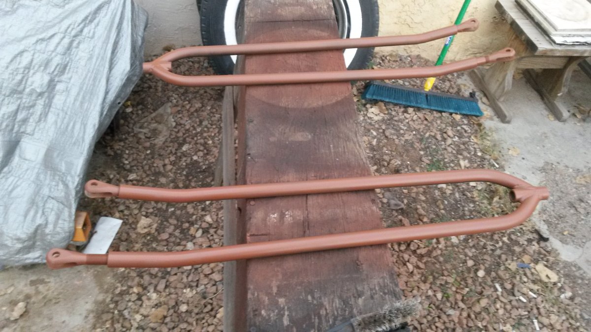

  12. Looking like I hoped. Next the spindles, brakes, wheels & tires. Then I can get to the rear end. Yes I know the hair pins need to be bent in a couple inches to reach the frame. That's on my weekend to do list. 20161012_181433-1.jpg

    I am putting together something similar. My cross member was straight across, not dropped, and when I had the whole thing mocked up. It was very apparent that the frame sat too high in front. I had to re-do the perch with a 3" drop to get things to look right. From the looks of the hairpins and mounts, it looks like you may have the same problem. I really don't know the final "look" you are trying for; this is just something to be aware of. I don't know how you are planning "bend" the hairpins, but I can't think of a way to do it that wouldn't look a bit odd.

  14. I just plan on heating them about 3" from where they attach to the axle brackets and just bending them slightly in a vise so they stay even. Shouldn't look terrible (I hope).

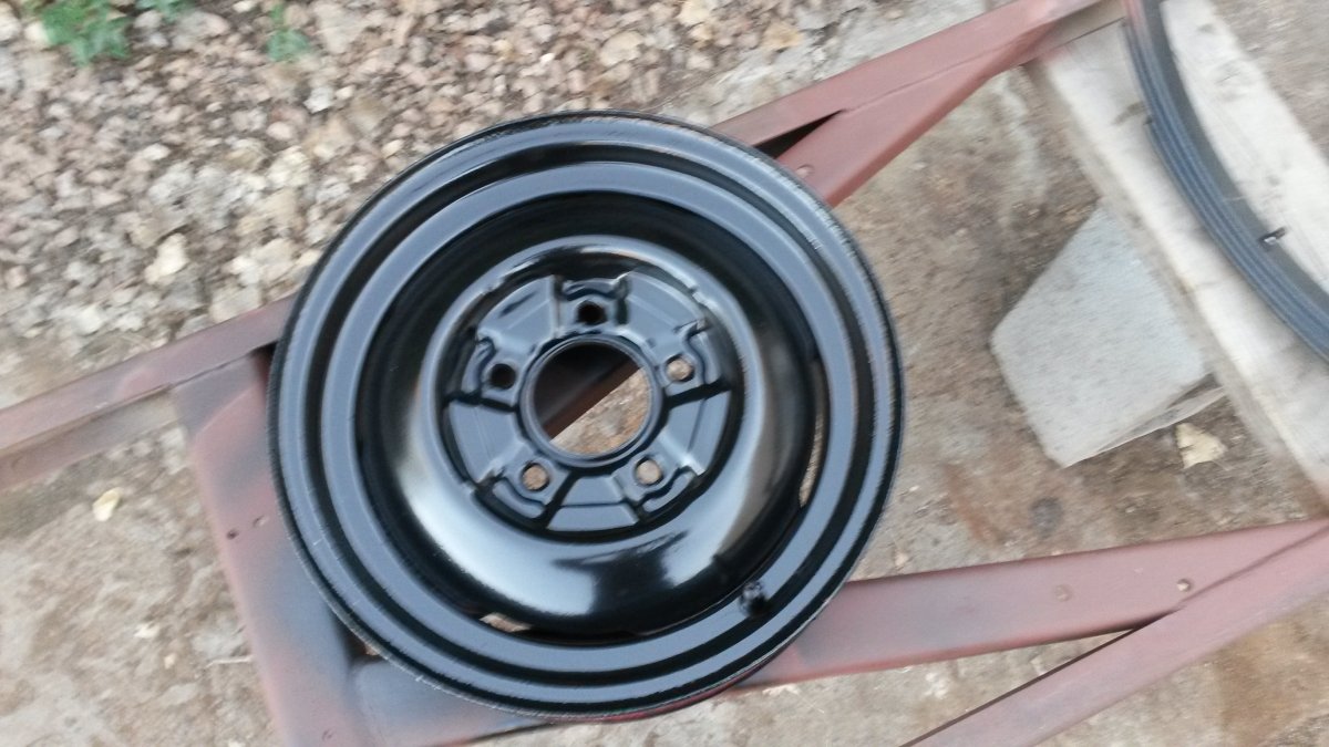

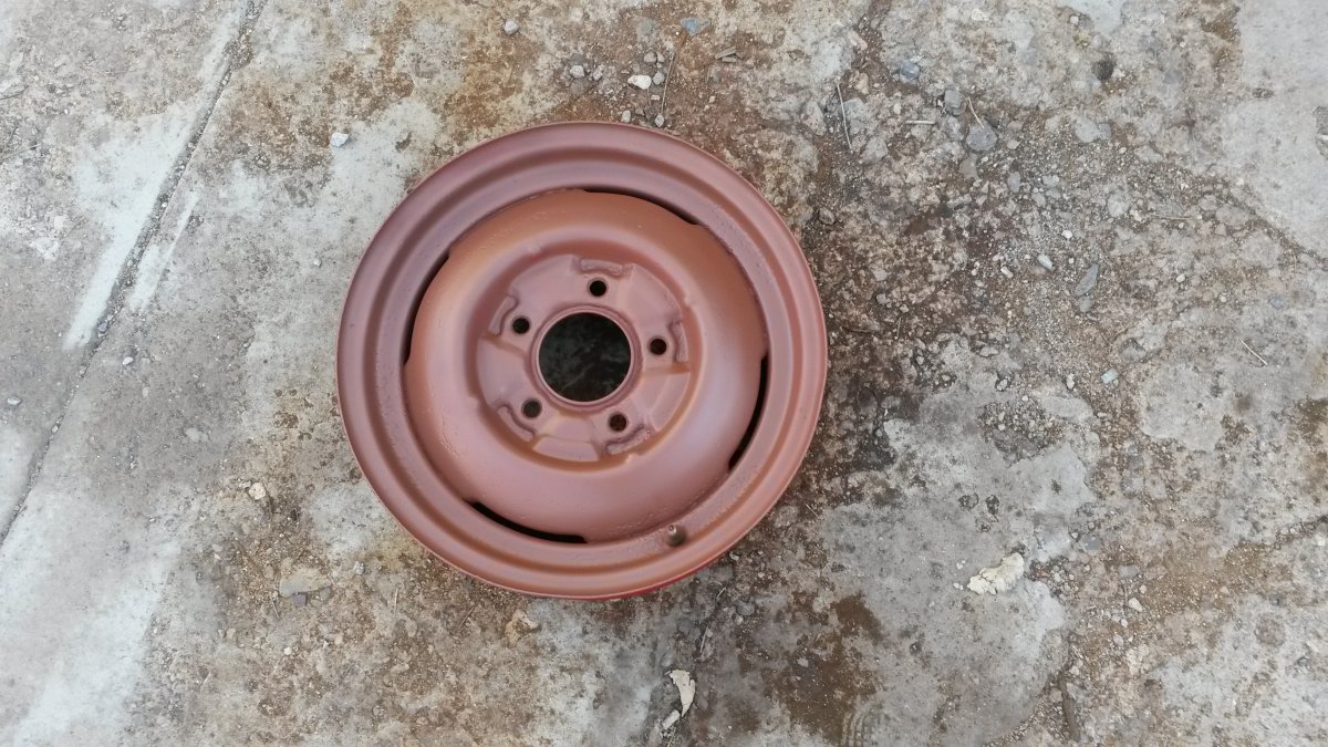

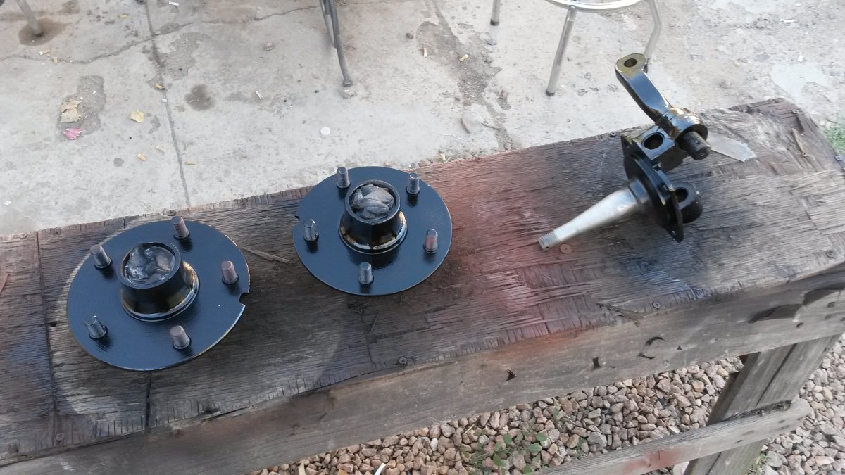

  15. Getting some primer and paint on a couple parts. Wheels are '40 Ford 16's all the way around. Firestone 6.00-16 front & 7.50-16 on the rear. Front brakes are '48-52 F1 thanks to fellow HAMBer Rich B. 20161018_172102.jpg

  16. As far as ride hight, I'm not trying to make it super low but lower than stock for sure. I may have to put a spacer between the front spring and the mount to get it lower if looks too high without it.

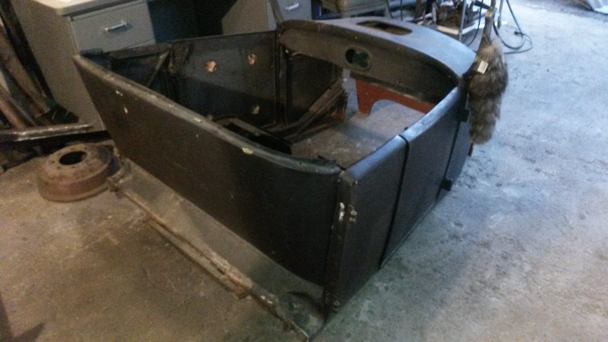

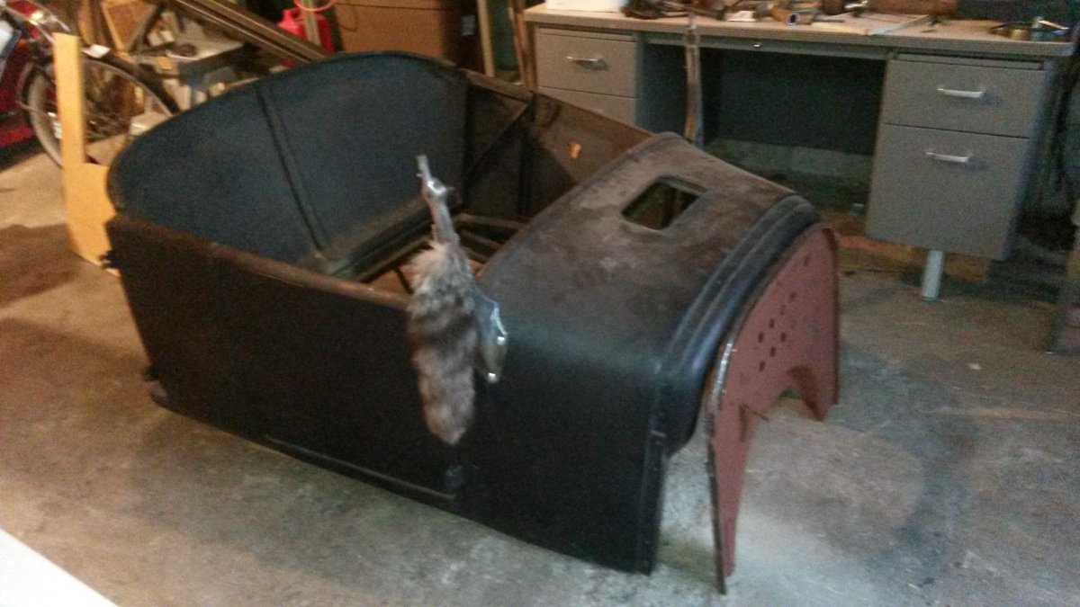

  18. Chopped windshield posts. Check! 20160324_185100.jpg 20160926_181654.jpg

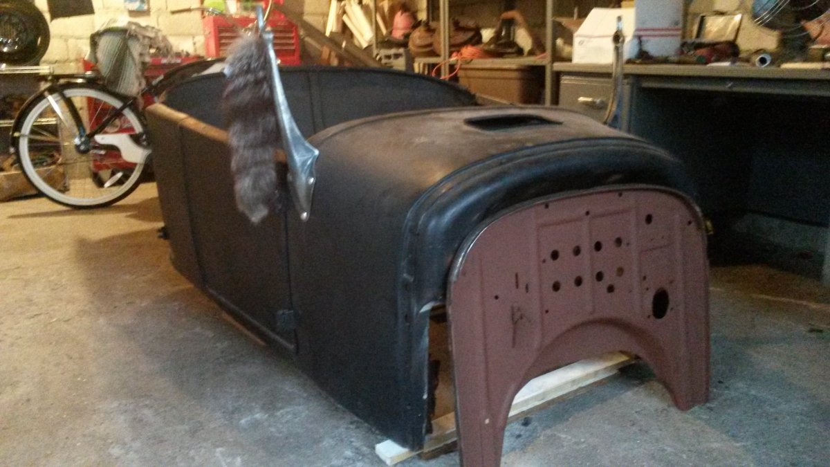

  19. The body had an ugly recessed firewall done in the 70's using a wheel barrel. I started cutting it out and am replacing it with a '25 firewall I had in a corner of the garage. 20160926_181249.jpg 20160926_181300.jpg

  20. A lil paint before the tires get mounted. I LUV single stage tractor paint! 20161020_181242.jpg 20161020_181234.jpg

    Looks good so far. I think that firewall is a '25. I had a 26/27 cut-down touring body that used that same firewall, was split in the middle to make it wider and welded in, it looked right at home in there. If I can find a good picture of it I'll post it.

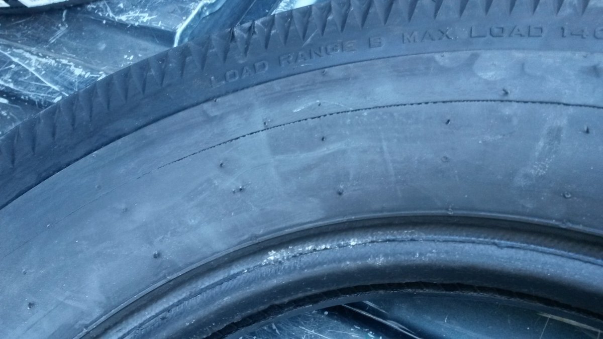

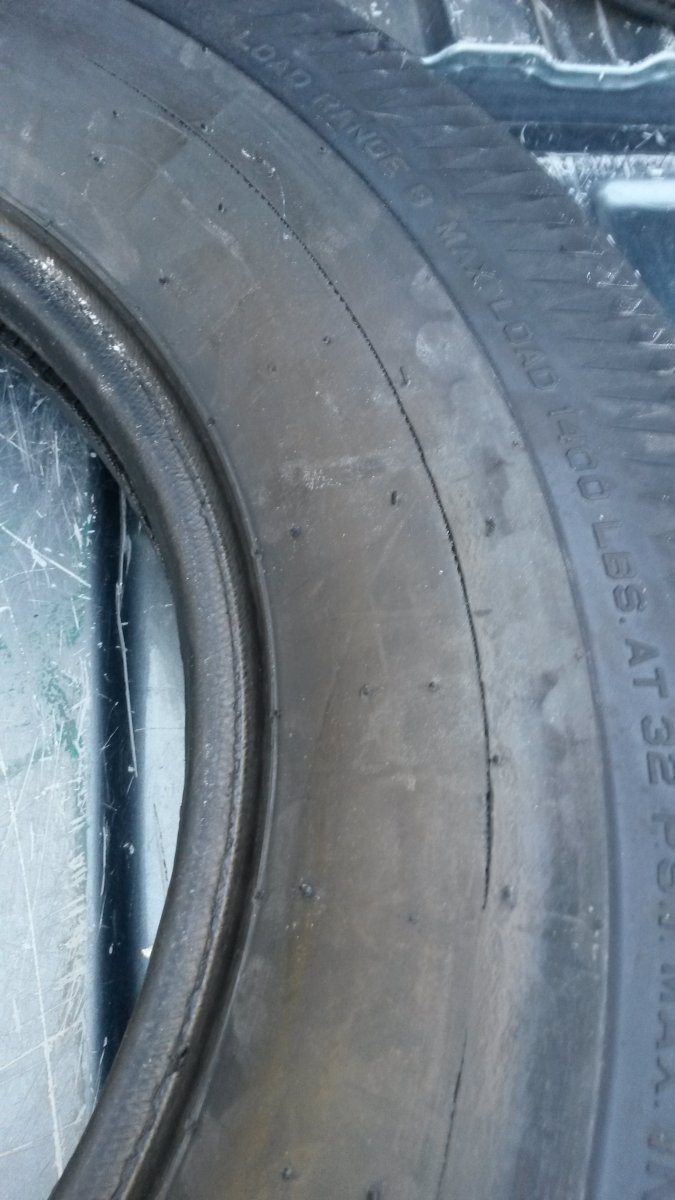

  27. So I had planned on having my front tires mounted tonight but as I was unraveling the plastic wrapping from one of them I noticed a cut on the sidewall. So I sent it back to Summit for a return/exchange this morning. 20161020_175538.jpg 20161020_175546.jpg Guess I'll only be mounting one tonight.
  28. Today's progress is I finished bending and priming the hair pins and it doesn't look too bad! I also reattached the front axle in preparation for installing the spindles and new king pins tomorrow. The hair pins will get painted and reinstalled tomorrow as well. 20161021_182620.jpg 20161021_182628.jpg 20161021_182610.jpg
