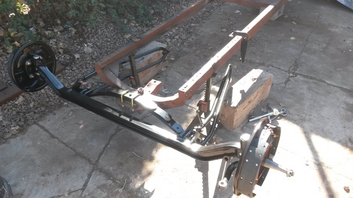

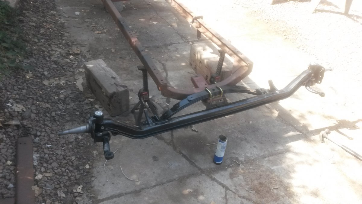

  2. Spindles and new king pins went on this morning along with the brakes. 20161022_123826.jpg 20161022_140826.jpg

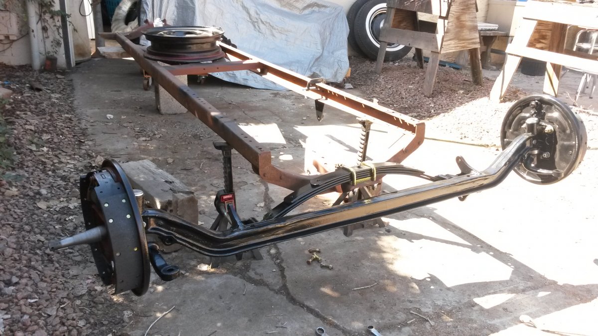

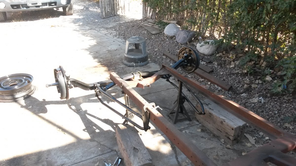

  5. I reinstalled the "modified" hair pins and am very happy with the way they turned out. They'll be mounted inboard the frame for a nice clean look. 20161023_144942.jpg 20161023_150755.jpg
    alanp561, dana barlow and bct like this.
  6. I'll ***ume your going to leave the ch***is end of the Hair Pins just clamped to the frame rails until loaded ride height is found.
    The Wizzard
  7. Yes that's the plan.

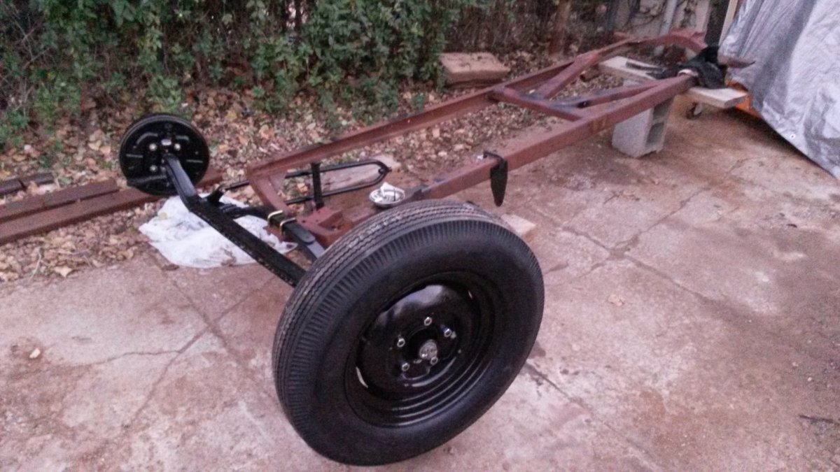

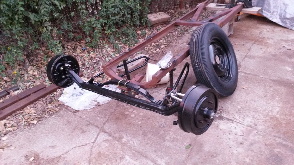

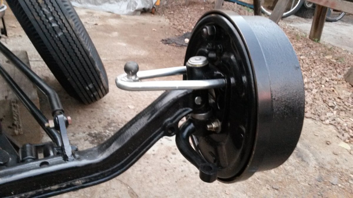

  11. So I've been held up waiting on parts for the last couple of weeks and the steering hoop I got from Speedway needed the threads rechaised but I finally got all of that sorted out. I welded on my steering ball to the hoop and big *** truck brakes are on for the last time. Still waiting on Summit for my other front tire but I expect it this week along with the new tie rod. That should ****on up the front end for the most part until I get to the steering. Now I have to move to the rear end. I couldn't resist installing one of the wheels to get a visual. 20161107_171420.jpg 20161107_171433.jpg 20161107_172120.jpg 20161107_172134.jpg

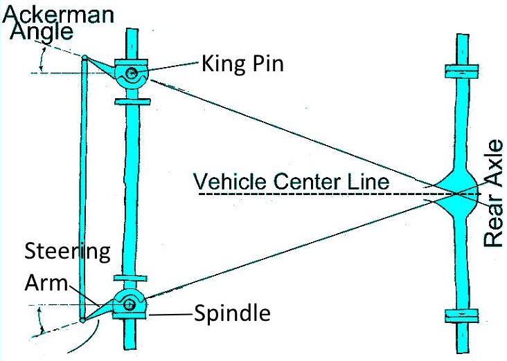

    Great so far,I like it ! By the way, fix your spindel arms out tell they contact the brake backing plates,heat/bend} even if you need to indent or cut away a little of lip of backing plate to make your tierod as long as you can get it working safer with tierod out front like that. Fixs the Ackerman to at lest close enough to work some for you.
  14. Thanks. I'll look into that this weekend.

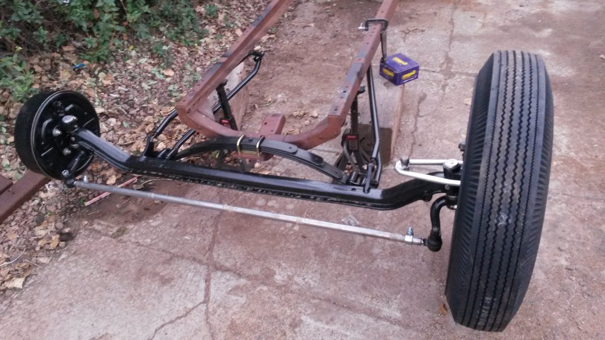

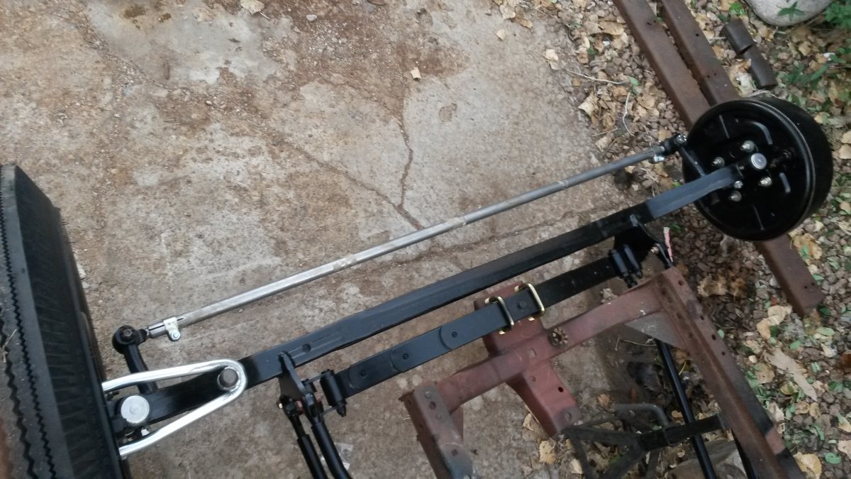

  17. Got the tie rod in the mail today so I wasted no time slapping it on after work. 20161108_171252.jpg 20161108_165946.jpg

    Cool project for sure. I`ve never been in a car with a front tie rod setup like yours however a couple of ch***is books I`ve read mention the below setup. ackerman-bending-steering-arms-reversed.jpg

  20. Thanks it wasn't my first choice but due to financial constraints I had to use what I had with a lil backyard ingenuity. I'm happy how it turned out.

    just a thought. why didn't you just mount the radius rod bracket at an angle and bend the spring mount straight so you didn't have to bend them?
  24. I didn't want the spring to bind. I actually like the way the hair pins turned out though.
