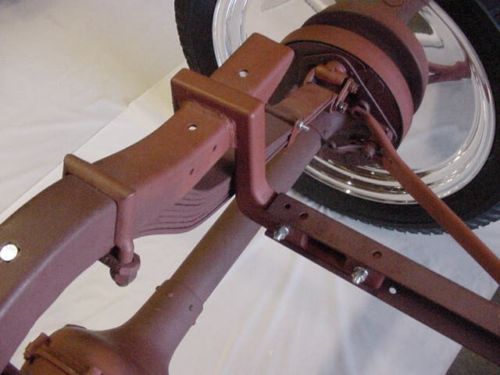

  2. FB_IMG_1483553189266.jpg Almost EXACTLY what I'm building except for the Model A frame. Hmmmmm upgrade???

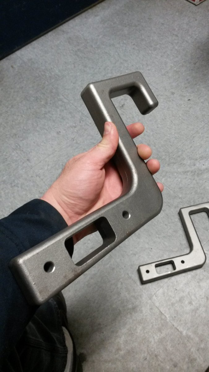

  10. 20170209_085328.jpg I got rear frame lowering brackets today. Super high quality heavy cast pieces! Can't wait to get them on! 20170209_085338.jpg

    Does it come with any instructions for welding or say that it's forged Steel? Just curious.
    Felipe Toltecatl likes this.
  12. It came with installation directions but no instructions for welding. It's only supposed to be welded at the rear crossmember and bolted to the frame rails. I'll add a pic of the instuctions today.

    Those are definitely cast
  15. My thoughts exactly.

    Thats what i was wondering, you might consider brazing them onto the crossmember or read up on pre and post heating if you are going to weld them as the cast will have a tendency to crack along the weld if it cools too rapidly.

    LOOKS LIKE THEY OFFER A SERVICE TO WELD IT TOGETHER ON ANOTHER AUCTION.
    LOOKS BOLTED TO THE FRAME AND WELDED( OR BRAZED ) TO THE CROSSMEMBER

    The seller describes the parts as steel casting; should be no problem welding them.

    Cast steel didn't even cross my mind, but makes perfect sense. Carry on....
