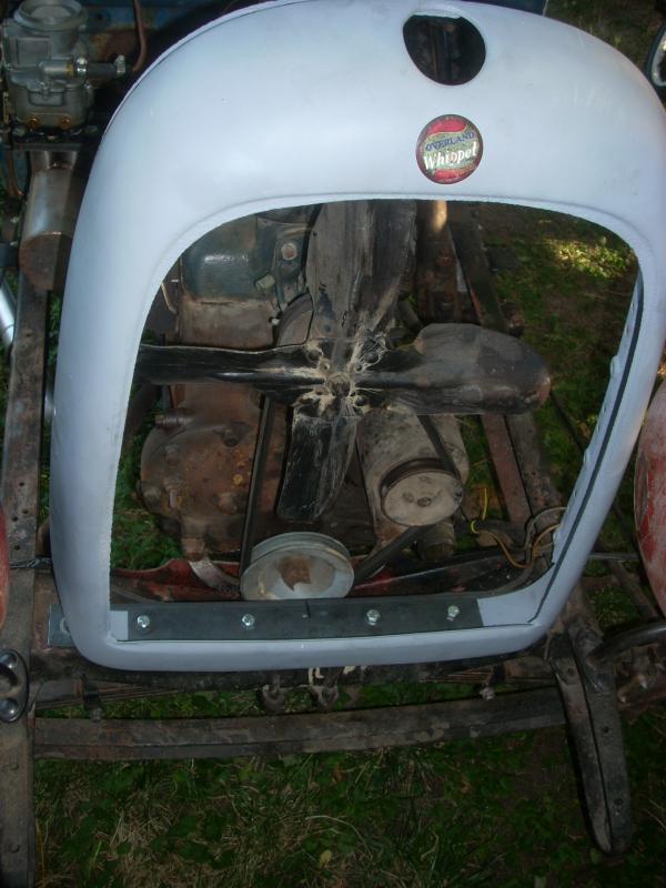

  22. I haven't figured out the fan issue yet. I may run a V8 water pump (that will really dictate fan placement). As far as a grill shell I was going to ask my buddy Fast Eddie in Albuquerque to make me a custom Whippet style shell just for my application. In the mean time I'll run with no shell if and when I get to race it on the beach.
