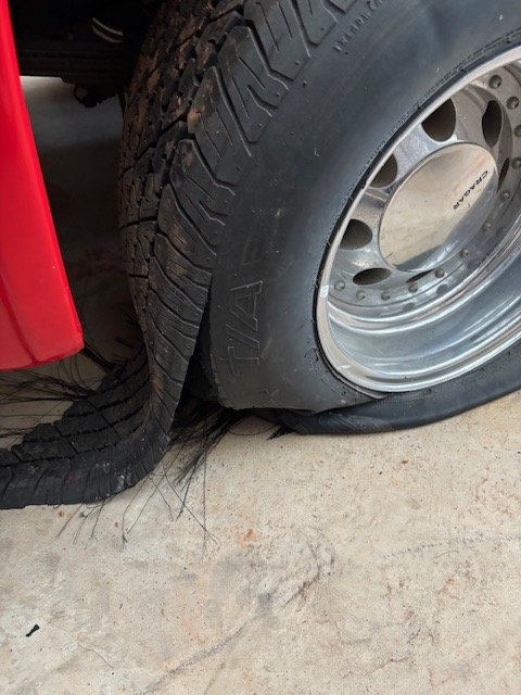

    IMG_5061.jpeg This was on the 56 I bought. They were good and round when I parked it there. Guess it’s kinda like ran when parked.
    The tread has RUNNOFT.

    looks like an old tire with plenty of tread but, no life left
  4. See that a lot
    Cars sit and radials deteriorate and pop
    Tire probably committed suicide cause of the wheel :)

    Radials last 6 years before the rubber loses its ability to hang on to the steel belts. At which point the steel belts cut through the rubber and the tires fail. I am moving this to the off topic forum because of the modern wheel

    We see lots of trailer tires like that. Good tread, but the tire life is just plain timed out.

    I had one do that laying on it's side in the garage. They get to be that old, you don't even want air pressure in them.

    I've come to expect that from the old tires used as rollers. Just a matter of Time, esp since most sit on sand or the ground anyways. Even sitting on wood, brick, or concrete doesn't seem to slow it down all that much. & the newer the tire, the faster it happens. Although old trailer tires do last longer. PITA, but at least get some more use outta them before throwaway.
