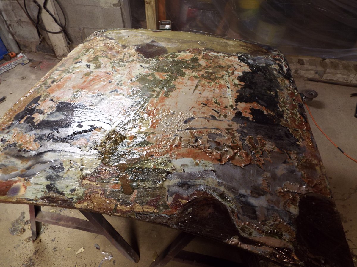

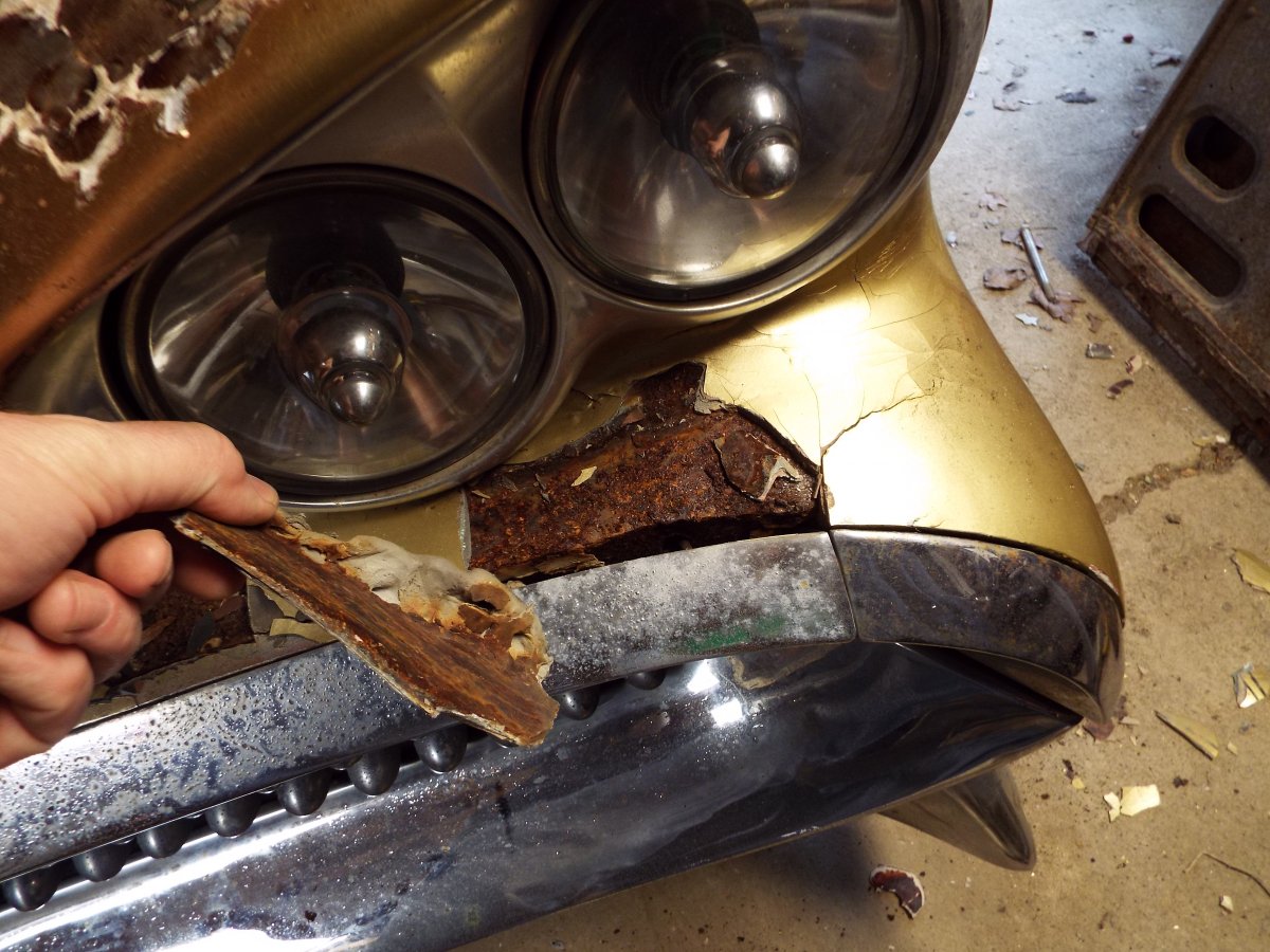

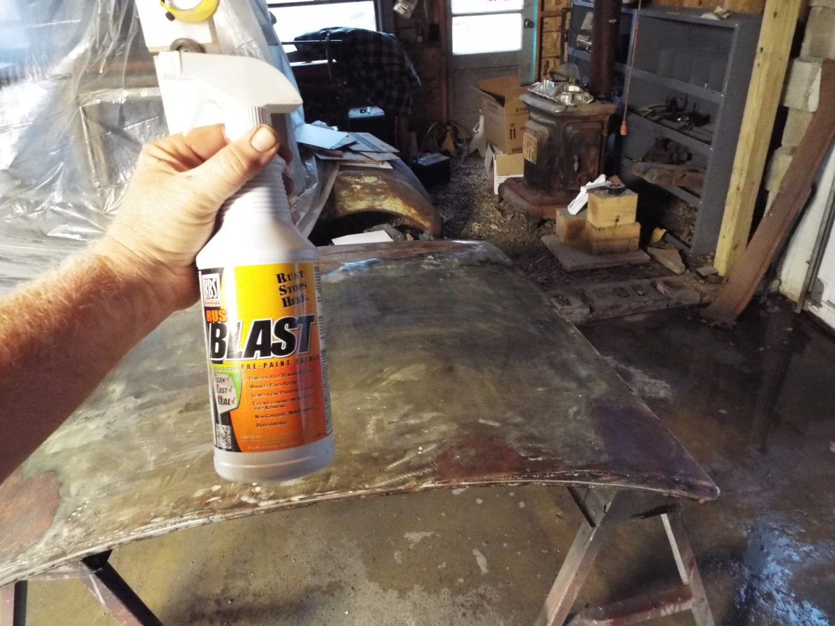

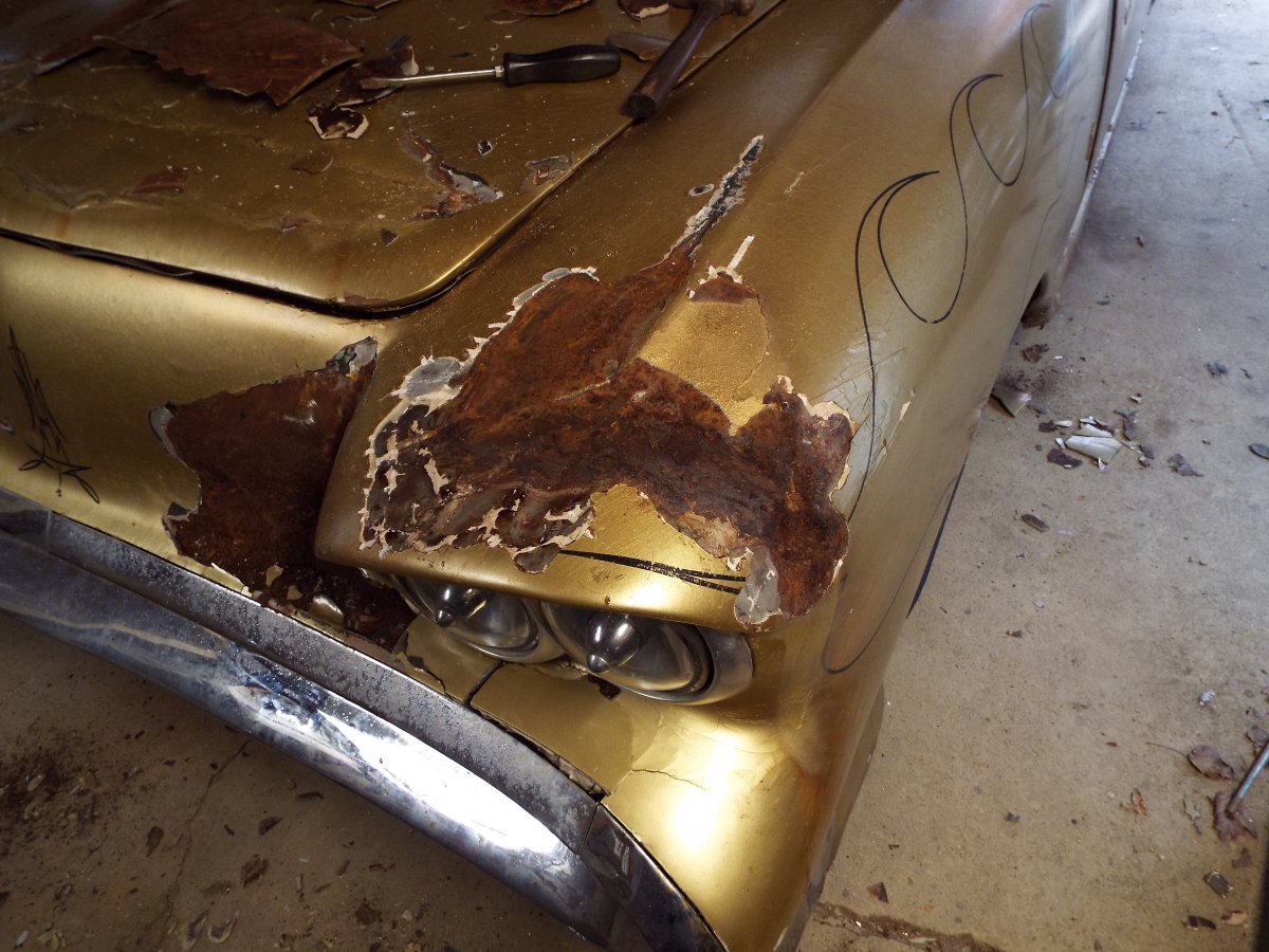

    Sorry for no updates but I have been busy in the shop and not much free time. We started removing the gold paint. Forget sanding the lacquer just gums up the paper. I don't want to blast it. To messy and just not my thing. Next was to move on to the stripper. It's doing the job. What we could chip out we did.

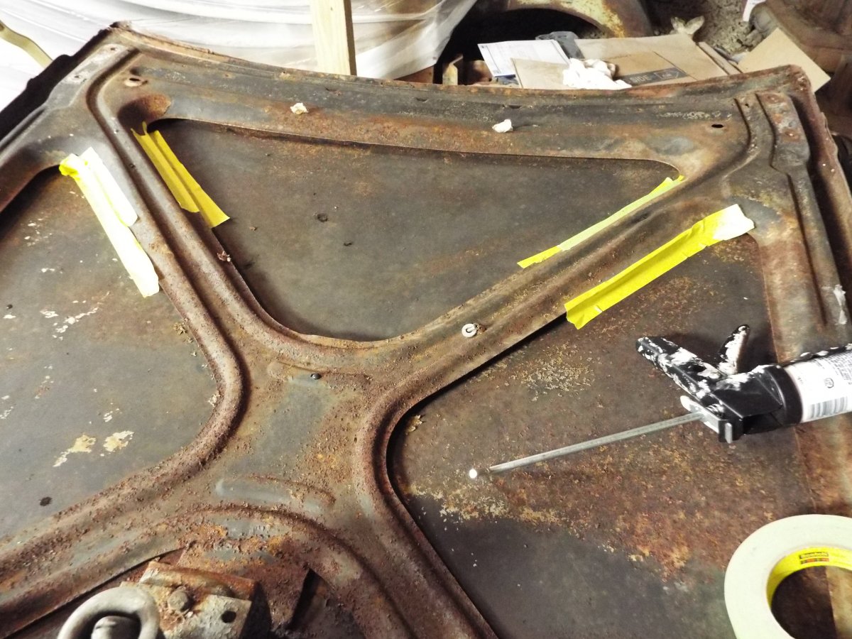

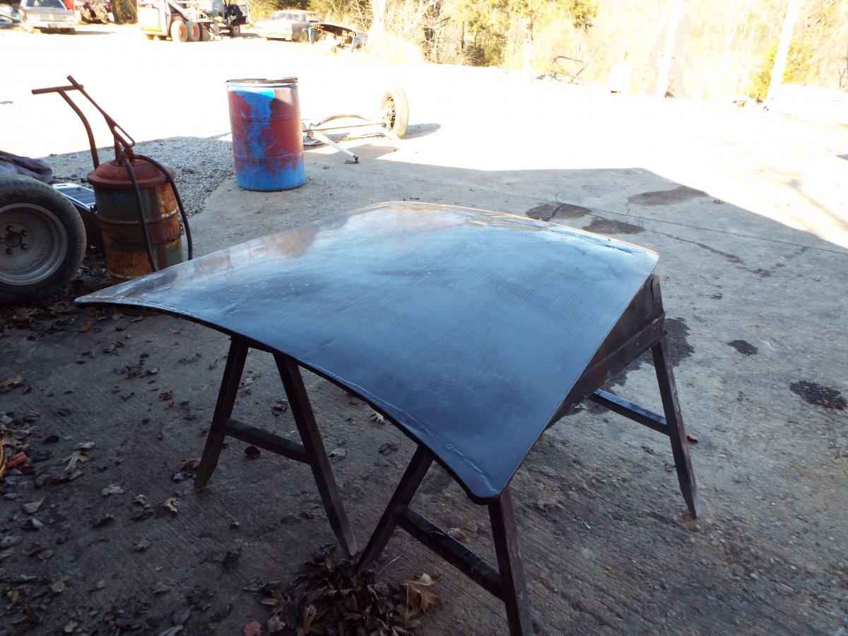

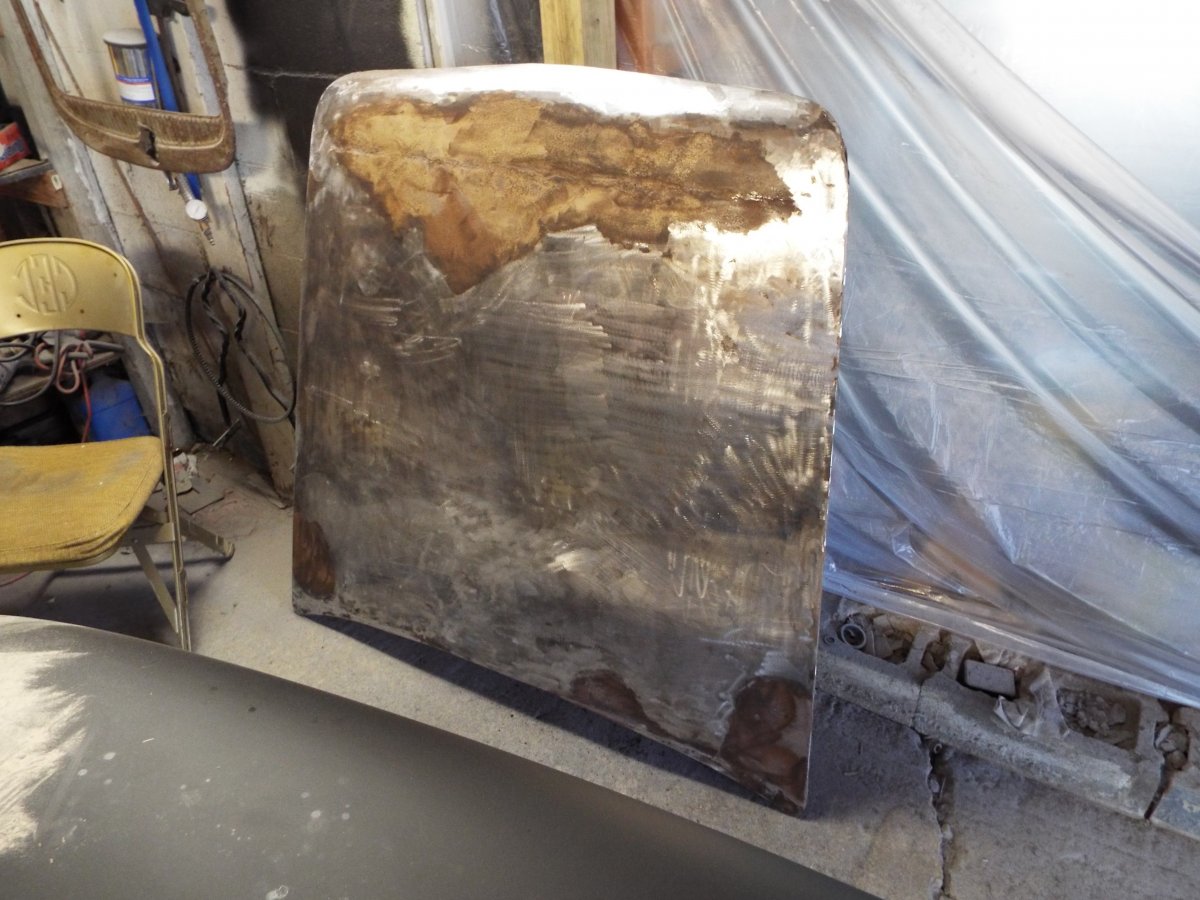

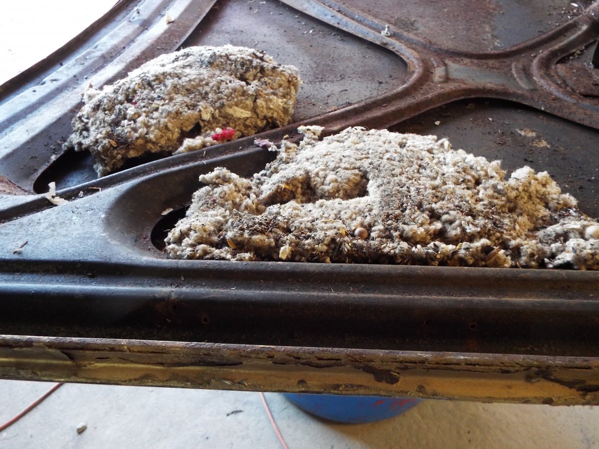

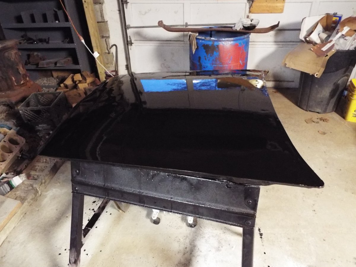

    The hood was stripped, some hammer and dolly work, cleaned, etched, sealed and then a some good brand plastic filler was used in the dents and big dings. Being followed by a glaze and blocked before any primer goes on for blocking. The hood was flimsy and oil canning. Some dolly work helped but the bracing under the skin wasn't close to the skin. I drilled a couple holes in the braces and shot some black caulking into the holes to mate the skin and bracing together. It worked out very well. DSCF4919.JPG DSCF4950.JPG DSCF4955.JPG DSCF4962.JPG DSCF4971.JPG DSCF5029.JPG DSCF5054.JPG DSCF5096.JPG DSCF5178.JPG DSCF5370.JPG DSCF5395.JPG

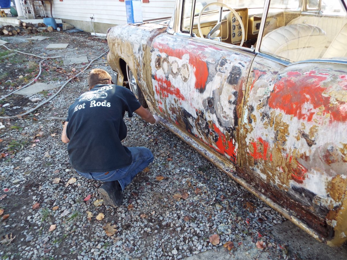

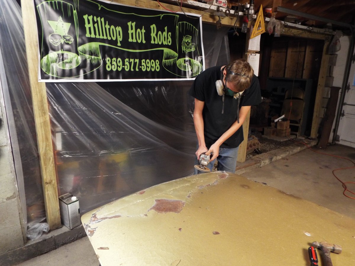

    My 16 year old son is on stripping duty. He's been helping and watching. This is the next generation of gearheads.
