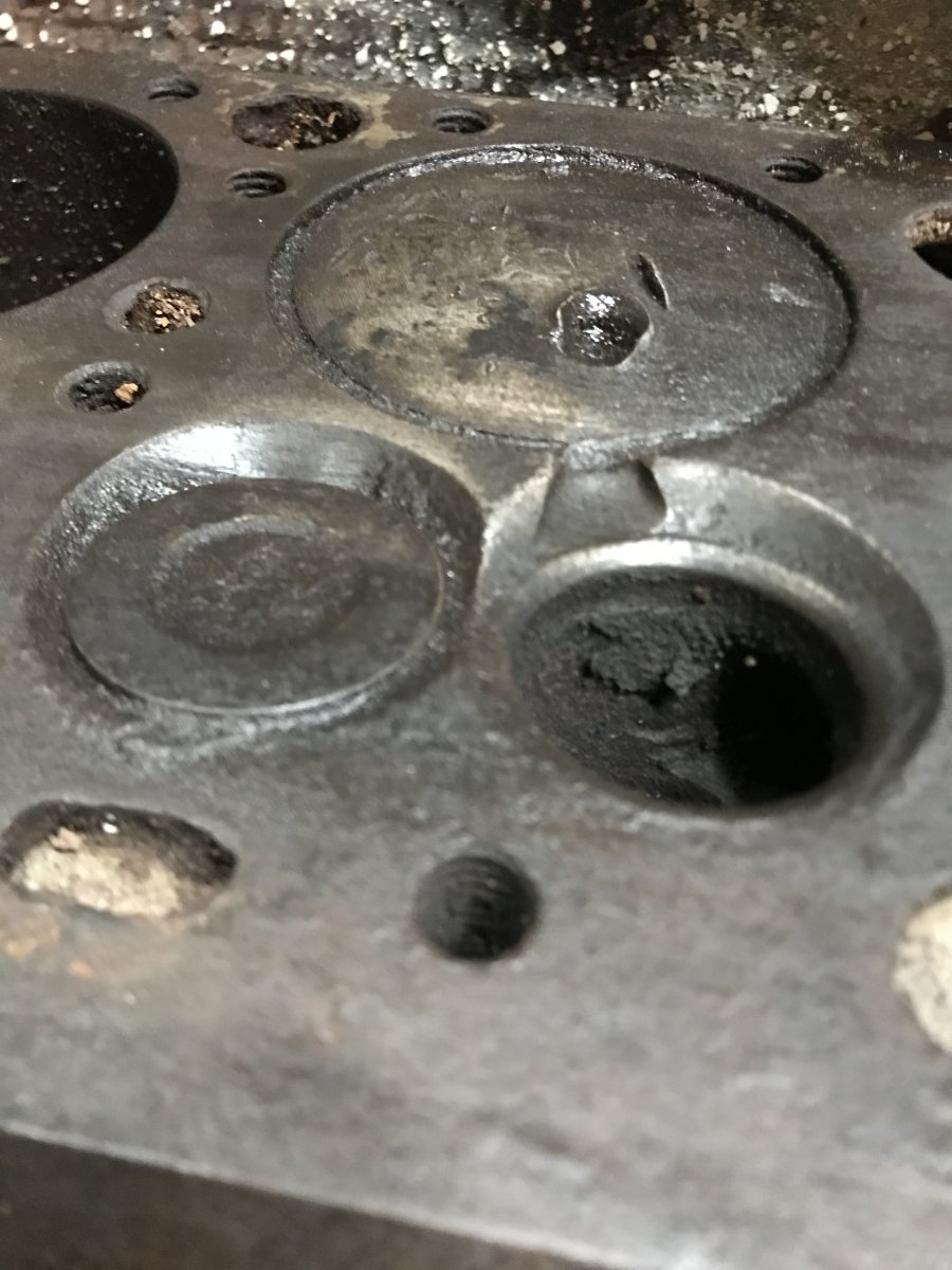

    Ok this just got stranger- 35938D7A-0831-4138-84CD-2BBA125F0618.jpeg pulled heads- no valve or spring/retainer in this hole. The lifter is still there. How could that damage happen to the deck? The piston would go up, and not much higher (if any) than this...
    It's a hell of a dent too!

    Jeez Louise! What does the head look like over that cylinder?
    You know, I bet if you magnaflux that thing, it's cracked to hell and back.

    • The dent is from a UFO (unidentified foreign object), most likely part of the missing valve. The missing valve is ****tered on some long forgotten road, and the spring and retainer are in the oil drain pan. What does the bottom of the head look like?
    The channel is caused by hot combustion g***es burning through the deck because of a burned valve.
    There should be additional damage to the block near the damaged portion of the crankshaft in the first picture. Something was loose in the bottom end, and the rotating crank simply machined itself away.
    Hard to tell without additional pictures, though.

    I think Finn may have hit it pretty close, Foreign object damage in the cylinder and either someone pulled he head and then pulled the valve and spring or the engine digested them Then the engine was run until it quit or got pulled and replaced.

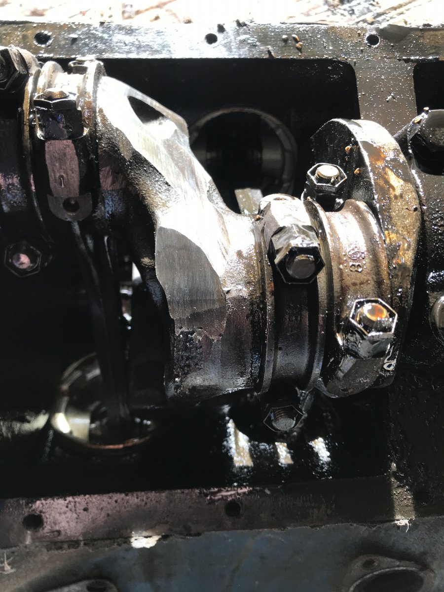

    There was nothing in the pan, so I would say the valve etc.was removed. (Why the lifter remained is a ???) The head was pounded pretty good. The grinding on the crank was def. intentional, the stamp puzzles me, unless someone did it as a joke when they stuck the motor together. It looks like a fairly low mileage rebuild, no ridge at all, new-looking fiber cam gear (with three different bolts) pretty fresh 9.5" clutch etc...

    Also,,,the indentation in the deck didn’t look like a fire slot,,,Did it ?
    With a broken valve head loose,,there should be no compression,,,so no fire in that cylinder,,,right ?
    Maybe I overlooked something ?
    The indentation looks kind of wedge shaped,,,could the engine have ingested a piece of metal of some kind ?
    If a bolt of some kind got down in there,,,maybe it would cause marks like that ?
    Tommy

    I'd say that the channel was cut on purpose. What purpose? You tell me. Definitely looks like a broken valve hit the piston top,but only once? I had a piston that looked like it was shot by a shotgun from all the dents. This is getting odder by the day

    I don't know flatheads, that's for sure. Is that the exhaust valve that's missing? Was the notch put there to allow the piston to move with no compression?
  17. Jet96
    Joined: Dec 24, 2012
    Posts: 1,431
    Jet96
    from WY
    Yes, exhaust valve. The notch is hard to describe. It looks like it was ground in and then smoothed up. The metal isn't displaced like a hard hit would do.

    I'd think when the valve let go, it may have bounced around and possibly made a crack or a dent that looked like a crack. The owner ground that area down till there was no more crack. And could it be possible the owner ground off part of the crank weight to compensate for the vibration the dead hole made? Just spit ballin it here. Anybody else notice #5 rod is in #1 cylinder? Hell, I think they're all mixed up but if all the odd number rods are all on one side I
    suppose it doesn't matter...still it messes with my OCD.

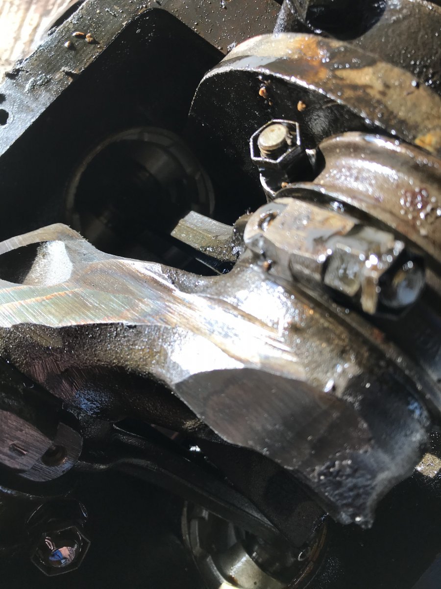

    Been looking at the crank pictures for a while and can’t figure out what process could cut like that.The ridges are sharp and the striations are arrow straight plus one area is concave.
    Would a crankshaft be so valuable during initial manufacture that they would waste time/ money machining off blems?
    Definitely a mystery and hope that the truth comes out..... that stamp really puts a cat a**** the pigeons.
    Jet96 and lothiandon1940 like this.

    Not really that straight, the more you look the more you can see the concaved shaping in all the ground out sections. Plus the heat bluing is pretty apparent too. Most likely a grinder.
    ****shot theory, there was a crack in the crank on the back of the throw and they just ground it down til it was gone, then tried to make it pretty.

  22. Sorry Rocky,
    That is the #5 rod in the #5 cylinder,,,this is a Ford,,,5,6,7,8 are all on the drivers side bank.
    And the more I look at it,,,the more I believe that grinding was done at Ford.
    That stamp font just looks factory to me,,,maybe I’m wrong?
    Tommy

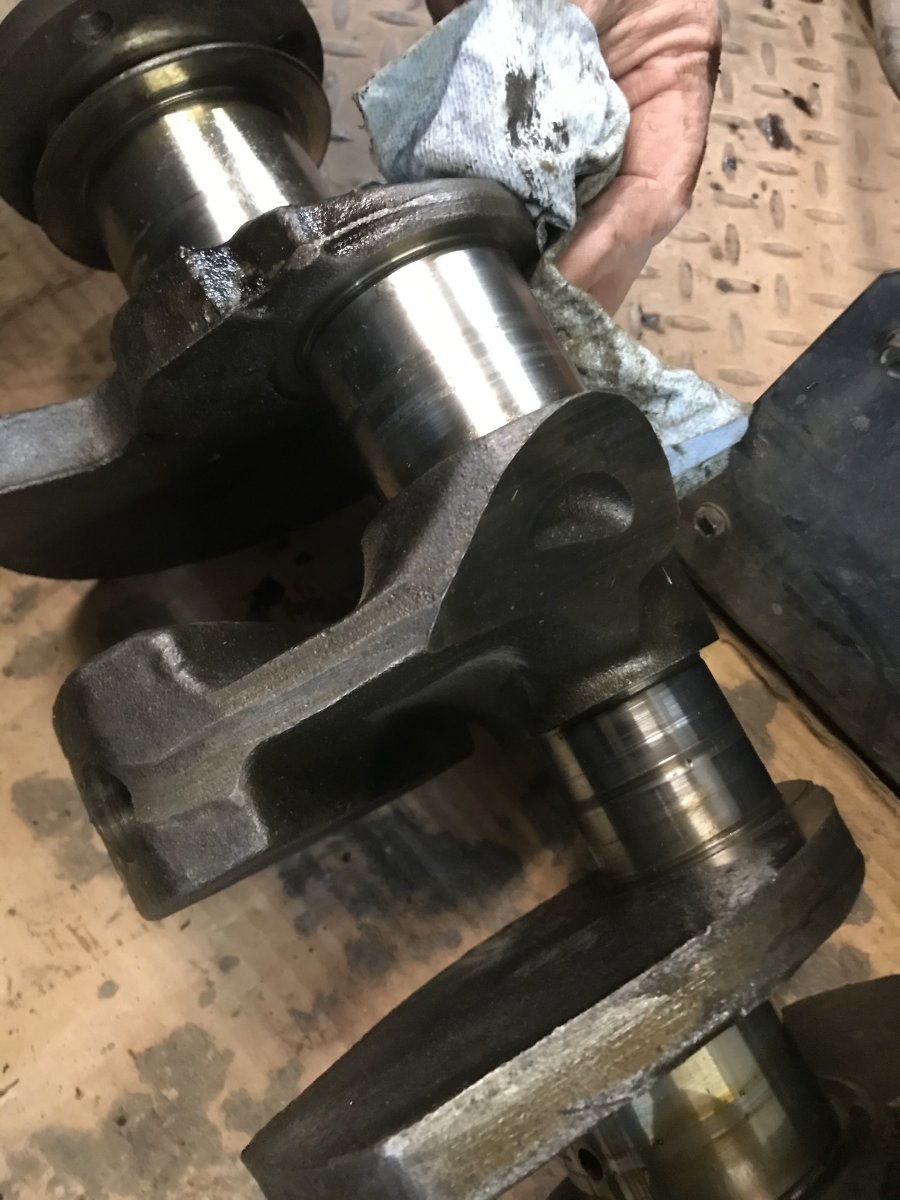

    Johnnielson-it's just a standard ford crank. I can find absolutely nothing else done to this crank. It does look for all the world like someone was trying their hand at lightening that throw and maybe got tired of messing with it haha
    I just can't get a clear pic of the stamp. It really looks more like an elongated donut instead of a circle with an "o" in it.

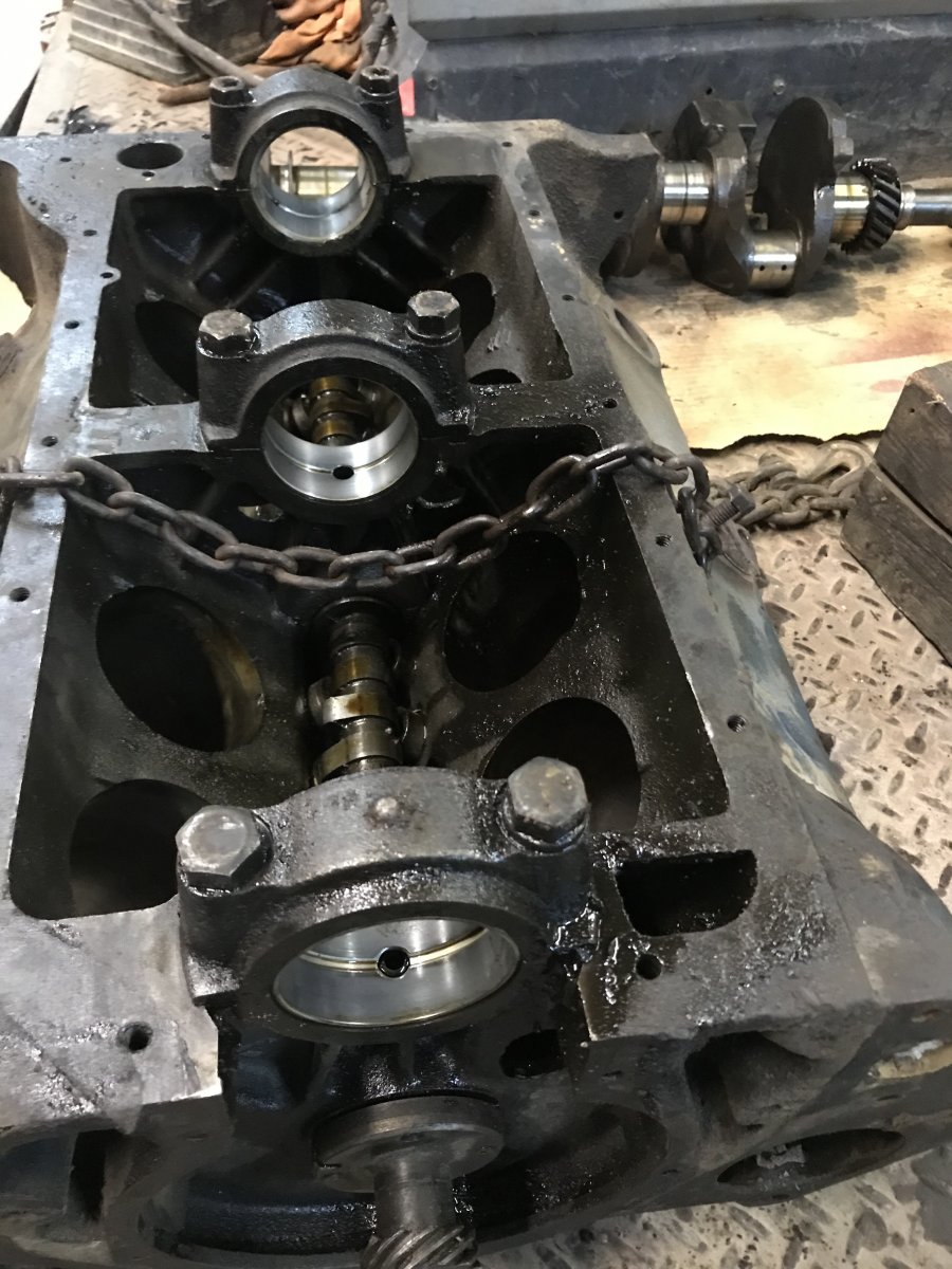

    Ok-Got this thing torn apart and waddaya know, the rear throw is ground off also. Not near as drastic as up front but still... CBF7210D-6D97-4728-8E61-37DA8E0160A0.jpeg

    The rod journals are a slightly grooved but the mains are near perfect. With pistons out the crank spun easily. If you look closely, lock washers on right side only. Old racer trick... 0E281495-CCCF-4565-B476-9EEAF294A070.jpeg

    What do the lock washers on one side do?
