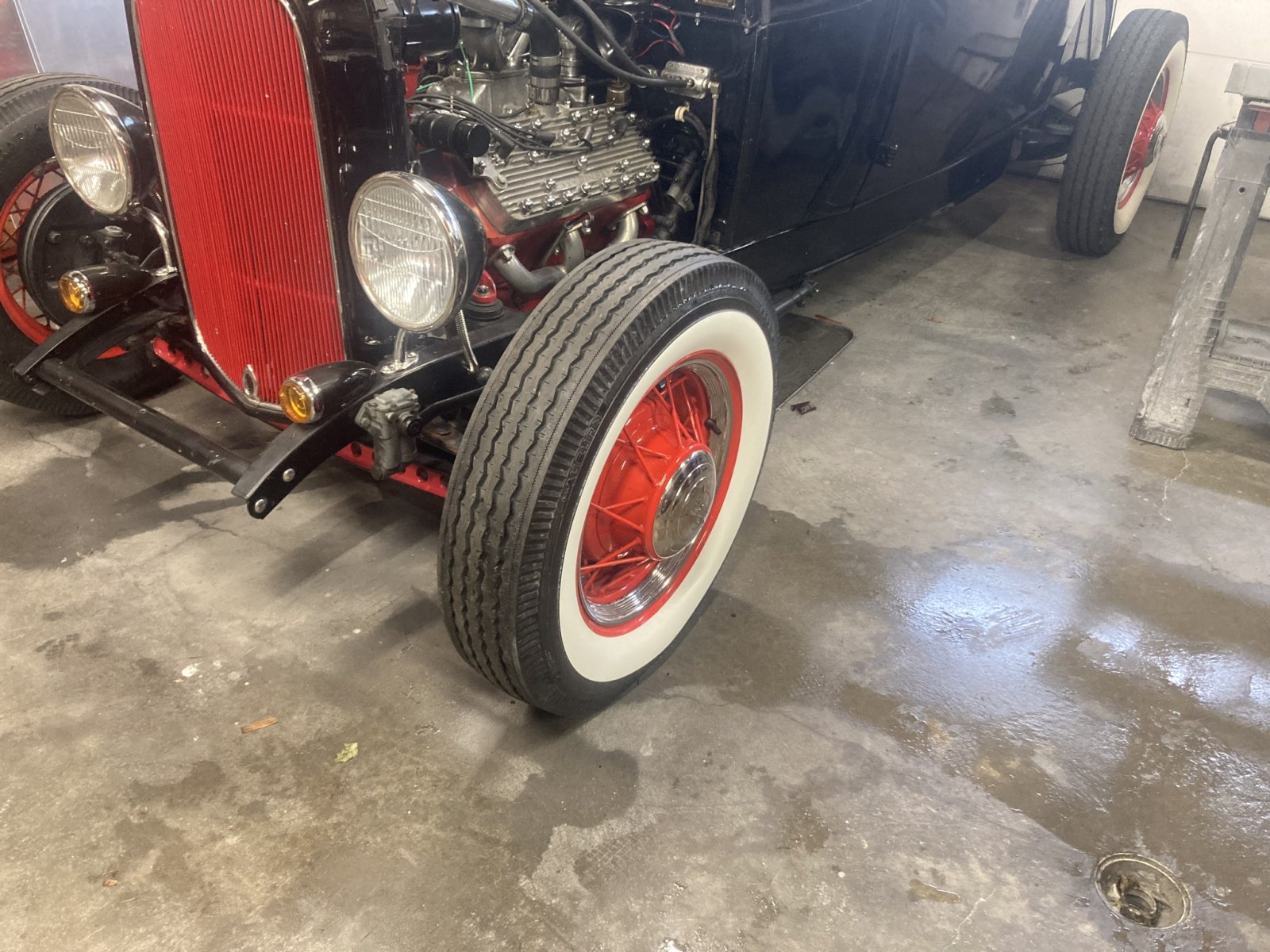

    What tire are you running?
  19. CSPIDY
    Joined: Nov 15, 2020
    Posts: 1,284
    CSPIDY
    Front tires are 6.00 R16 Diamond Back Auburn Deluxe
    Rears are 7.00 R16 Cokers
