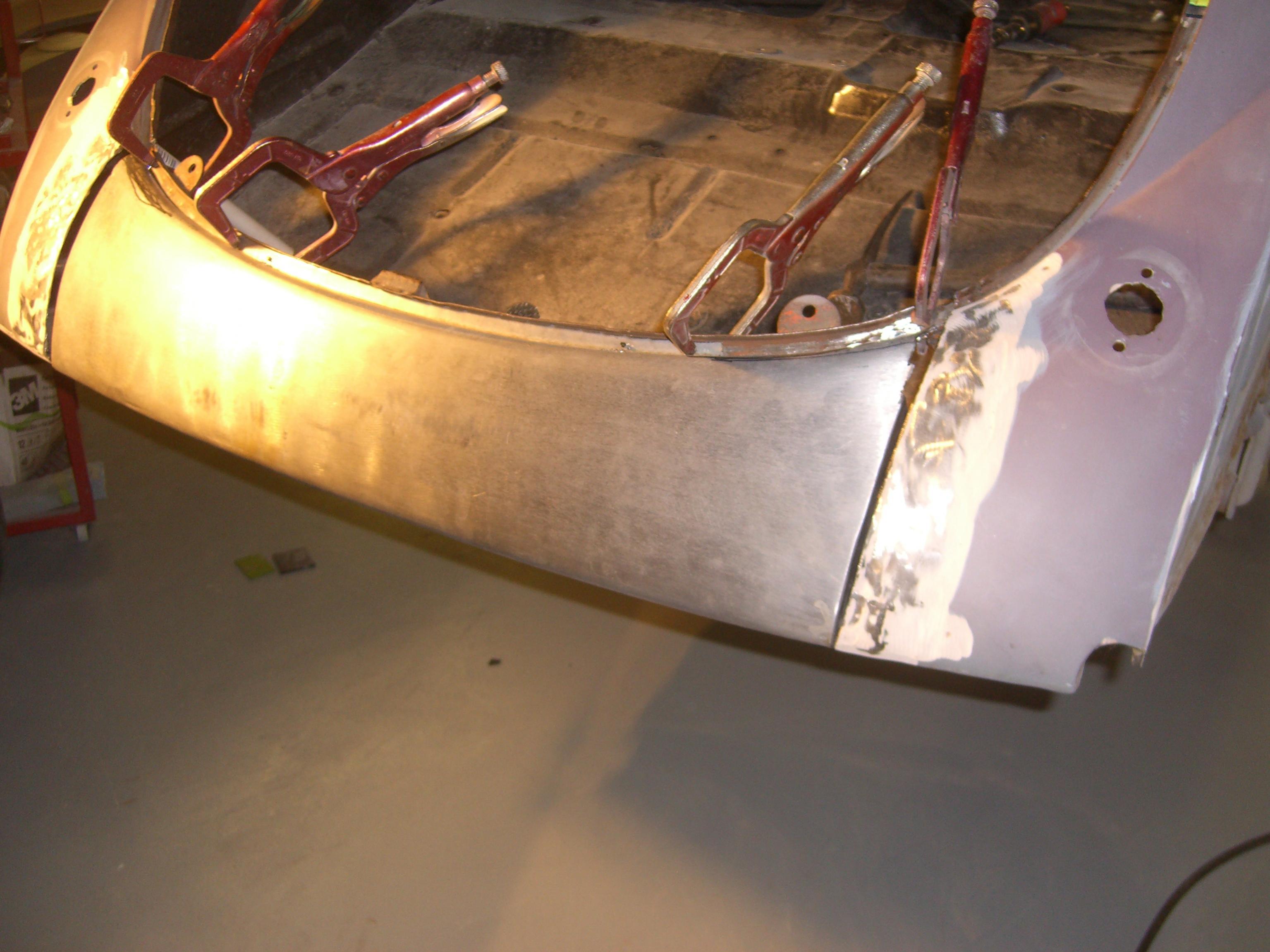

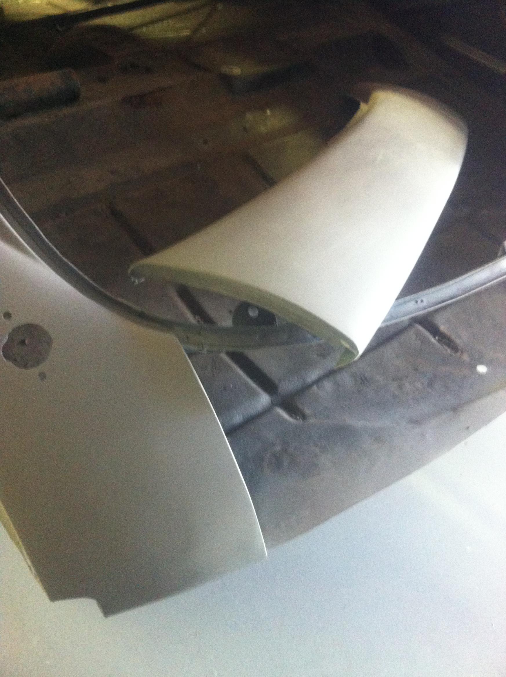

    Thank you for the web site. I did order a new tail pan, It looks great and fits perfect.
  2. hotrod--willys
    Joined: Dec 15, 2009
    Posts: 531
    hotrod--willys

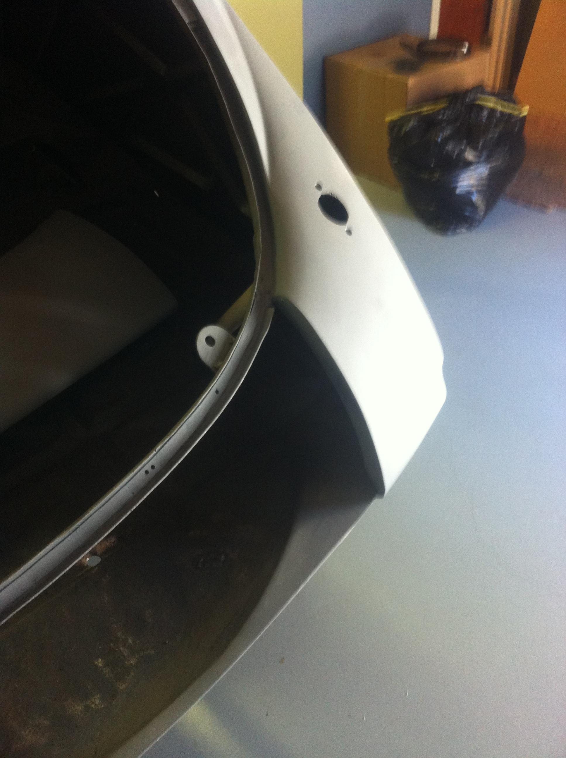

    I have now installed the inter seams and have done a temp. fit. Looks good. Now for some sand and fill primer. New tail section fits perfect. I will glue this tail panel in.:D

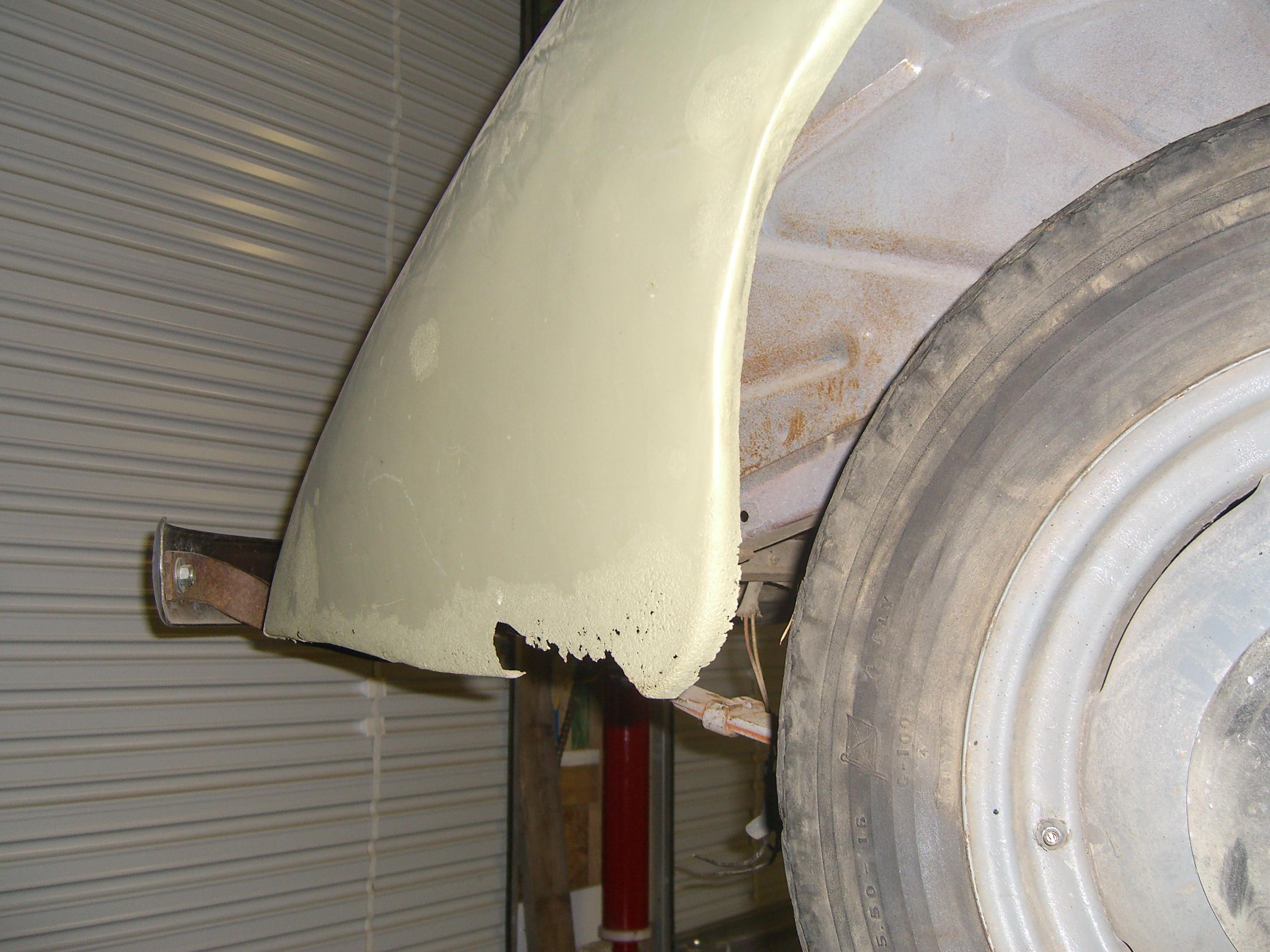

  4. hotrod--willys
    Posts: 531
    hotrod--willys
    At some point some one wanted the nice rear fenders off this car. So the bolted on these. The fenders are sound but the bottoms are gone. So I will make a new bottom, and we will have a nice right rear fender.:)

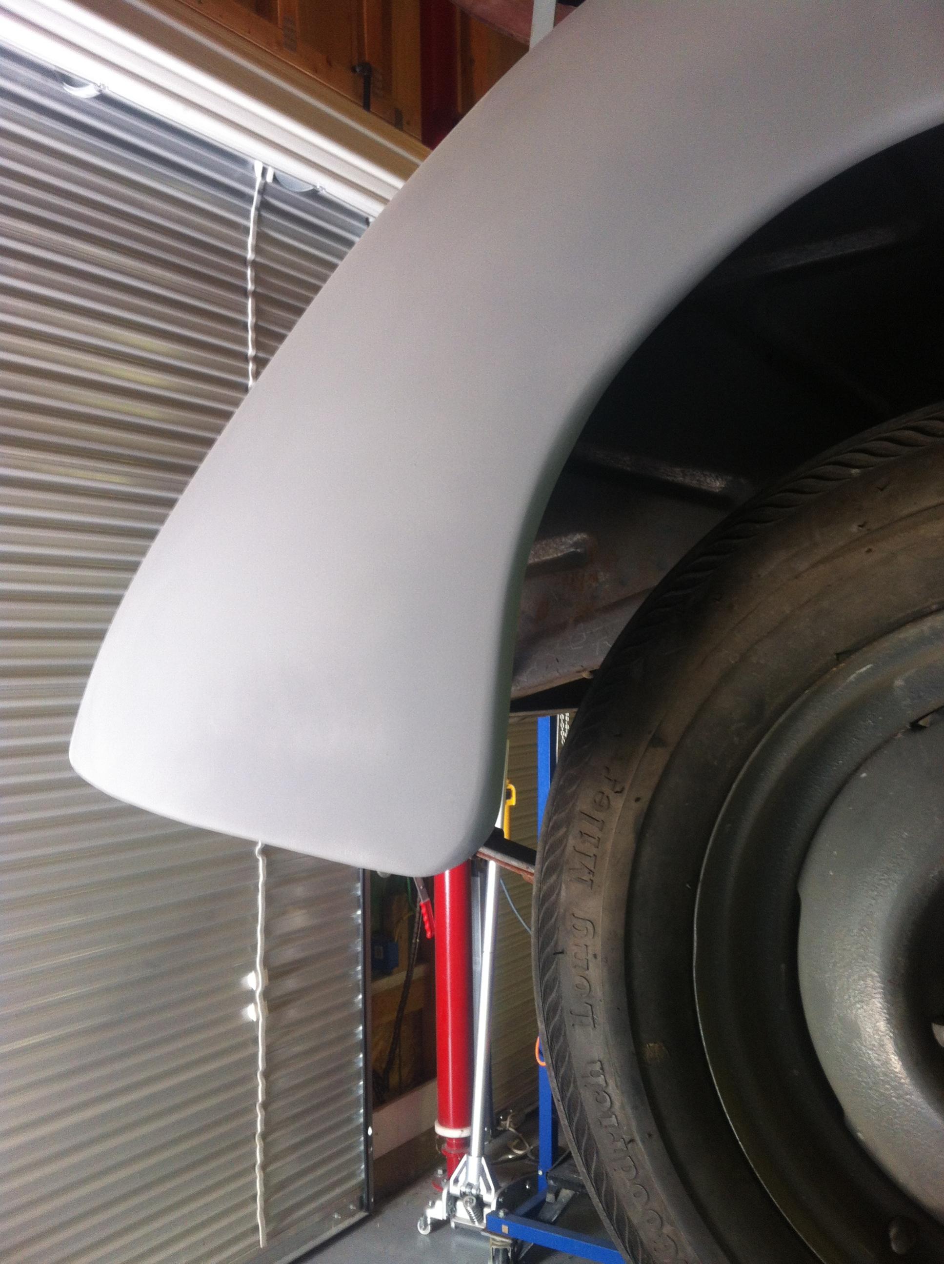

  6. hotrod--willys
    Posts: 531
    hotrod--willys

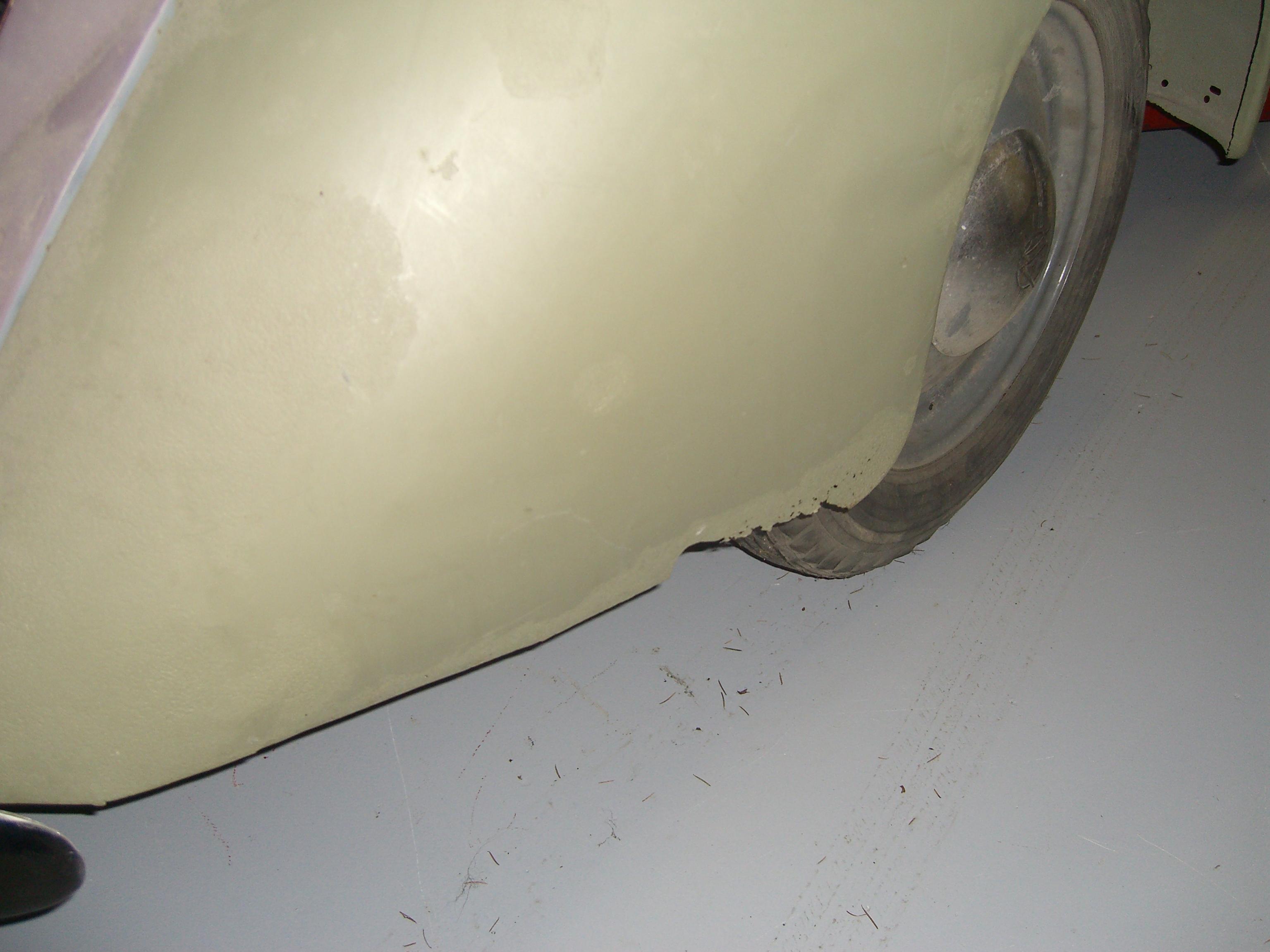

    OK. This is the right rear fender with new lower section replaced. It's in sand and fill primer. next project FIRE WALL:eek:

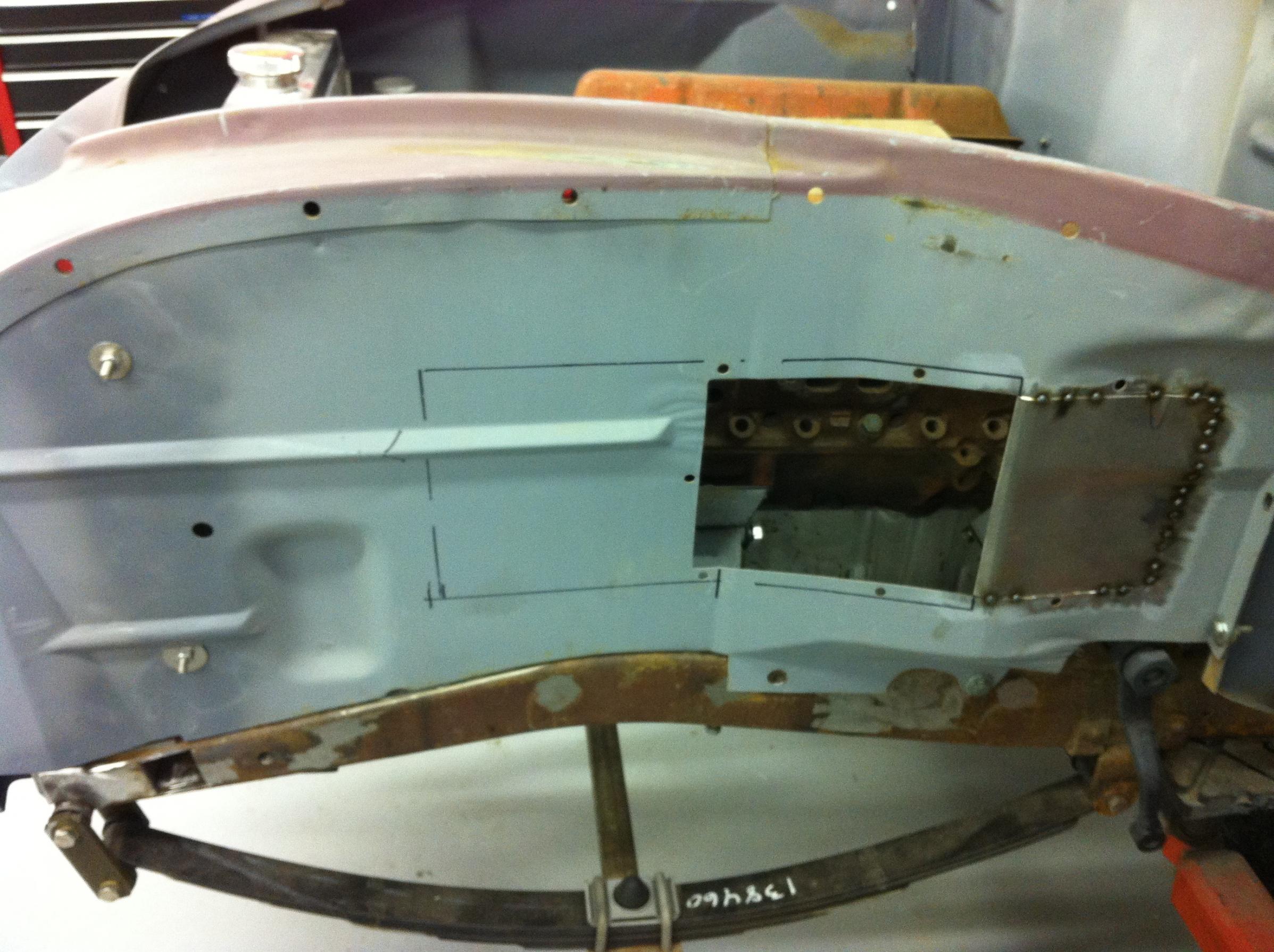

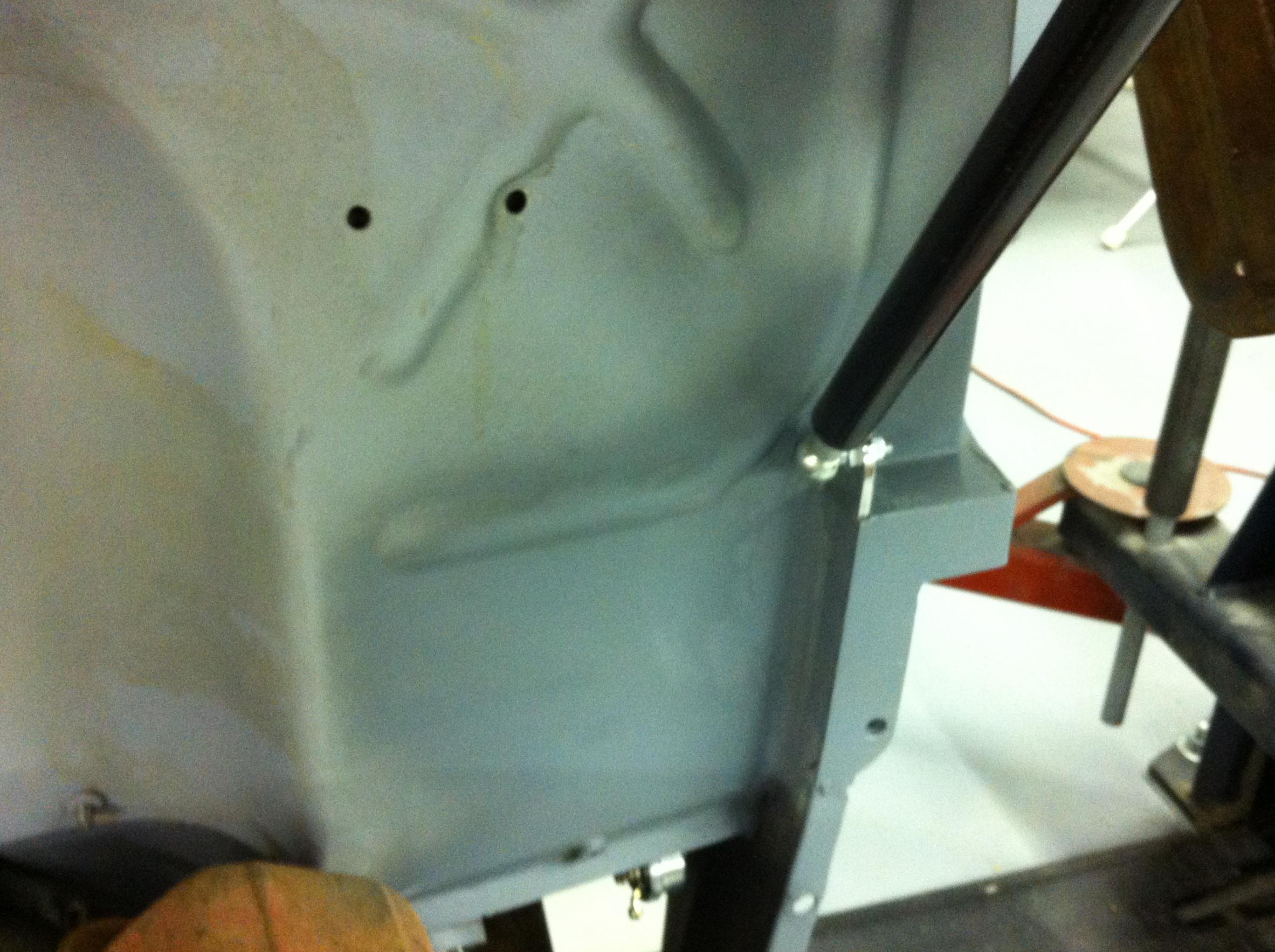

    Well I'm back out in the shop doing the things I love to do. Last post I was ready to start on moving the fire wall back 2 inches. I filled all the holes. every thing seems to fit OK. I will panel bond the fire wall to the cowl. I will do small spot welds in the drilled holes. should work out just fine.;)

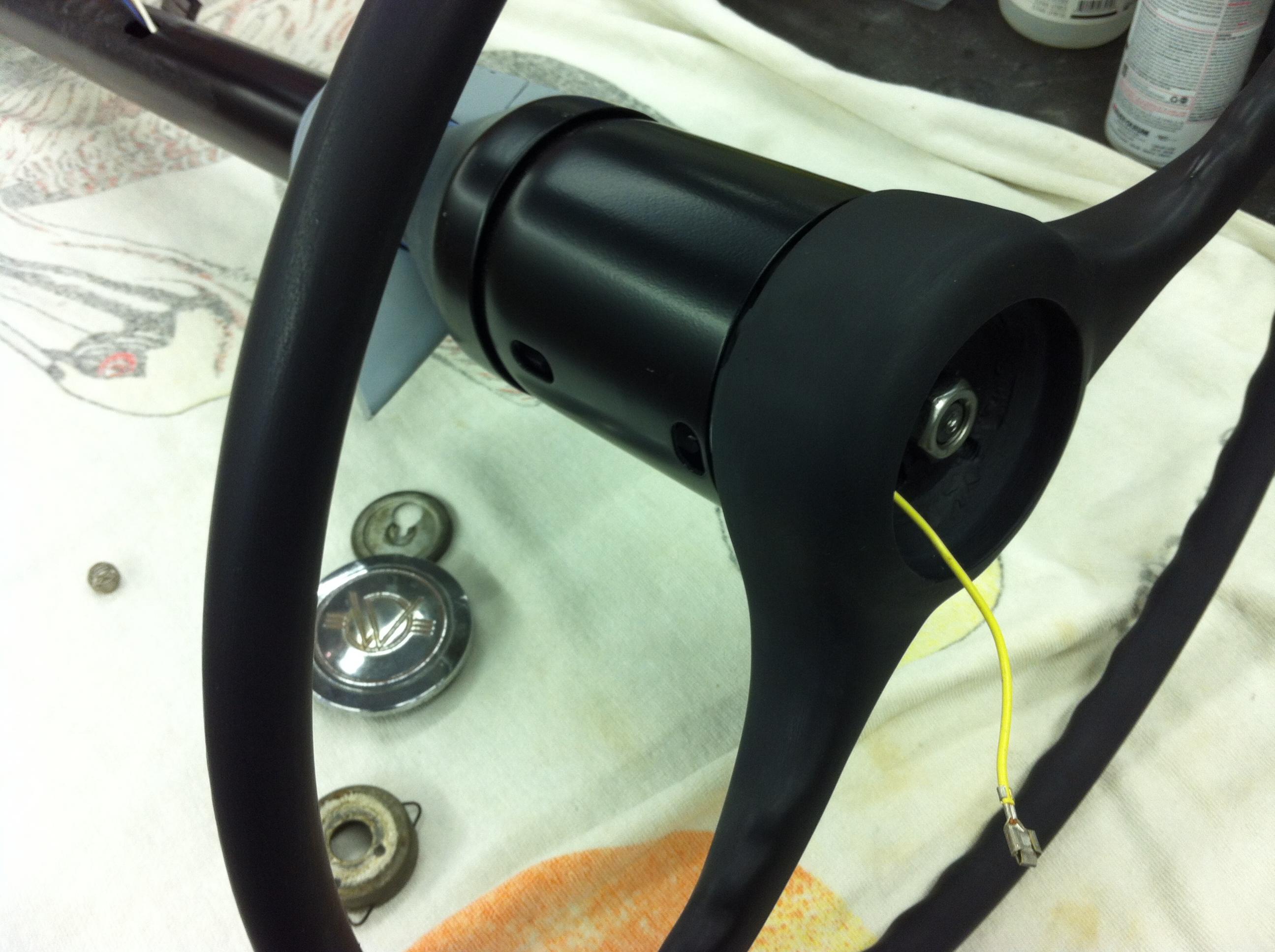

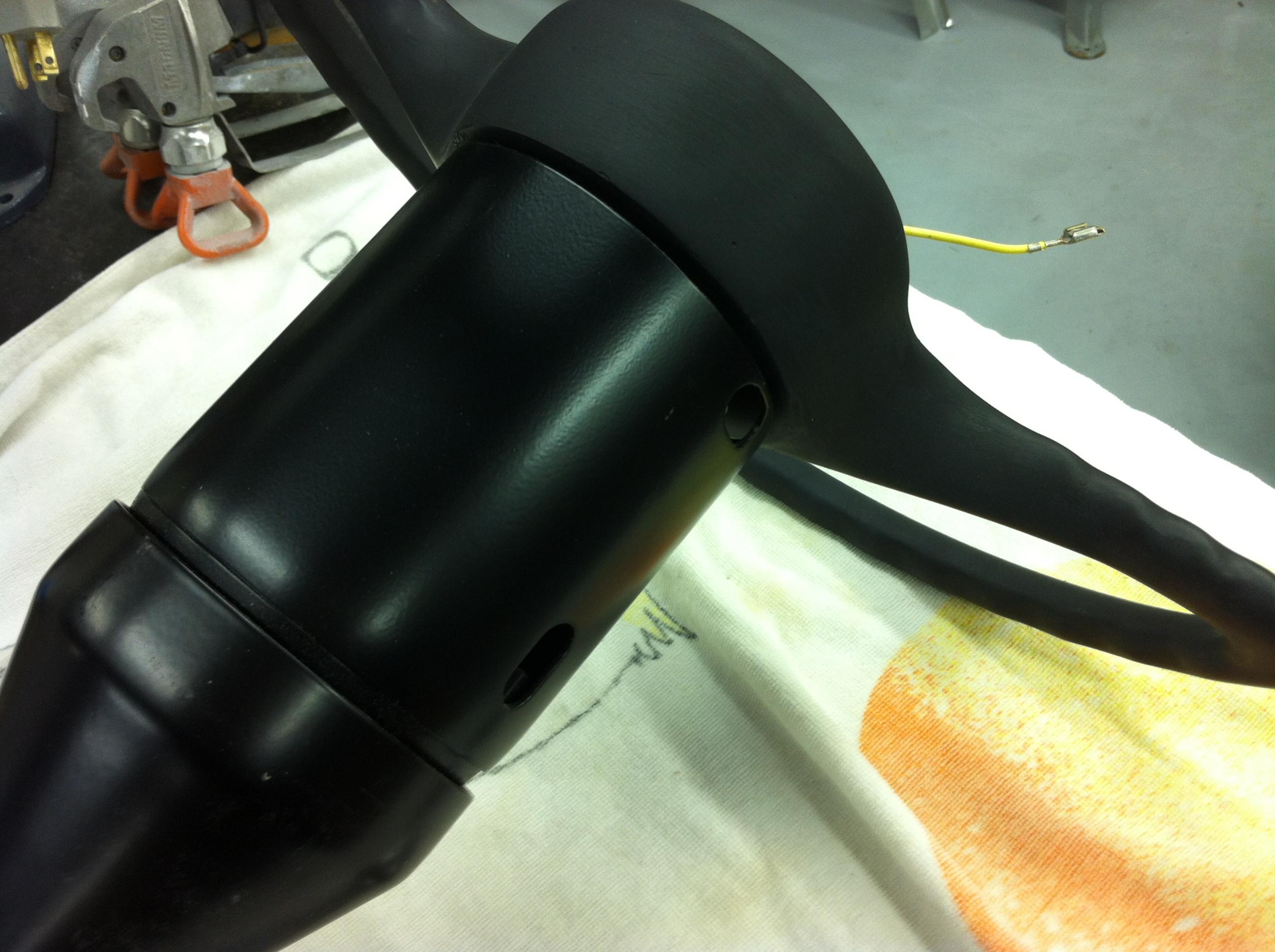

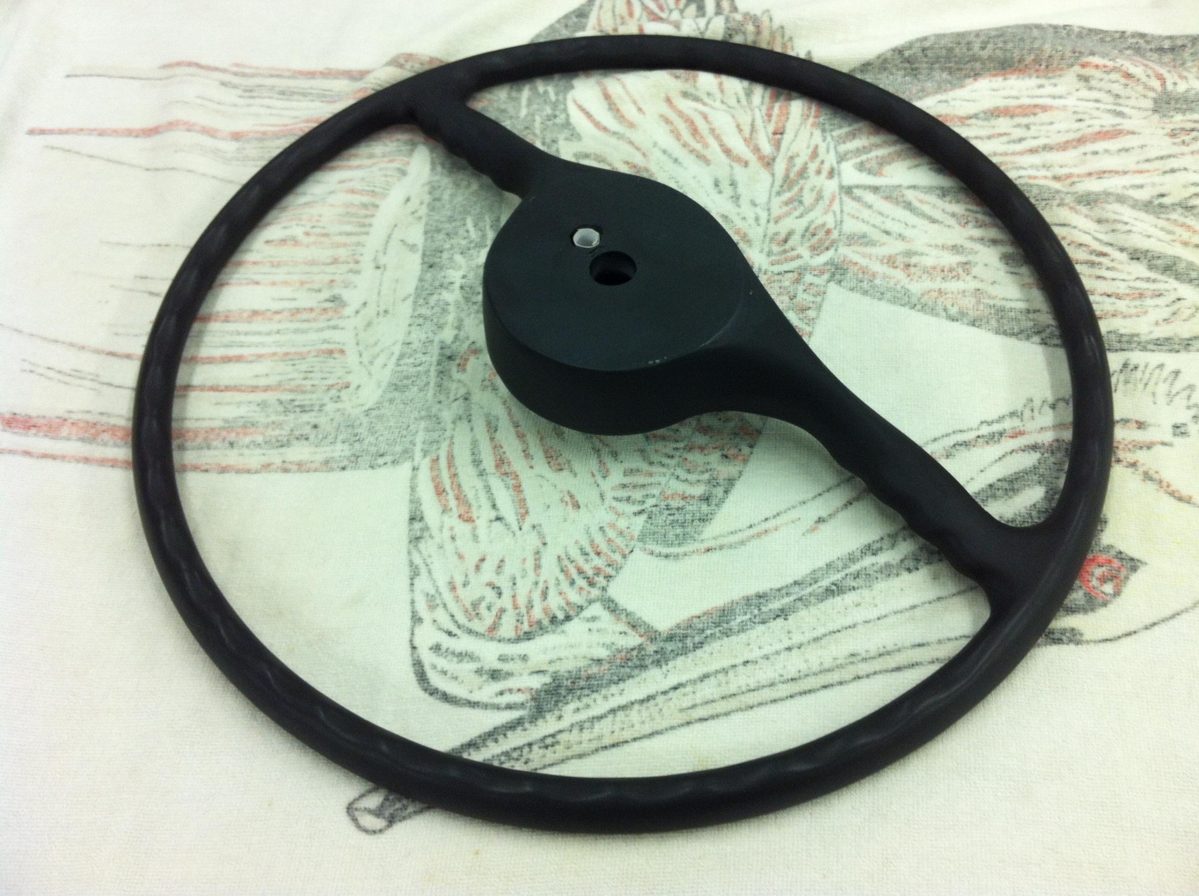

    My friend wanted to use the original steering wheel with a modern column. The steering wheel was in bad shape. So I cut down all the crackes and filled them with JB weld. It works great on old steering wheels. I then formed a new bottom to the wheel to match the column. I also built the column drop shown here..... The spline on the modern column didn't fit the steering wheel. So I installed a new spline in the wheel and made provisions for the horn wire. Just one more small step....:D

    440 deluxe
    that wheel is just bad ***. thats what i want to do. you did a great job. keep the pics coming.

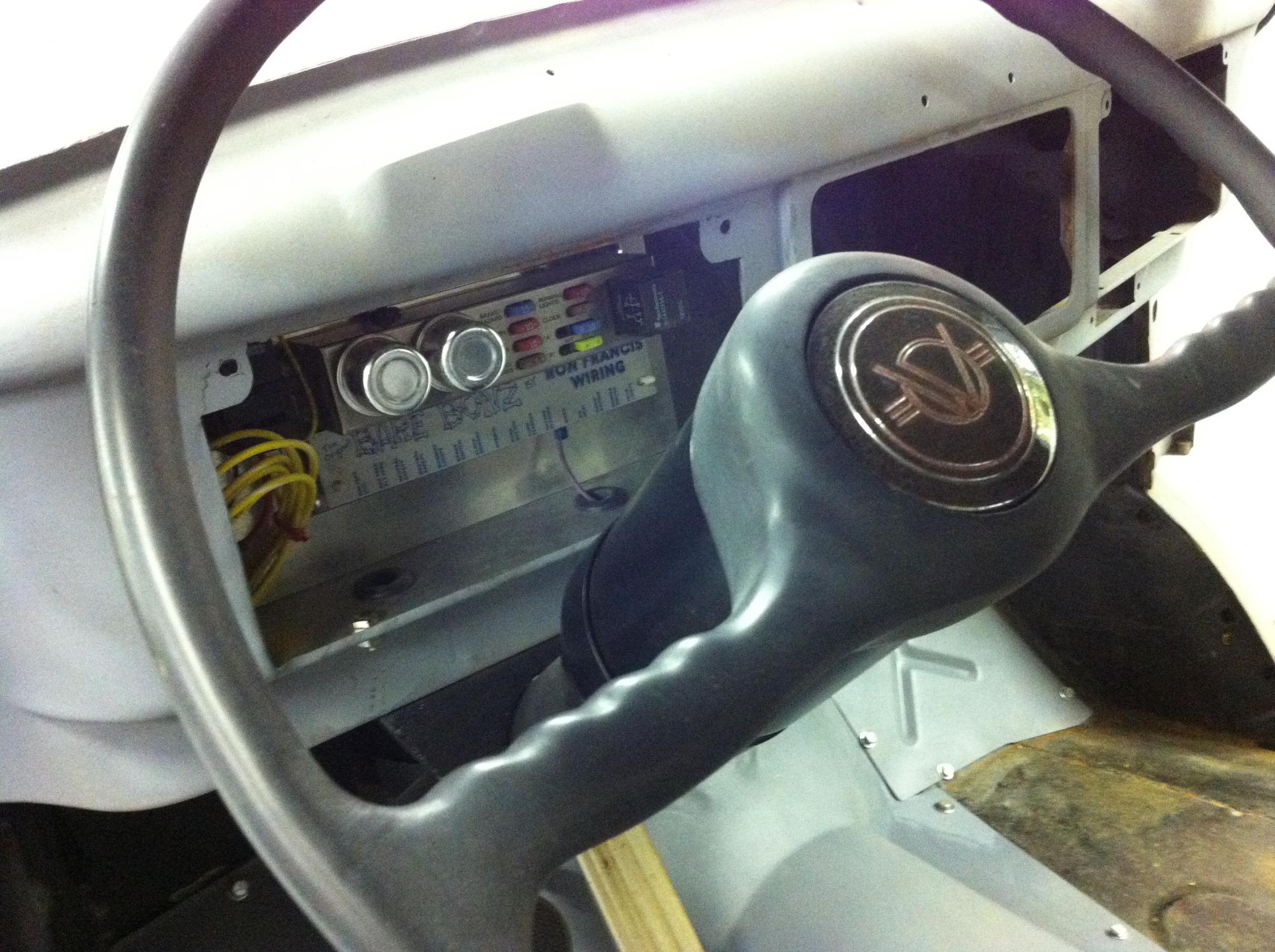

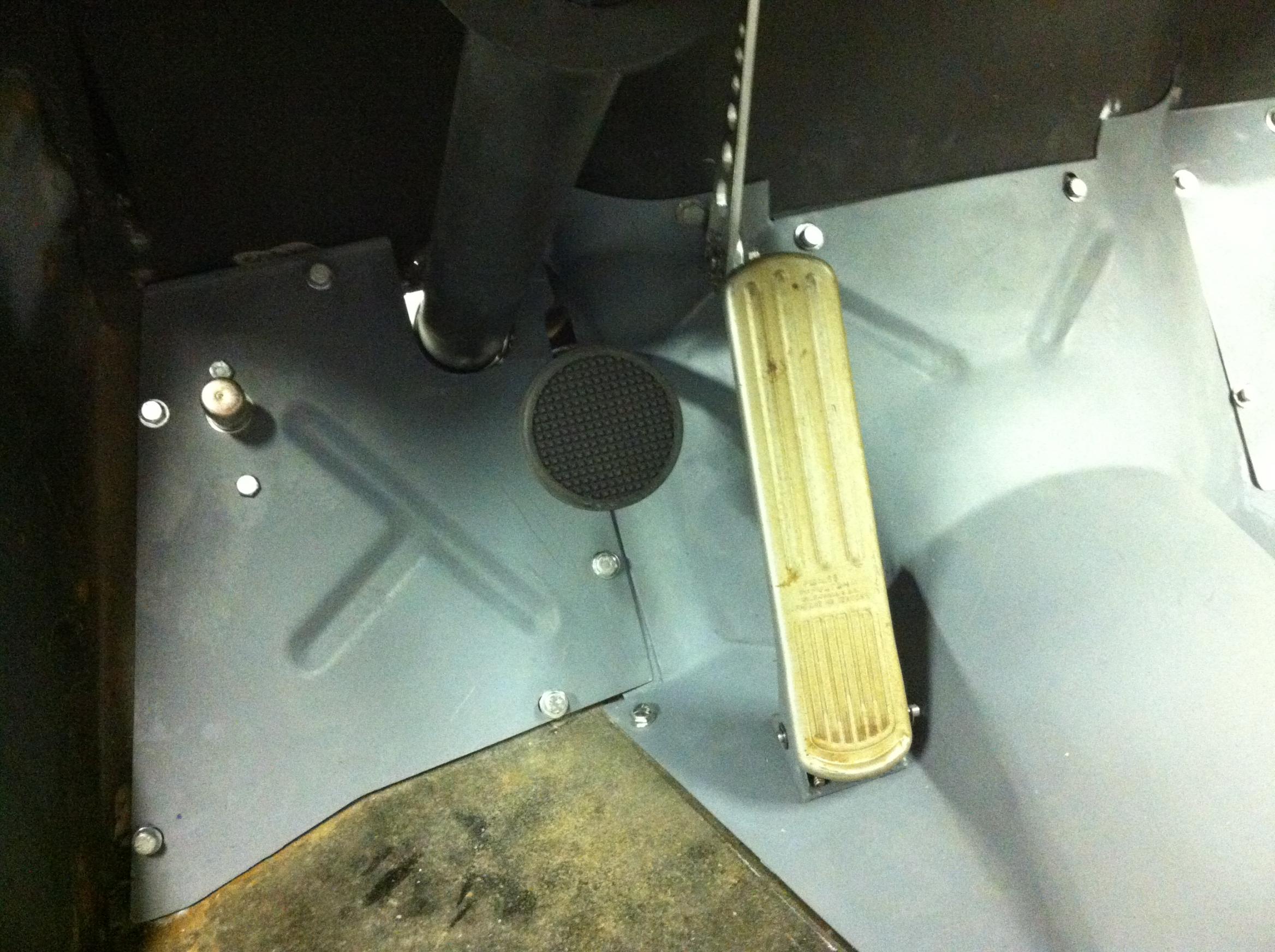

    Just a few pics on the Willys project. I set the fire wall back 2". I wanted to get the stock trans cover and kick boards fit befor the body came off the frame. Also the brake pedal and gas pedal are mounted. The steering is set, using the stock Willys steering box. I made a Delrin seal for the top of the box with an O ring. The wiring panel is set to go. It will work nicely in this compartment.
    The air struts are mounted and seem to work fine. a little stiff right now. Hope they calm down. The transmission mount is done. Fenders and hood fit good at this time. Will refit when body comes back on the frame.
    Next step is the tire size:confused: So I can set the wheels inside the rear fenders and get my 9" ford rear end width.
    Main thing is, having fun working on a project.:D

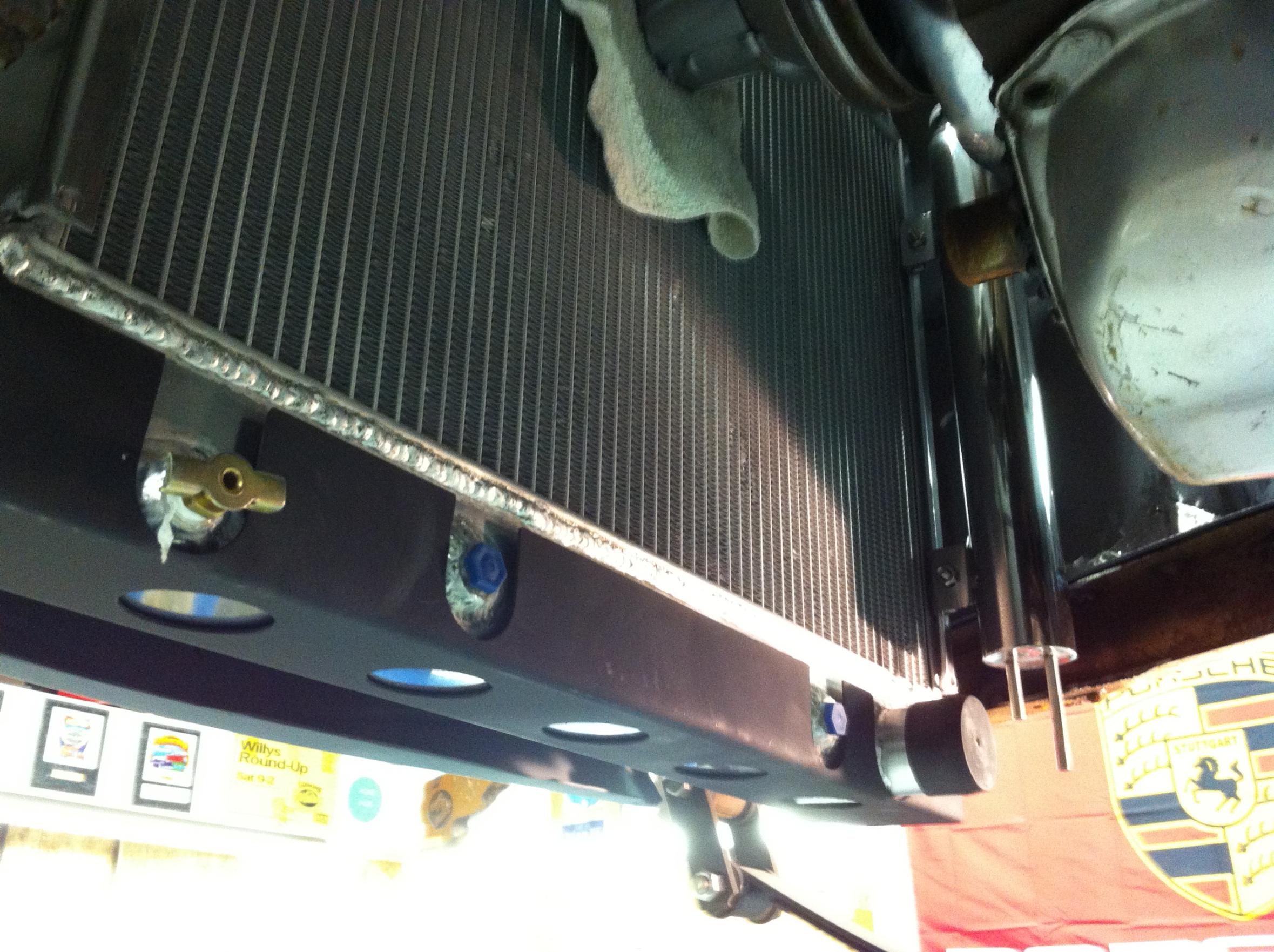

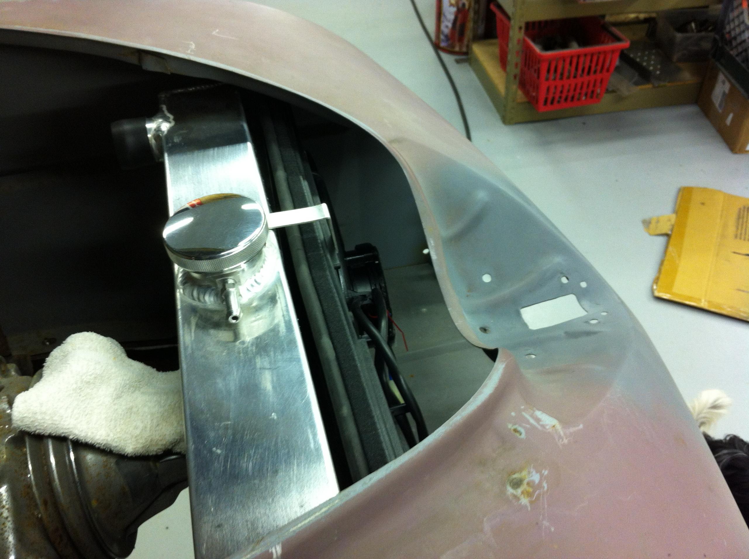

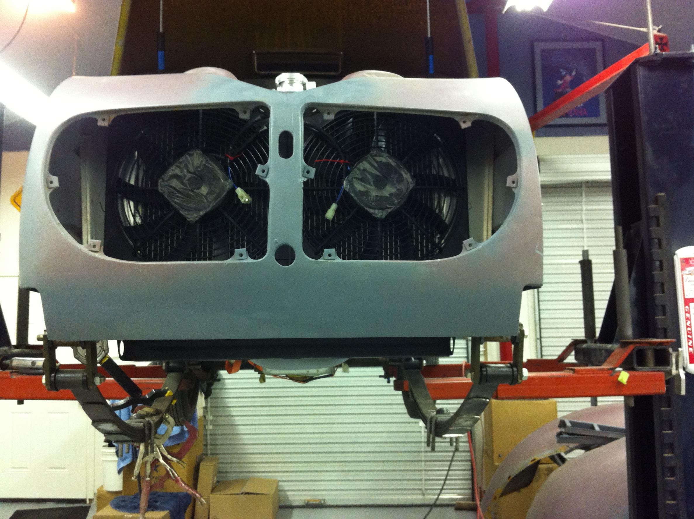

    Here are some pic's of the radiator bracket and the fans mocked up. The new springs are set up with a 1" more arch. The daul fans fit perfect. We didn't want a cross flow radiator. This one will work great. Over flow tank fitted.:)

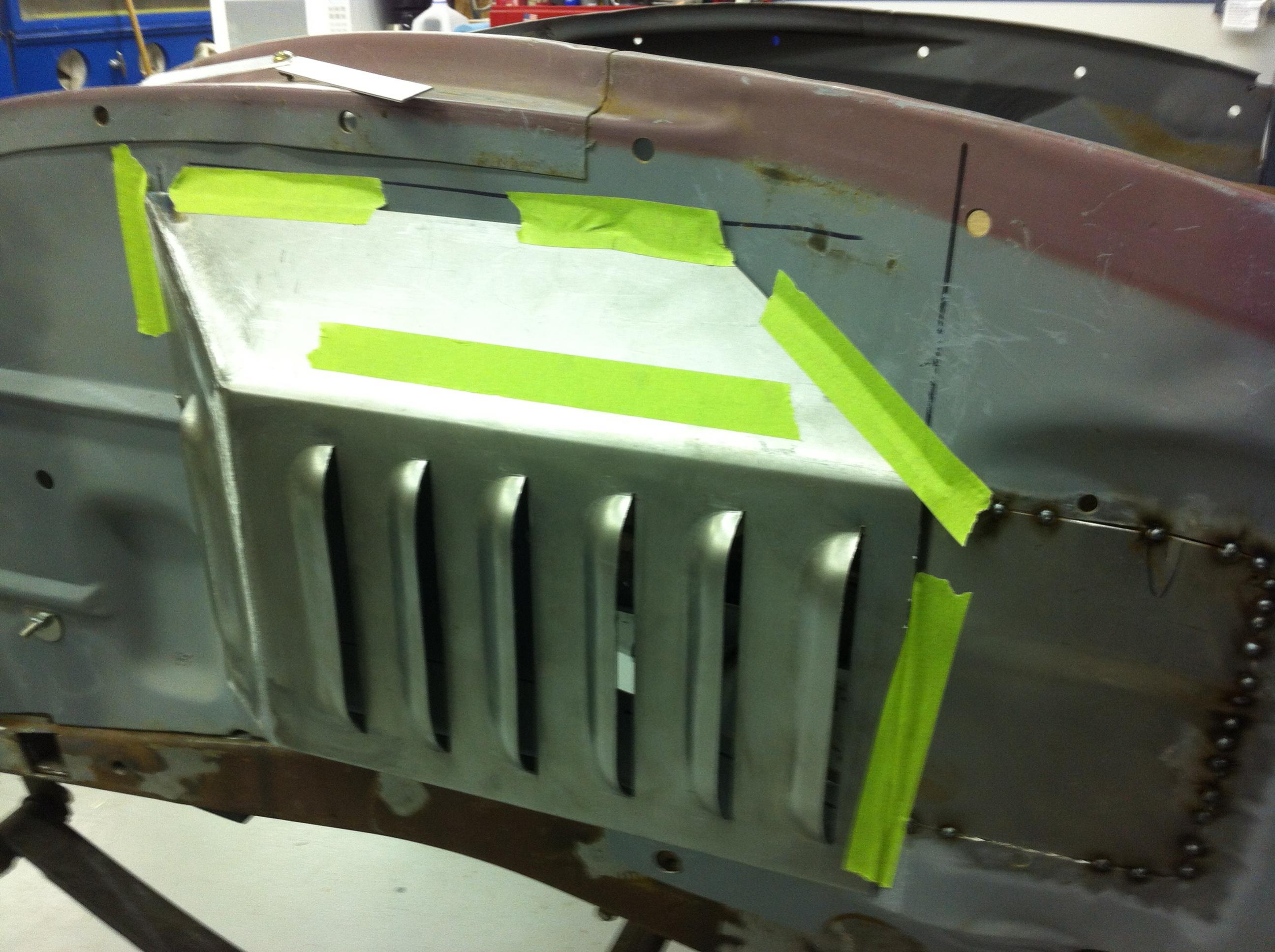

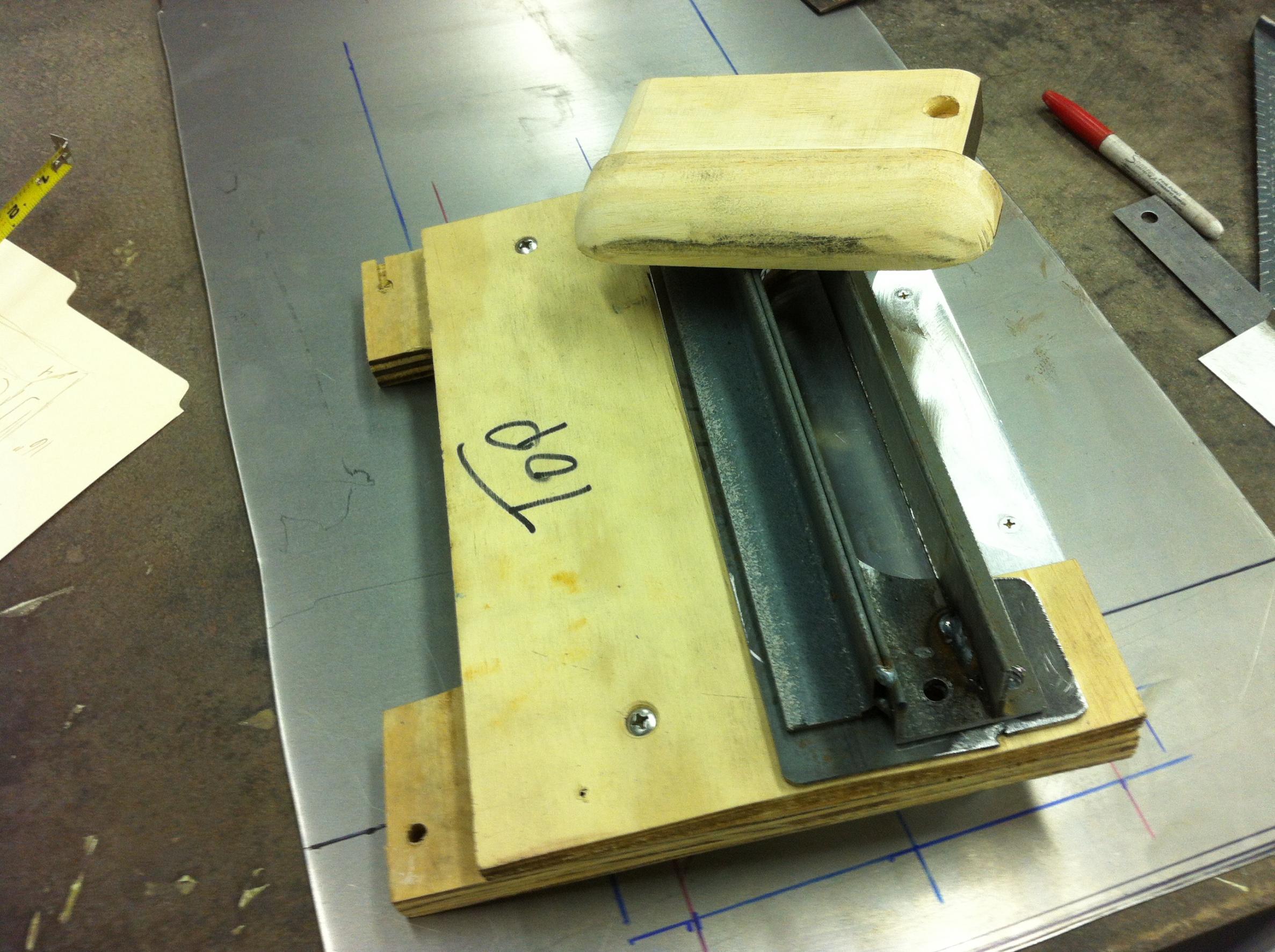

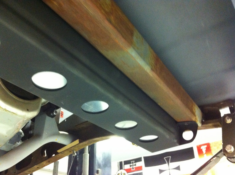

    I like the looks of the p***enger side fender well with the 6' louvers. I think it would work out to have the same 6" louvers on the drivers side wheel well. So is all I need to do is made a simple punch and die for the 6" louvers. I will use 18ga similer to the stock Willys steel. This is my simple punch and die showing my first test. Looks good. So I have punched all the louvers in the sheet metal and will weld this into the drivers side fender well. I will post that later.:D
