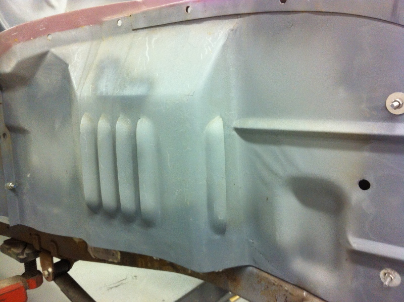

    This is the duplicate from the p***enger side louvers to the drivers side. Check out how I made the louvers. The hole on the drivers side well, will be for the fender well headers to come out.:) The new louvers look bigger in the photo, but are the same size as the p*** side:eek: The drivers side is done. I just put on some self etching primer. Sand and fill primer will do the rest. :)

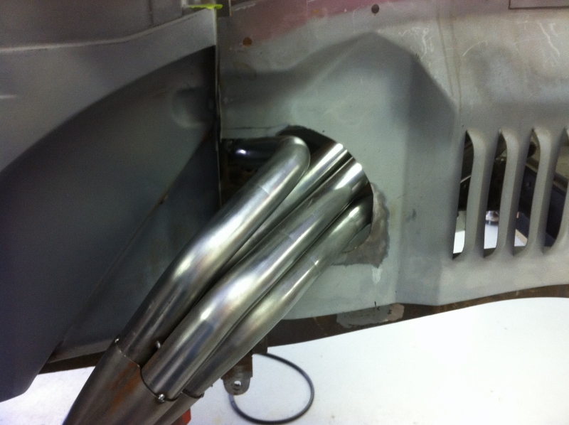

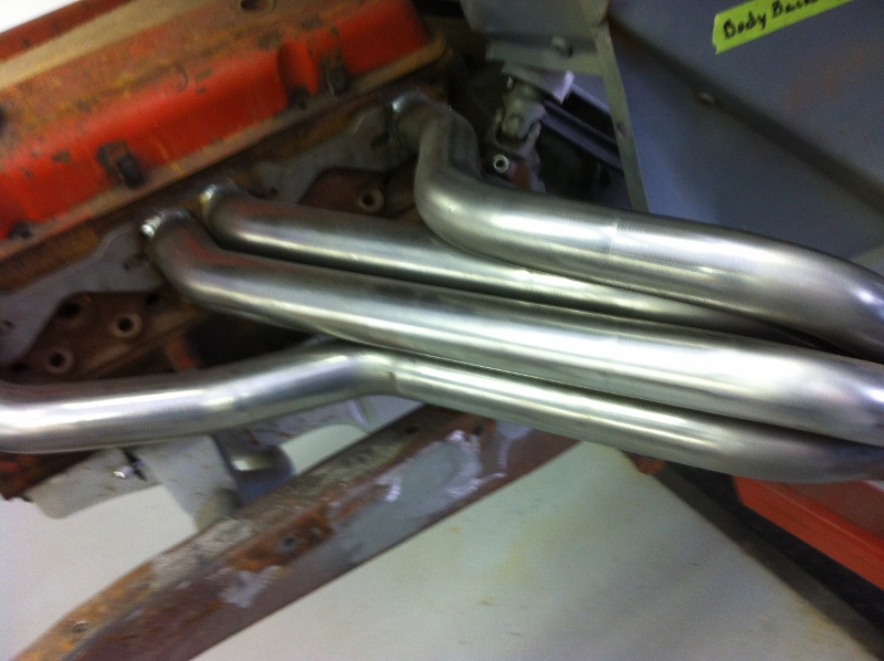

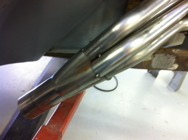

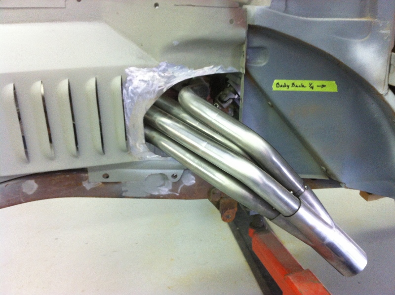

    I just got my headers:) They fit just great. I didn't want them to go out threw the cowl. These as you can see #8 exhaust port pipe bends around to miss the fire wall and cowl. They have 3/8 flange and are 1.750 OD. I'm fitting the header threw the inter fender wells. I will make aluminum heat sink rings around the fender well opening's. The 3" collectors will have exhaust cut outs mounted to them. Should sound cool:cool: more pic's to come:D

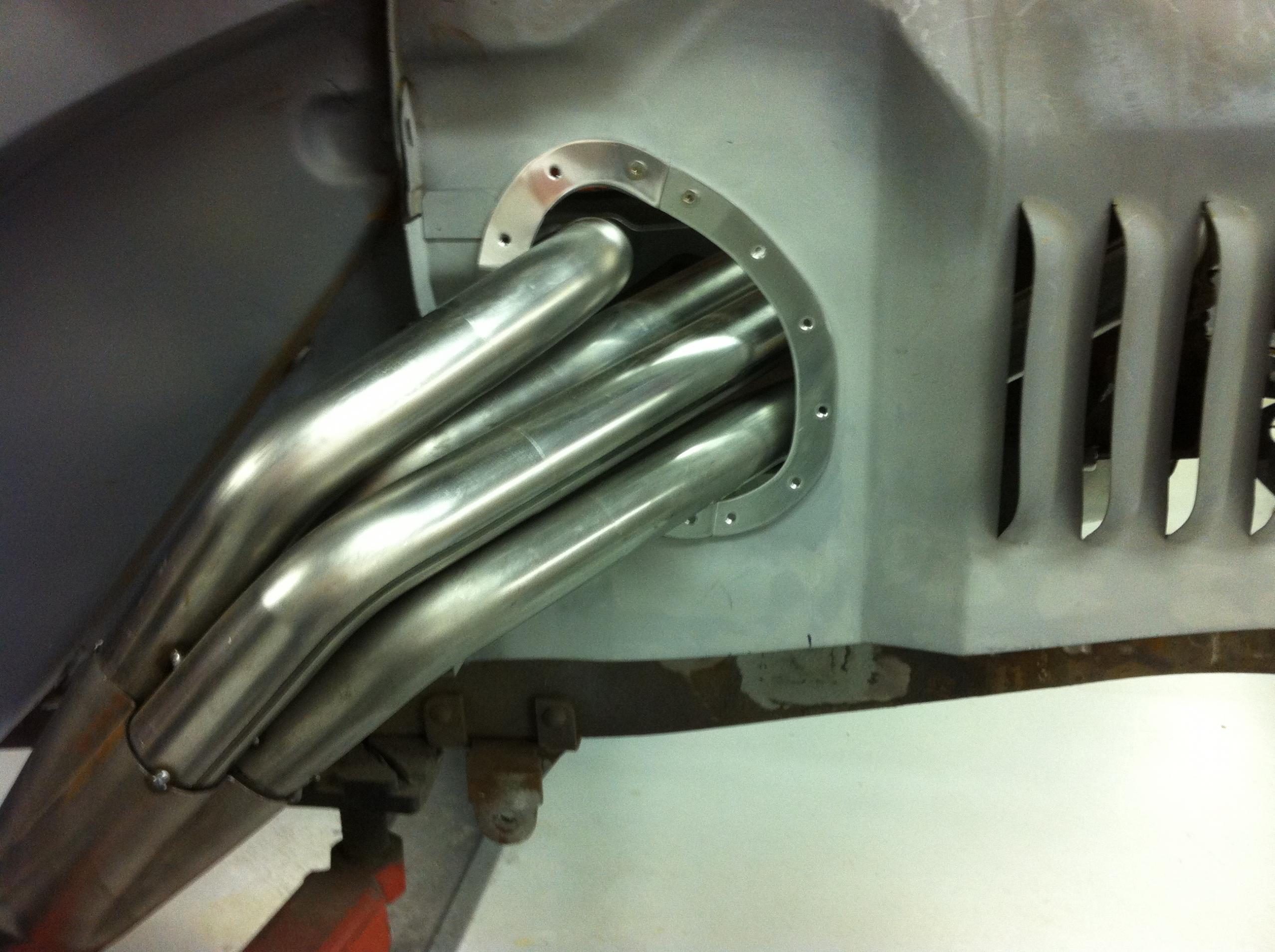

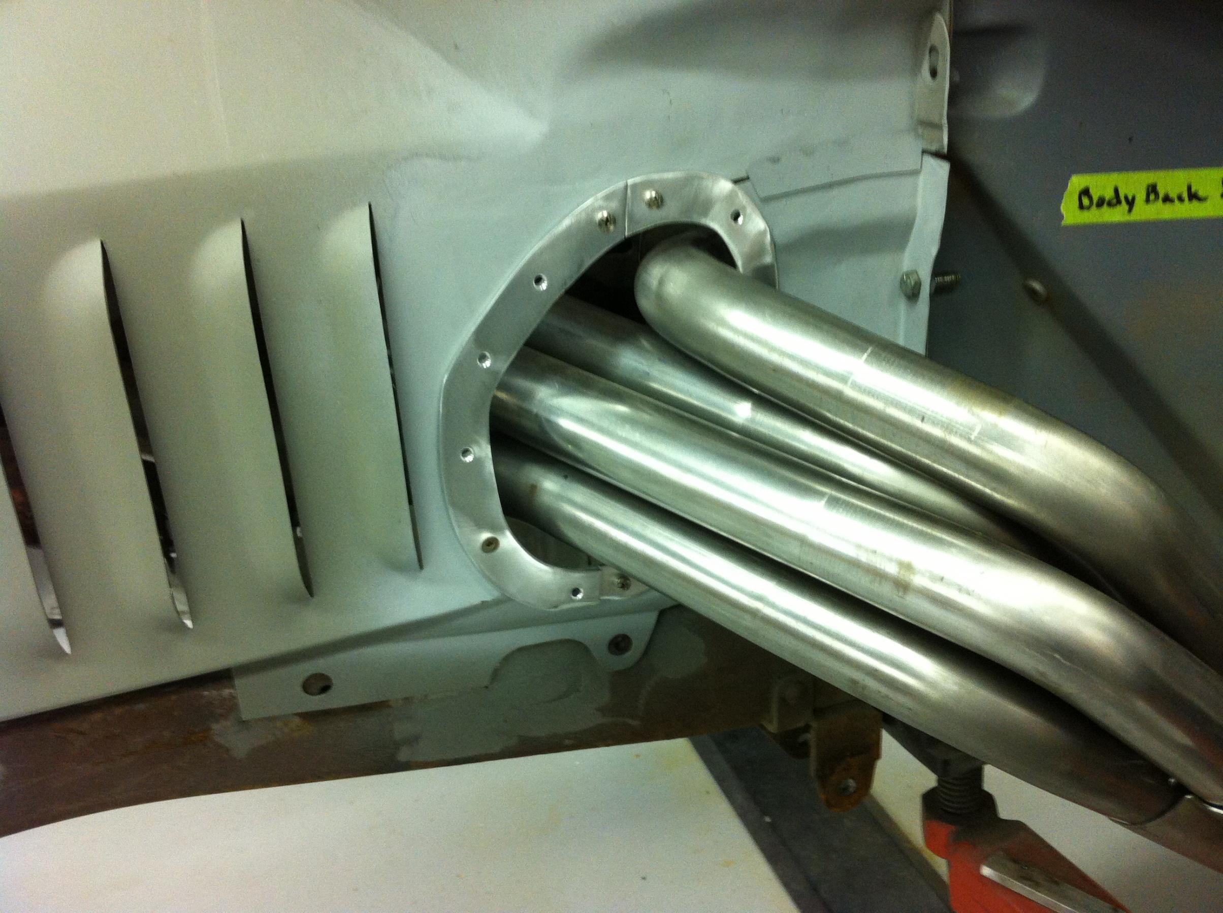

    This is how the inter fender wells look with the heat sink rings installed. They will be installed after paint. They can also come apart so as to install and remove the inter fender section. Note how the headers fit nicely around the cowl. :D

    Hi cruzznn. They are made just for SBC to fit Willys. They are made for BBC also. Fast Time Rods:D

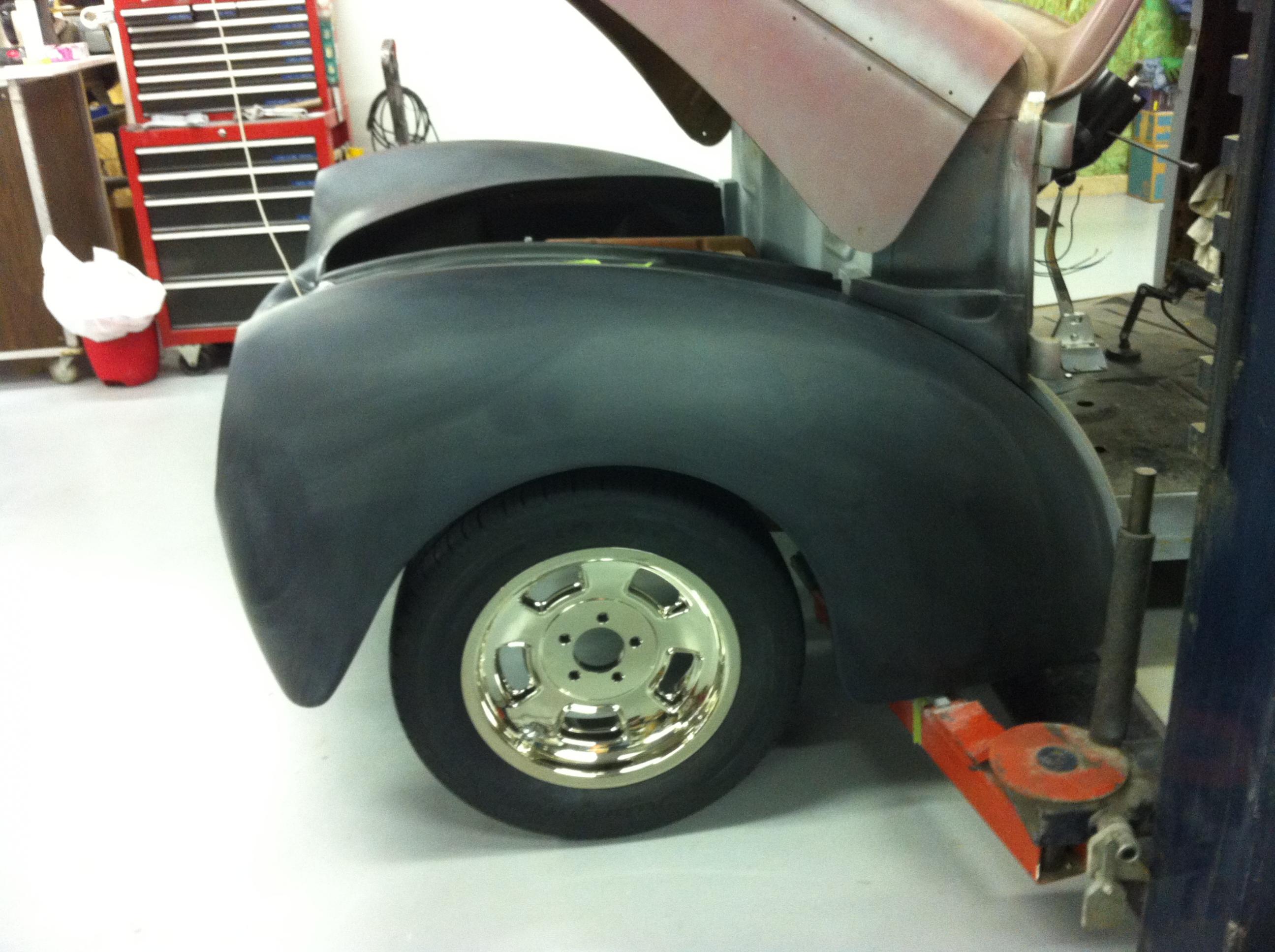

    left coast. The price 20 years ago was twice that much. I'm still working on the front sheet metal. The fenders are perfect at this point. The front wheels and tires look good. The grill center section is 90% done. The chrome grills fit perfect. The hood is ready to have delux trim holes drilled. the doors are fit and looking good. All front stock axle and other front end parts are being chromed at this time. Going slow.:)

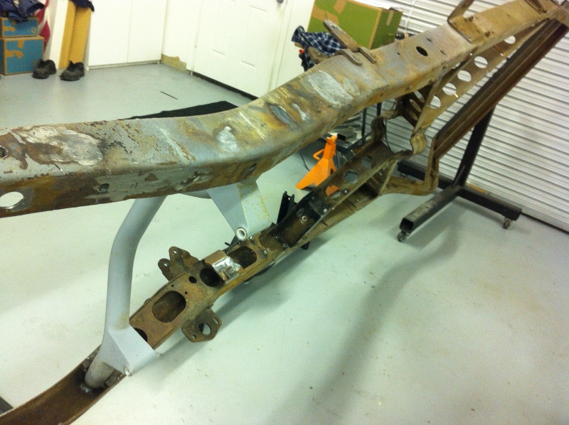

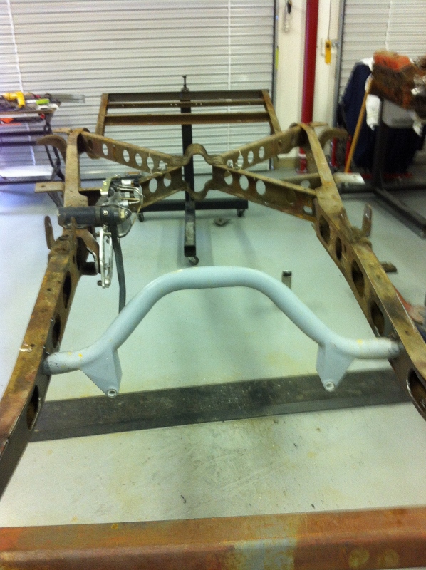

    I love it when a plan comes together. The body is off the frame and I'm ready to sand blast the frame. It is now time to get all the frame brackets installed and boxing the frame. I will show photo's od the chrome front end when back from the chrome shop. This is a mock up of the master cylinder using the stock pedal ***embly.:D
  24. sick!!!
  25. hotrod--willys
    Joined: Dec 15, 2009
    Posts: 531
    hotrod--willys
    YES. Any one that has worked on cars for over 50 years is "Sick" :p
    With that being said. I'm to old to crawl around on the fool to get to things. so I try and make my life as easy as possible. I'm using engine stands to turn the Willys frame around so as to be able to drill out rivets and make patterns for the boxing. This works great and sure helps use old farts.:rolleyes:
    PS This is a perfect way to paint the frame. Just keep turning and painting.

    This is the set up I'm using for the rear end. 9" Ford, 3:73 Locker. Dutchman HD axles, Ladder bars and coil overs. Now to paint it black.

    The frame is ready for sand blasting. All unnecessary hole have been filled. Photo of frame at sand blasters:)
