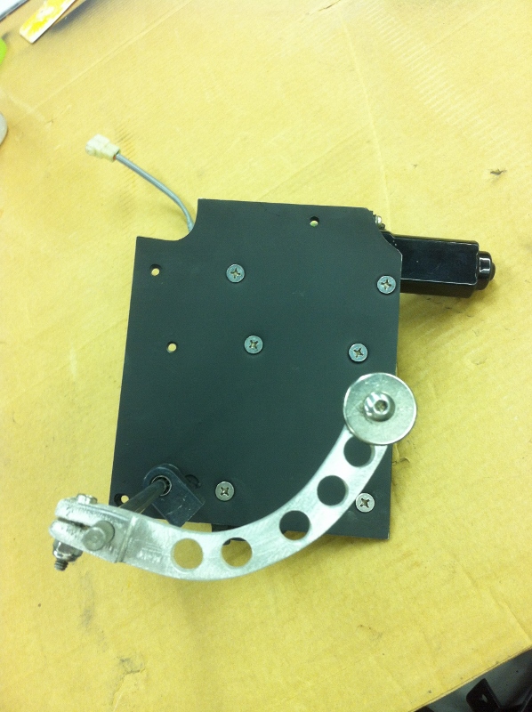

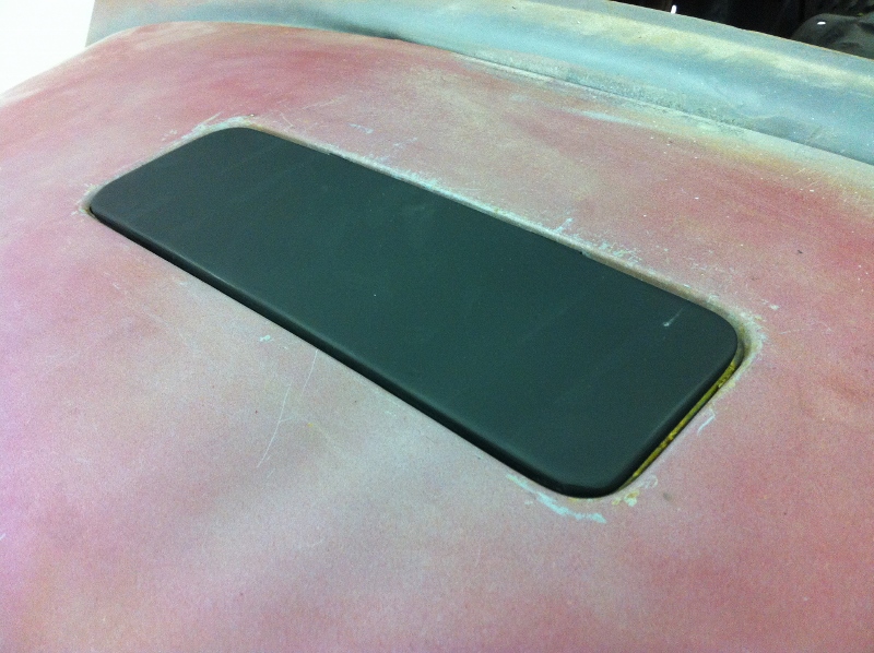

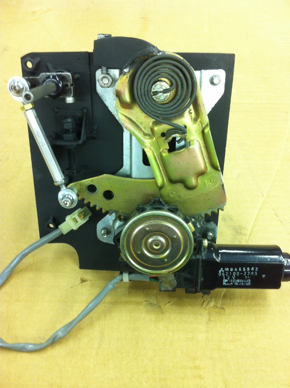

    This is a little contraption I've made to open and close the air vent door. I'm using a roller earth magnet to hold the door open and closed. The mechanism is a power window motor. I made it work by installing stops for up and down. I'm using a up and down momentary switch to activate the motor. when the hood is down and the vent is down. when you lift the hood the magnet releases from the door. If the vent is open and you open the hood the magnet will release. This gets rid of the vent handle under the dash. Works just great. :)

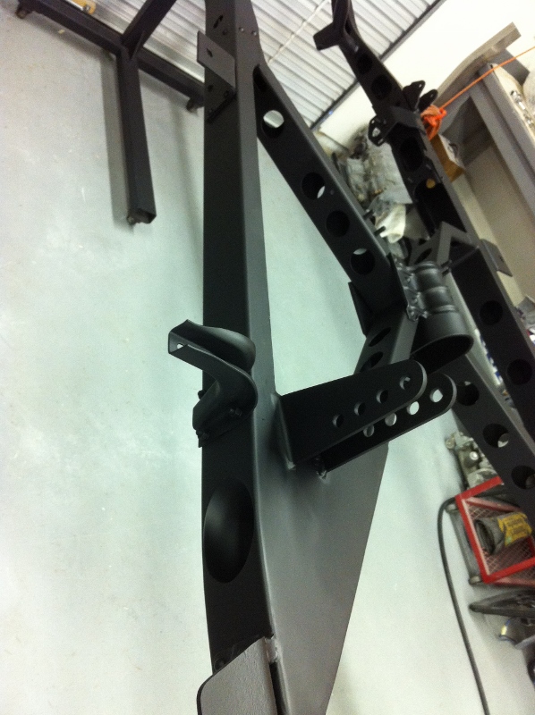

    These are some pic's of the 1940 Willys frame I'm working on. The entire frame has been boxed in with 1/8 plate. Holes were drilled to keep the Willys frame design look. I s***ch weld the plate every 3", each weld is approx. 2" long. All welds have been finished down for a smoother look. Some might say that is because my welds are not like the once were.:( But this is the way I like the frame to look after the paint is on.:) Next will be to prime and paint black. The car is going to be a non metallic dark gray.

    I put the body back on the frame after boxing. Every thing line up perfect. The frame is out of the booth. This is the first good coat of primer. I will block and sand this down and prime one more time. Then the black will be applied:) . The first step is to get the frame completely done ready for the body.:eek:

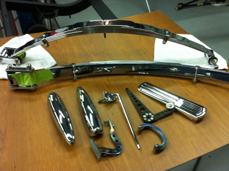

    Now a look at some beautiful chrome work. I'm starting to get parts from my chrome shop. Unlike the 40 Willys horn ****on, His work is outstanding. Here is some of the parts done. He also does anodizing. The front springs are just beautiful. "I Love Chrome." shown is some stainless I did then heat blued them. All nuts and bolts and washers are polished stainless;)

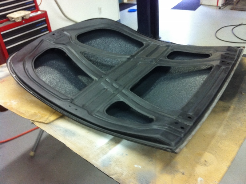

    The trunk lid sever damaged near the bottom of the lid. Some one just beat out as much as they could. Then filled the big dent with bondo. They also beat on the inter panel and almost ruined it. There was a real problem getting to the damage with the inter panel in place. Soooo. I cut it out. :eek: Now I could get to the damage and also straiten the inter panel. The originally there was some type of sound deadening on the inside of the lid. I'm using bed liner to replace the original deadening look. The bed liner is tinted the color of the body. The inter panel will be panel bonded back in place.:)

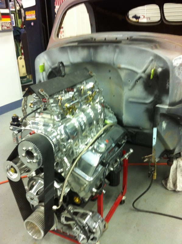

    Just a last check before the engine goes back to the engine builder for the dyno run:eek: This will be fun:D

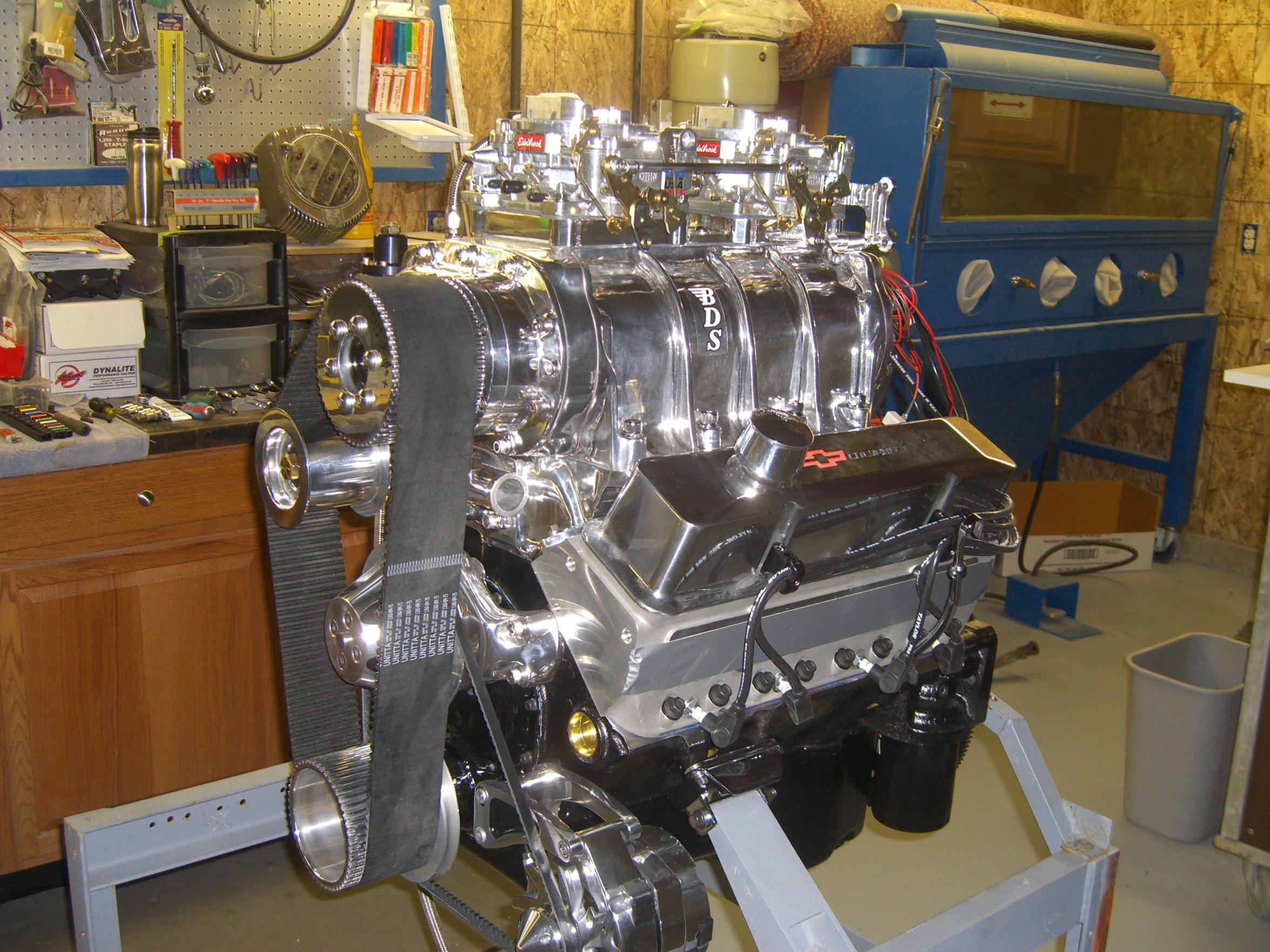

    This is still a SBC. But. It is 433cu in. And will weight in at about 580 lbl. A lot lighter than a Hemi, Olds, BBF, and a BBC. It is power to weight that counts:).
    Ps. I know it looks like a Summit engine. I don't give a **** what others think of it.:rolleyes:
