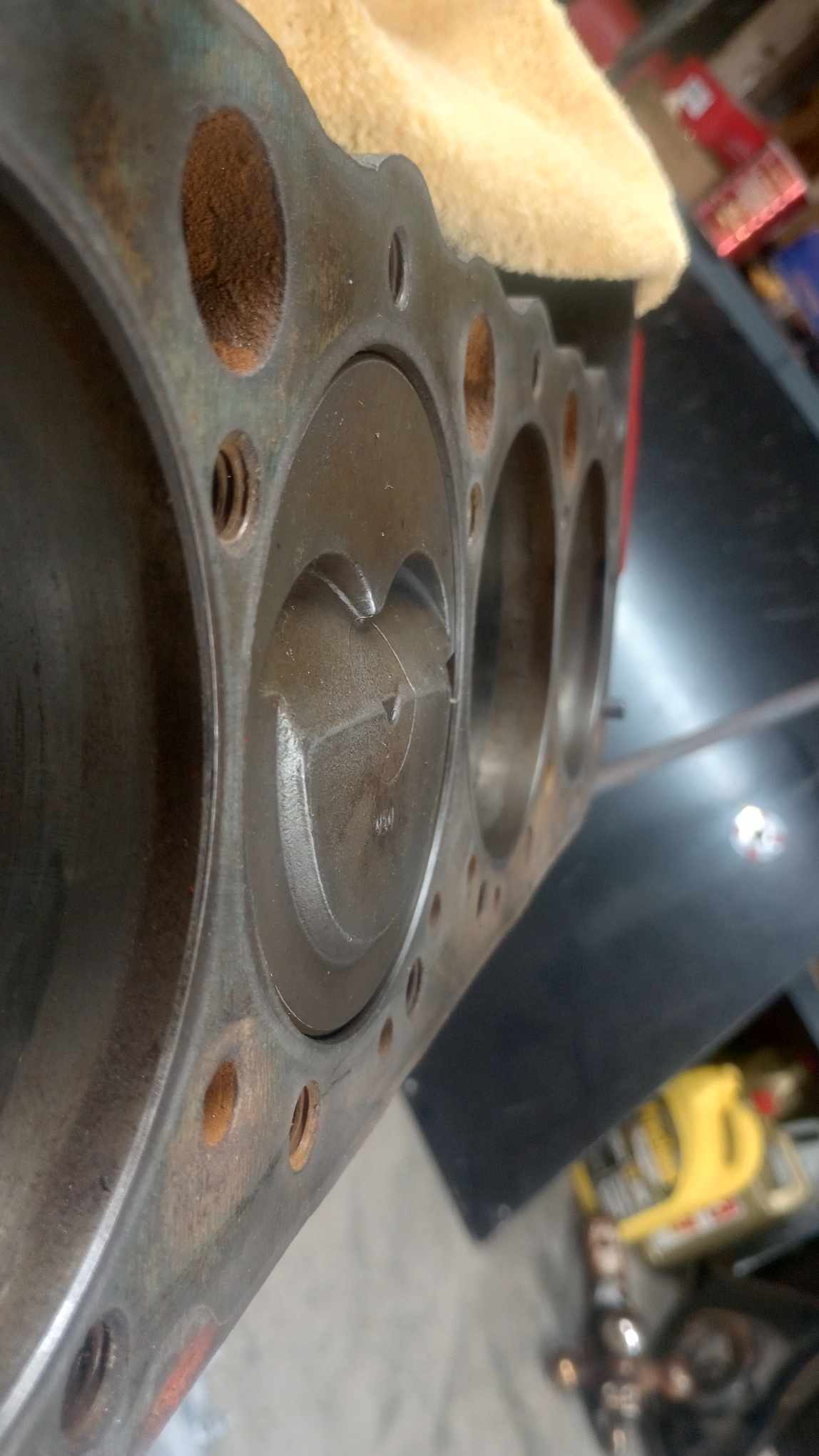

    I have pictures of short block

    Machine shop is pulling your leg on the compression ratio.
    The only way that piston is 11.2 is with everything at or near minimum blueprint spec.
    You said no decking, block or heads.....so that's barely a 10.5:1 compression ratio if you are using a typical composition head gasket that is about .040" thick.
    Using a steel shim head gasket would push that up to about 10.7:1
    Otherwise with a 64cc head you need to deck block and mill head to make that piston be 11.2:1.
    Deuces, Sharpone, 427 sleeper and 2 others like this.

    How far down the hole are the pistons?
    Roothawg, Deuces, Sharpone and 2 others like this.

    Basic calculation:
    Bore: (diameter) 4.030"
    Stroke: 3.25"
    Cylinder Head Volume: 64 cc
    Effective Dome Volume: -5.3 cc
    Deck Clearance: .026"
    Compressed Gasket Thickness: .040"
    Number of Cylinders: 8
    Compression Ratio : 10.35 : 1
    Zero deck would bring it up to 11.1:1
    So ya. Someone's blow'n smoke up........well you know:D
