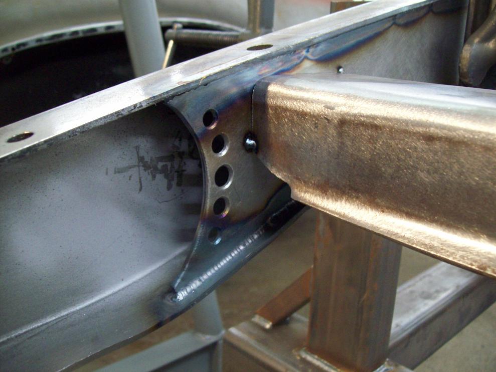

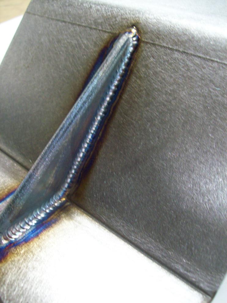

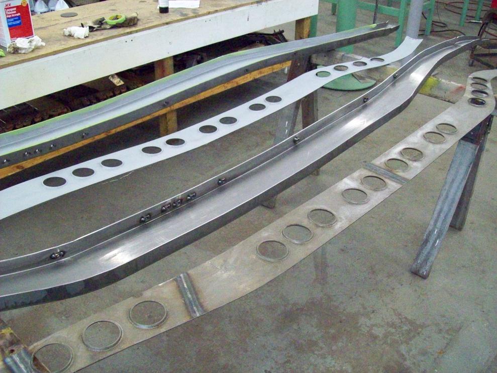

    Had to rearrange a few things on the boxing plates to get them where I needed them... and then fitted them to the ASC rails. Weld-thru primer inside the plates and rails. I added a few details to the ends of the IONIA boxing plates...

    Step-boxed rails...

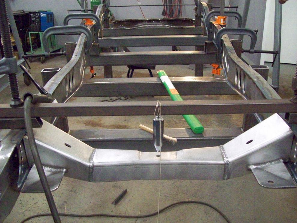

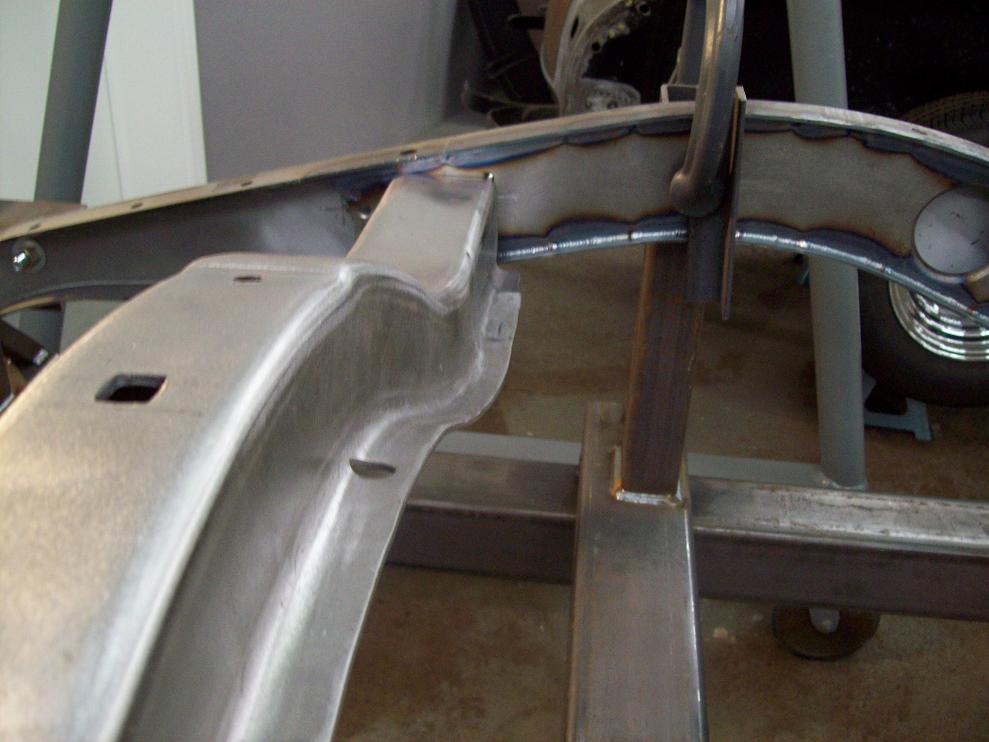

    Pete and Jakes front crossmember fitted...

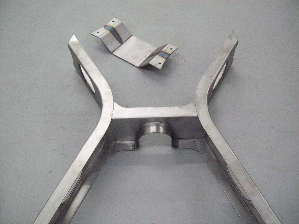

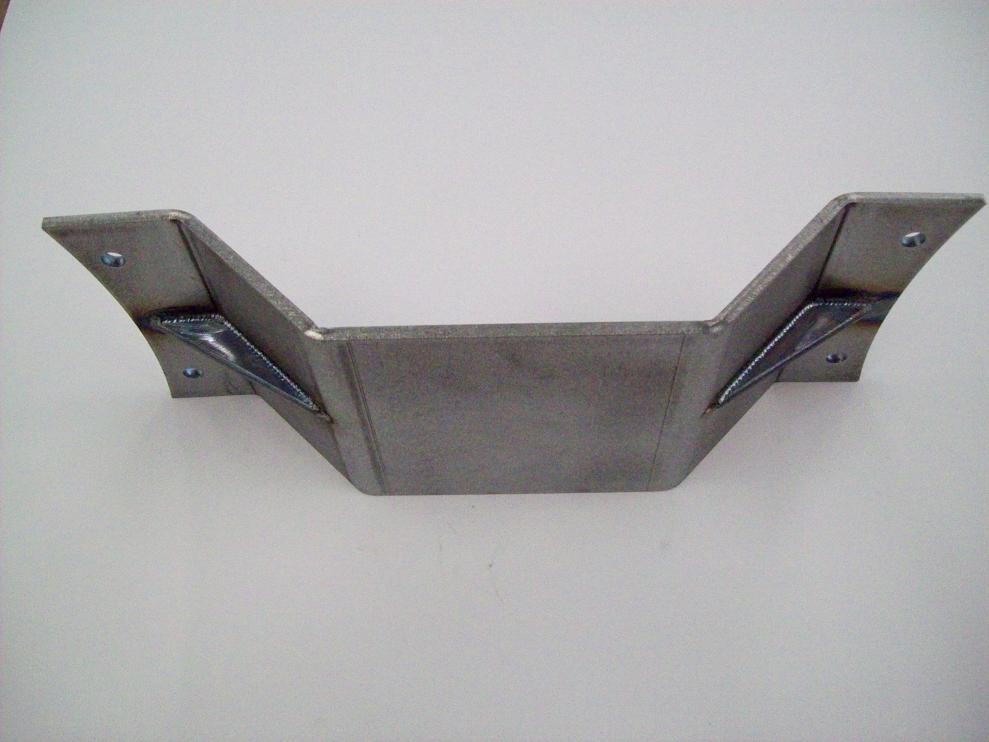

    Model A rear crossmember, for the quick-change... probably the nicest model a rear crossmember I have seen or used...
  6. vendettaautofab
    Joined: Jan 9, 2006
    Posts: 1,602
    vendettaautofab

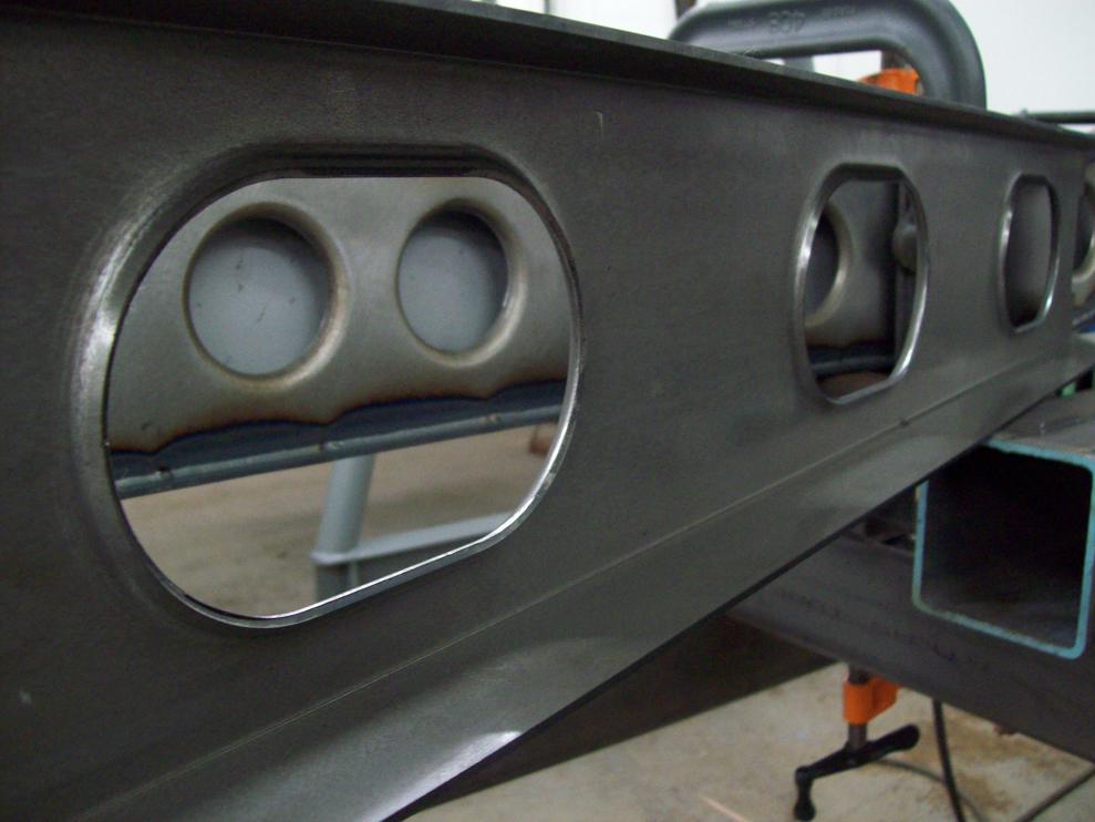

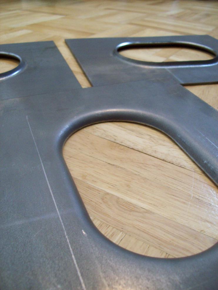

    The new version of our old crossmember, now has belled OVAL holes... which required investing in the dies, ofcourse... well worth it... here are the samples we ran with the dies before they went to heat treating, and the new crossmember sections.

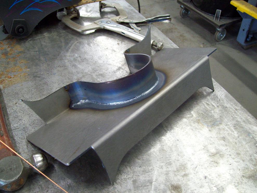

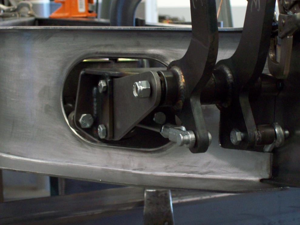

    Pete and Jake's Brake and Clutch pedal fit...

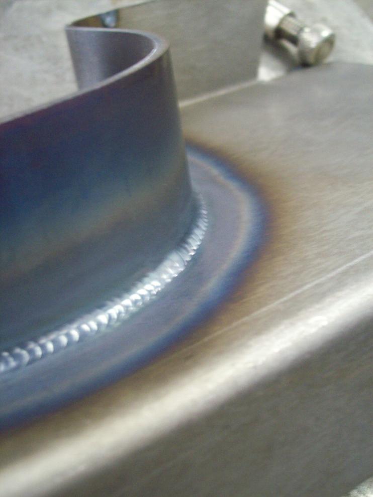

    Here are a couple more pics of the brake assembly... if you see the last pic, its of the crossmember, before... you can see the amount of fitting done to make for a sanitary install of the brake and clutch assembly.
