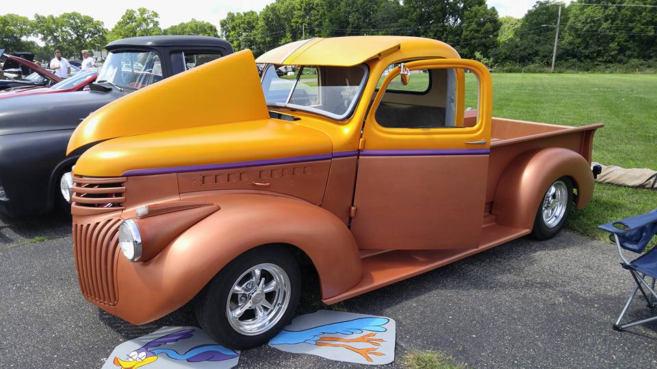

    Truck is now on the road. 5800 trouble free miles since October. Still more to do but having fun driving it while working on it.[​IMG]
  14. paintman27
    Joined: Apr 23, 2011
    Posts: 287
    paintman27
    from new jersey
    What is that fulton visor off of?
  15. UglyAries
    Joined: Mar 8, 2012
    Posts: 18
    UglyAries
    from SW Ohio
    Not sure on the visor. It was bought at a local swap meet.
