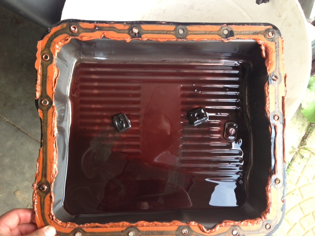

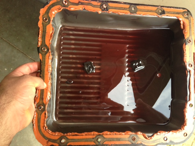

    Anyways attached are pictures from the first time I dropped the pan before I put it in the car. Whatever the junk was in the pan, is slightly magnetic as you can see it trailing from the magnets. The large chunk was a piece of loctite or something. It was really thin and curled up.

    That dont look real good for a fresh rebuild. But who the hell gooped up that pan gasket?

    Yeah but a few people said it doesn't look horrible either.
    The guy i bought it from said monster gooped it up. I think he was full of crap. Who uses ultra copper on a oil pan, let alone a trans shop?

    On the pictures you took of the Pan bottom right is a bump out to bled off the 2/4 band; There is a hole In the pan rail above that, I would bet money that RTV blocked the bleed hole and burned up the 2/4 Band.
