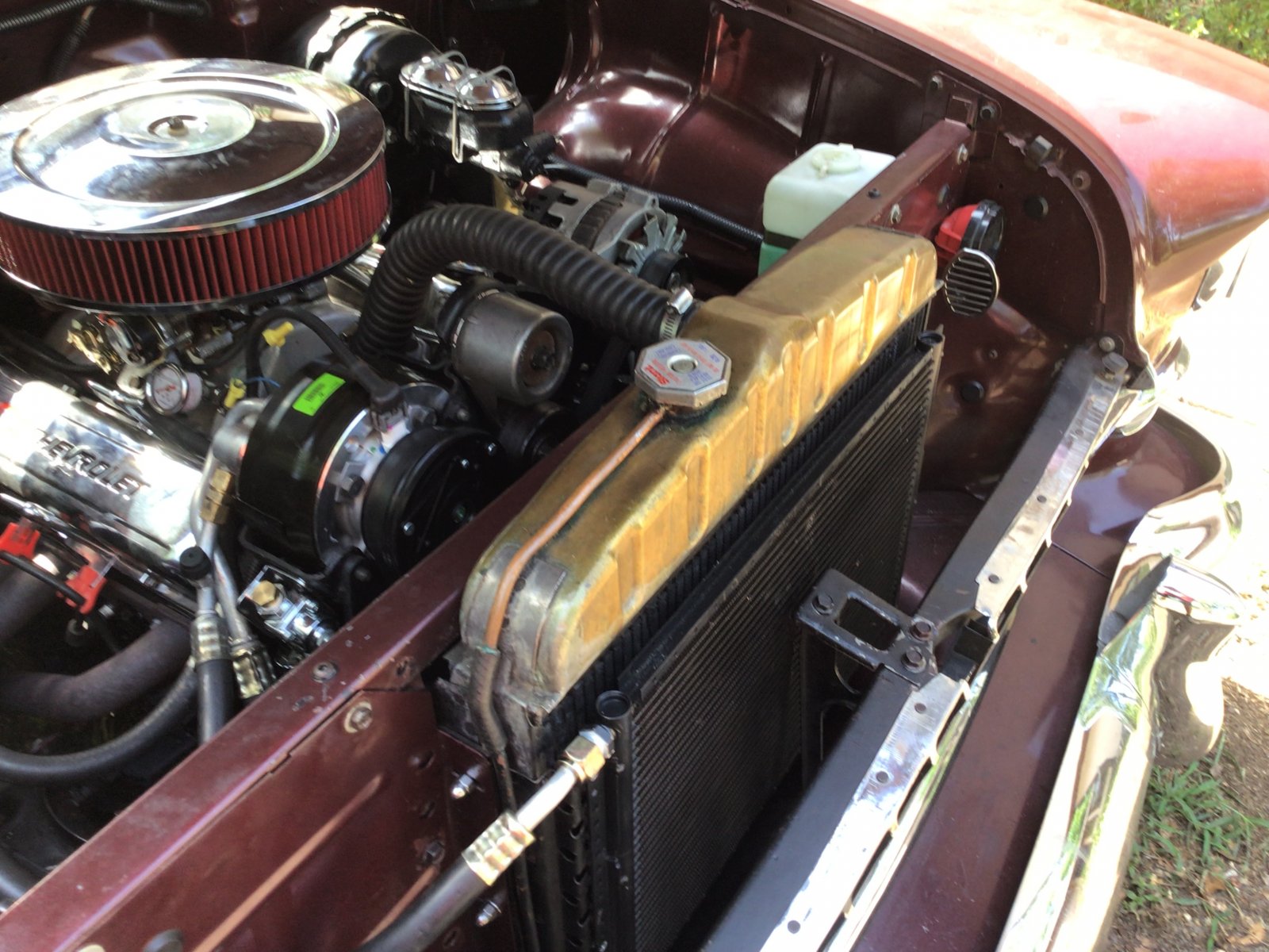

    Just FINALLY got the new AC installed. The weather just got WAY hotter and is in the mid 90s. Prior to install , the engine would hold 180 degrees, plus or minus a needle width. Now she’s running around 210 with the AC on. I haven’t had a chance to joy ride it with the AC off yet, but I ***ume it’ll still hold 180, because the condenser has actually been in place for a while, just not plumbed in.
    I wIll drive it a while with the AC off to verify engine temp. Did I mention it’s HOT outside?
    - I’m running a 180 thermostat.
    -The condenser has about 1/2” clearance in front of the rad.
    - My rad sits in front of the rad support, so an additional fan is not an option.
    - I do not have a fan shroud.
    Current plan is to space the condenser about 1-1/2” from the rad, which requires mod’ing my hood latch. After poking around under the hood of a 93, 95, and 01 truck, it looks like the factory gap is ~ 1-3/4”.
    I’ll also fab up an aluminum shroud.
    Any other amazing tips, advice, or wisdom tidbits before I manage to hose this up?

    okiedokie

  30. AGELE55
    Joined: Jan 4, 2018
    Posts: 669
    AGELE55
    Wow…. Lots of advice and ALL of it is appreciated. In response to multiple suggestions and questions:
    - yes, it’s the 55 Chevy I’m working on.
    - radiator sits forward of the support
    - engine is a 300hp, 350cui, flat tapper.
    - compressor is a new GM R4
    -fan is a stock GM 5 blade clutch fan
    - Freon is not over serviced and probably a little low. I’ll verify pressures a bit later.
    - The (not this particular one) compressor has been holding the belt/ pulley position for the past few years, but had never had the clutch engaged.
    - the condenser was mounted months ago, but not plumbed.
    This car is now and has been for 38 years my EDD ( every day driver). It was primarily built and maintained via the local salvage yards, but now the engine and AC are all NEW stuff.
    After all the input,
    -I will leave the condenser where it is and not increase the gap.
    -I will insulate the suction line more betterer :rolleyes:.
    - I’ll experiment with a home made shroud
    I took it for a spin this morning and it was actually doing better at ~ 190, but the temp outside was probably mid 80s. The heat index yesterday and later today is for around 105-110 degrees. I’m thinking that may play a pretty significant roll. Welcome to Florida in summertime.
