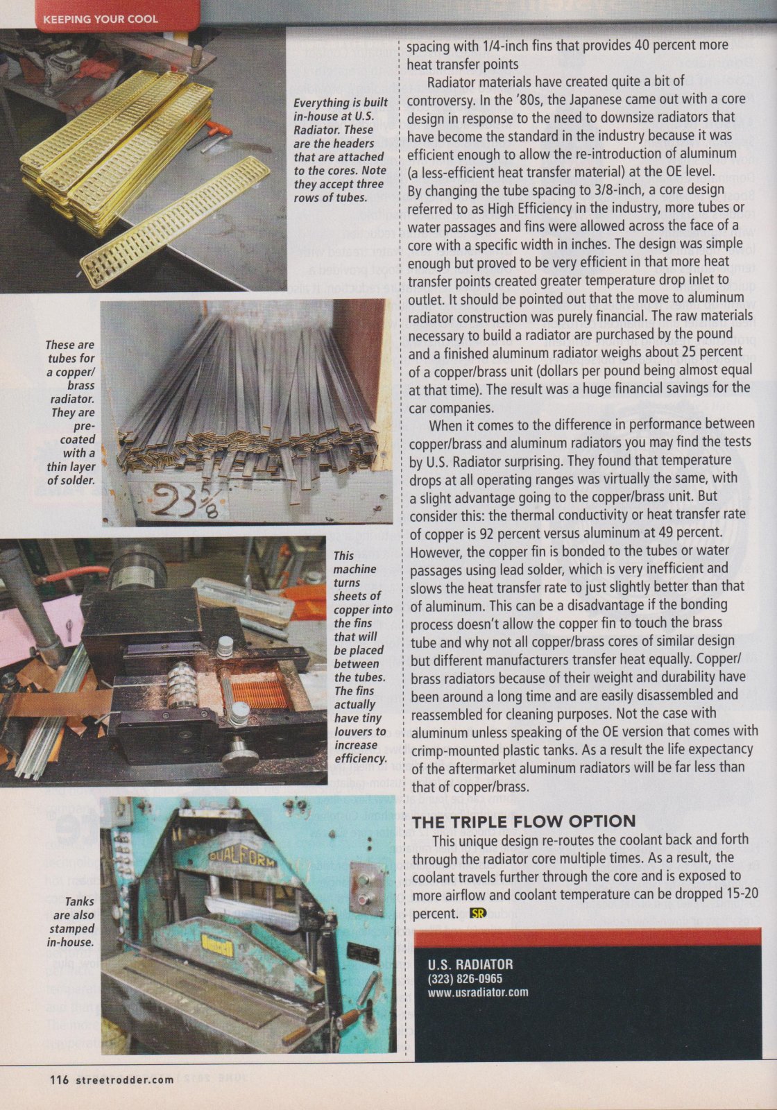

    Here is a magazine article which was written when a radiator was needed for a 55 Chevy......... Notice what it says about the cooling points that actually transfer heat to the air.
    AGELE55 likes this.
