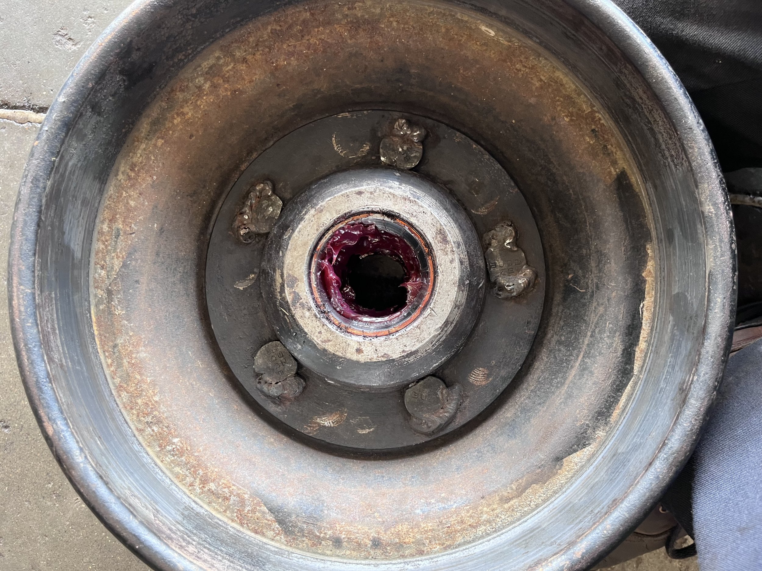

    Are only two of the lug nuts welded?

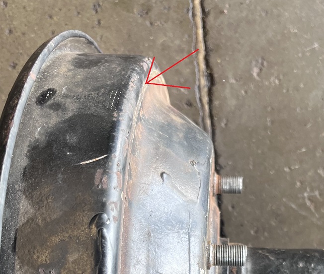

  19. Does this look odd?

    rusty valley
    The raised part that is circled is where it would normally be swedged down onto the drum. You can buy the tool from vendors to do that but in this case they welded it. Seen it many times, it works sorta, the welds often crack

    All are weldes

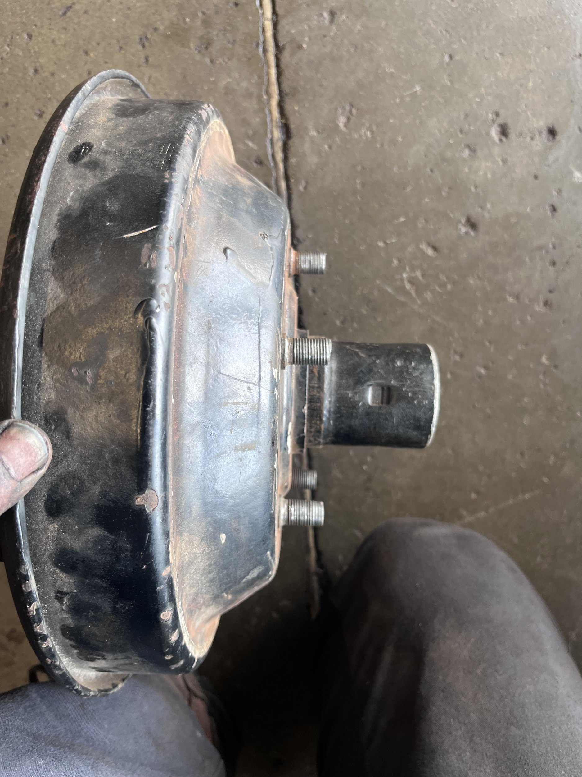

  28. Guess its time to take the other side of , find a straight-edge and compare.

    A
    Does that look right?

    pictures of the wheel?
    looks like it might be seating on the outer part of the drum, instead of the hub?
