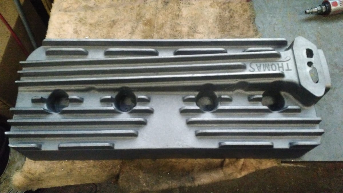

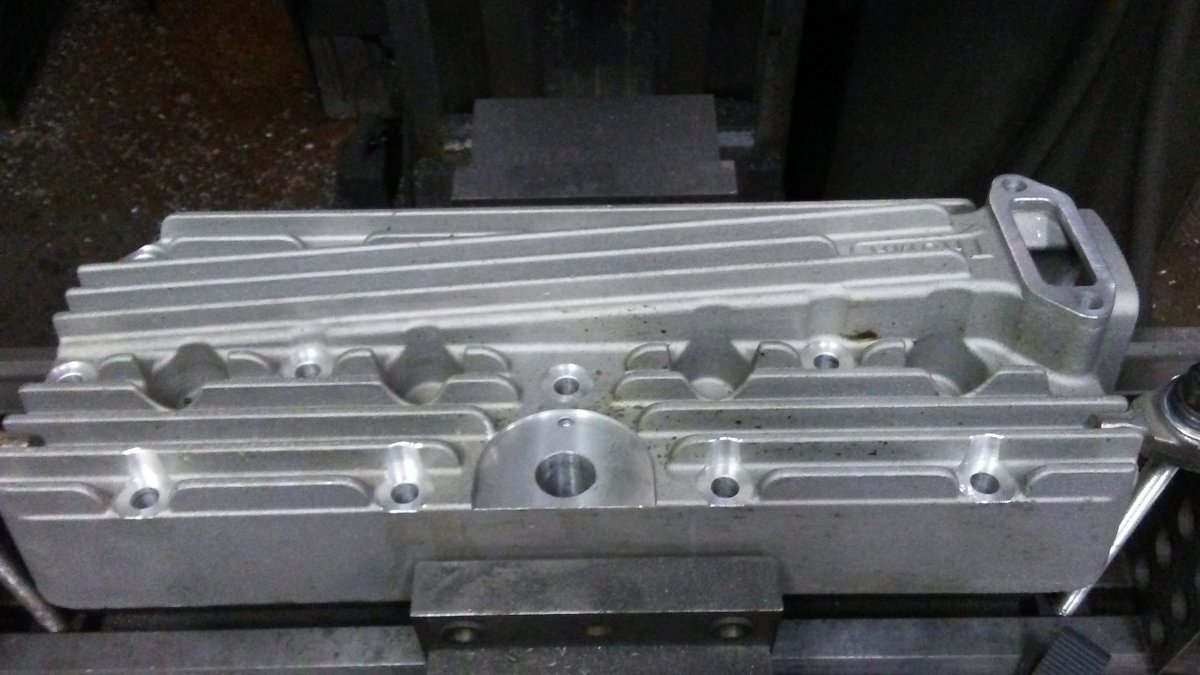

  6. 427designer
    Joined: Aug 15, 2011
    Posts: 234
    427designer
    from Ohio
    3.jpg The first new aluminum and iron Thomas heads through first OP, which is just the top. I am changing my machining process since the tooling I made actually has machine stock on the deck side. I need to put the spark plug holes in as 2nd OP now and then machine the deck side. The aluminum pictured does not have the plug holes yet but the iron does.

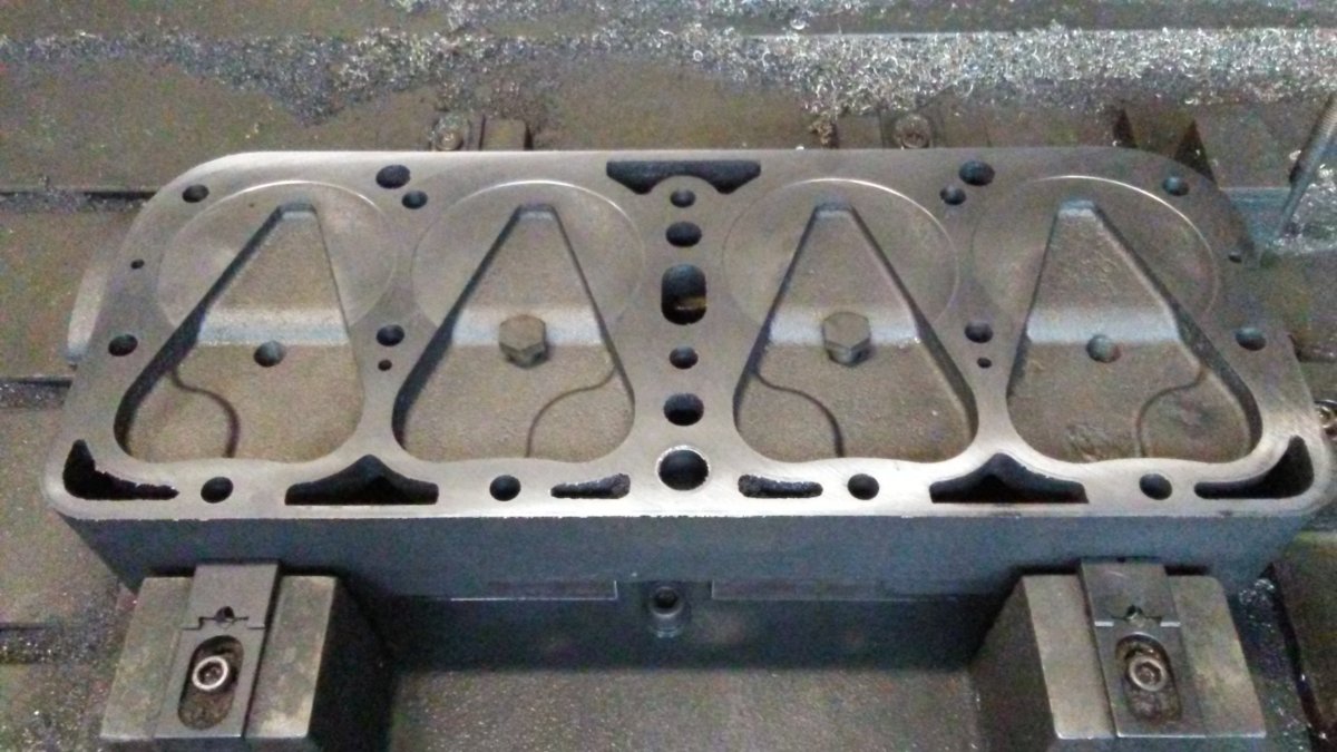

  7. 427designer
    Posts: 234
    427designer
    from Ohio
    The deck side of the new iron Thomas.

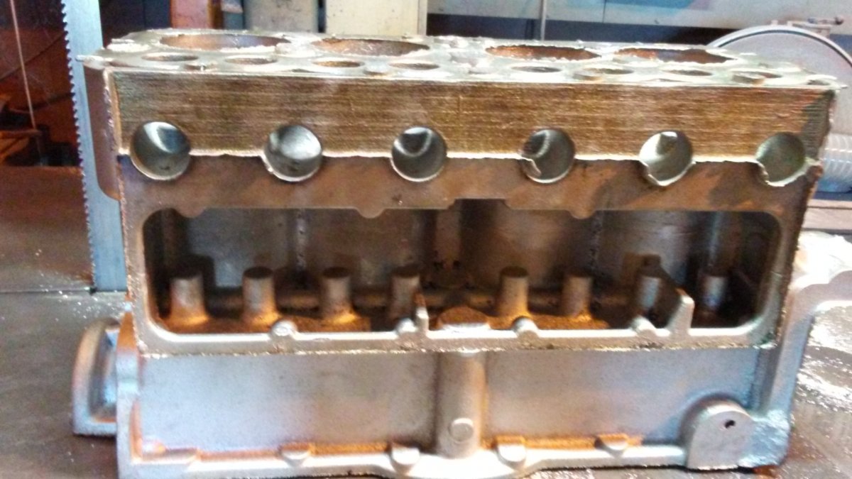

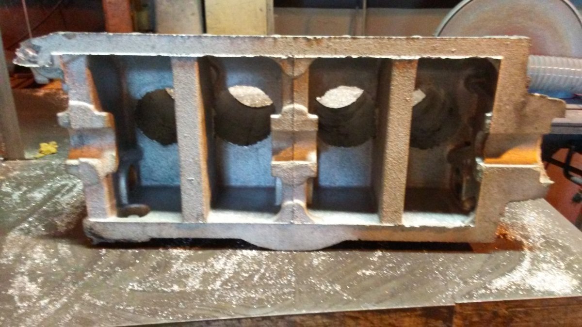

  12. 427designer
    Posts: 234
    427designer
    from Ohio
    OK, here is the second aluminum block cast with filed in 2nd and 4th main journals. The production versions will be far nicer. This one is an experiment to see what would happen. Not perfect, but it will machine up and be buildable.
