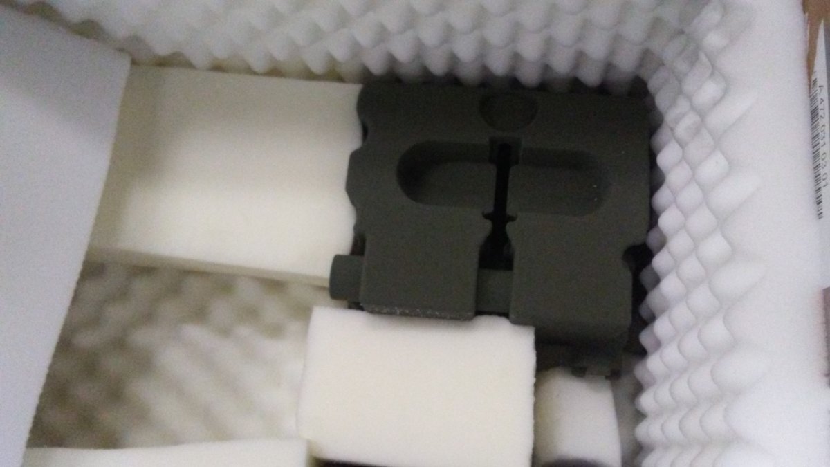

    The first batch of 5 main cores arrived Friday. Looking forward to getting these cast for the first buyers.

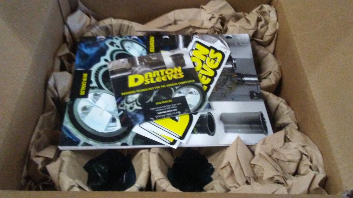

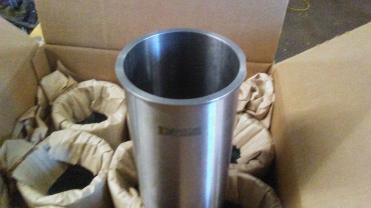

    Some good news. The sleeves I ordered from Darton for the 2 aluminum blocks I have in the shop are on the way!! Can't wait to get these 2 blocks finished for waiting customers. I have several regular and 5 main blocks to cast also. Looks like the new year will start off pretty busy. The OHV heads are almost ready to cast, too.
  12. 427designer
    Joined: Aug 15, 2011
    Posts: 234
    427designer
    from Ohio
    Sleeves!! And, the B head pattern being roughed out.

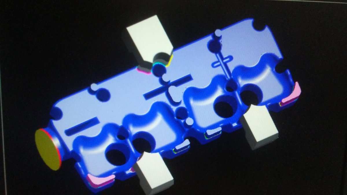

    I am starting to cut the tooling for the 8BA right now. Lots of stuff pushed my schedule back but, Lord willing, I will get there. I am hoping to cast a few OHV heads in the next month or so. Here is the new B head with a second coat of paint. Yes, it took me that long just to get time to do that since I put the first coat on.

    The B head water jacket is almost ready to be made. Sample castings will be next step.

    If you have already said multiple times in this thread or others I apologize but what software do you you to model the heads including water jackets, ports etc?
    Jim
  28. 427designer
    Posts: 234
    427designer
    from Ohio
    I use Surfcam and Solidworks, depending on what my plan of attack is.
    Tod
