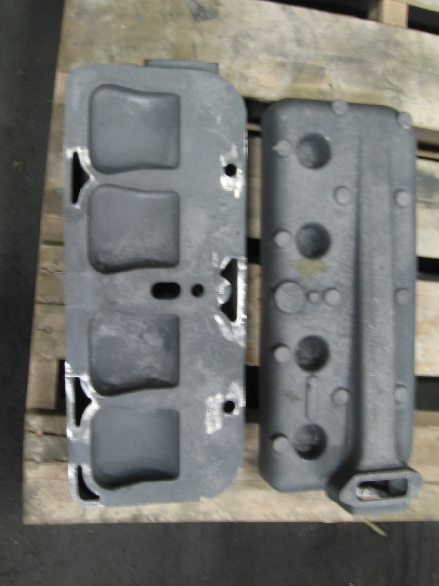

    First 2 iron Winfields. Right out of the molds with no clean up or shot blasting. Sorry for the blurry picture. Took a lot of medicine today to get this far.

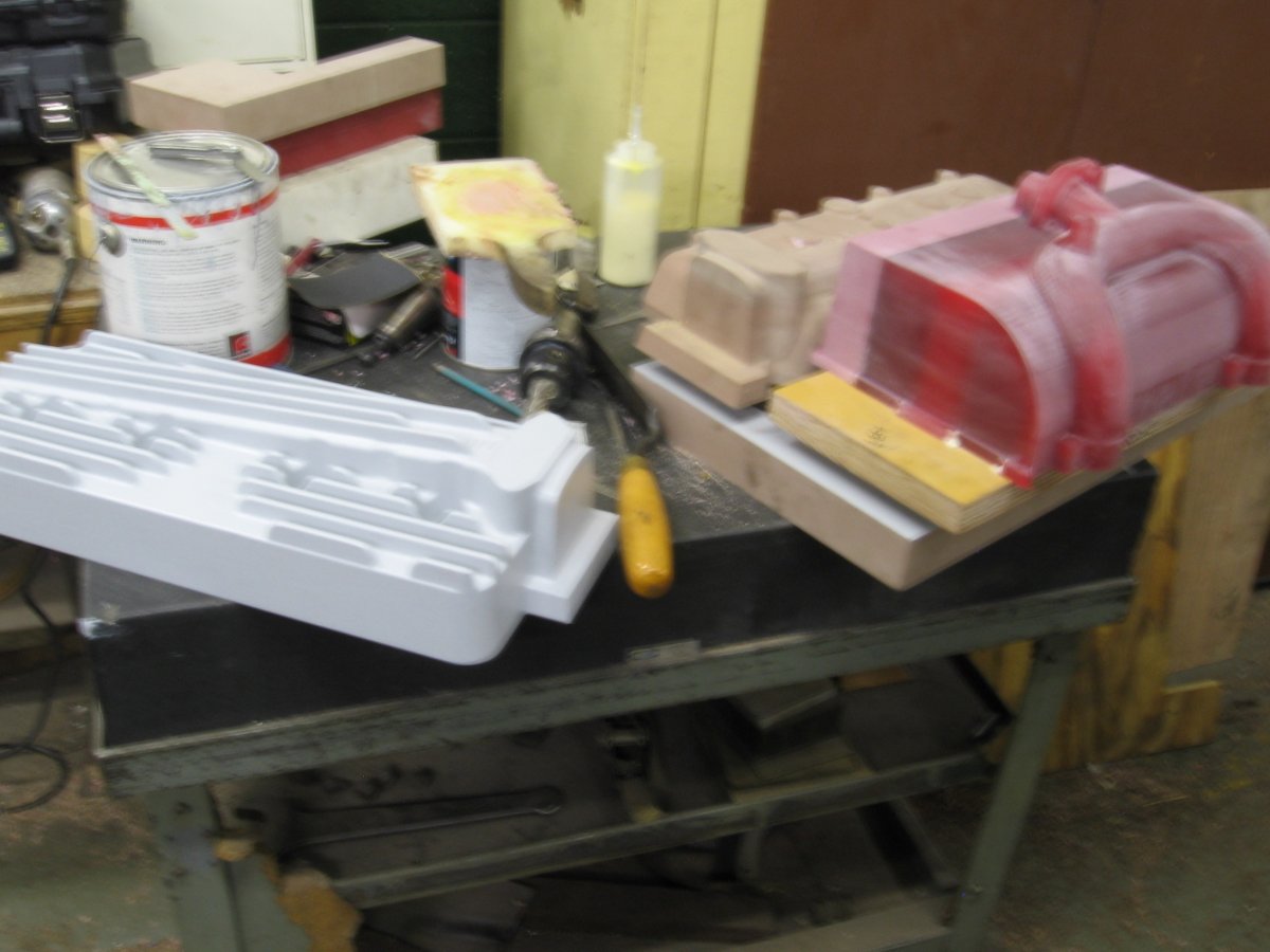

    Here you see one surface plate with the new Thomas pattern, a fresh-cut stock looking head, slated for 6:1 aluminum (or whatever else I want to put under it), the chamber insert for the dual plug (per cylinder) aluminum heads Snyder is after, which can also be made in iron, with a newly cut single carb downdraft intake pattern sitting on top (the red thing). That's just one 24x36 inch surface plate with 4 different projects on it. More pictures make it look like I'm not getting anything accomplished.
    Tod
