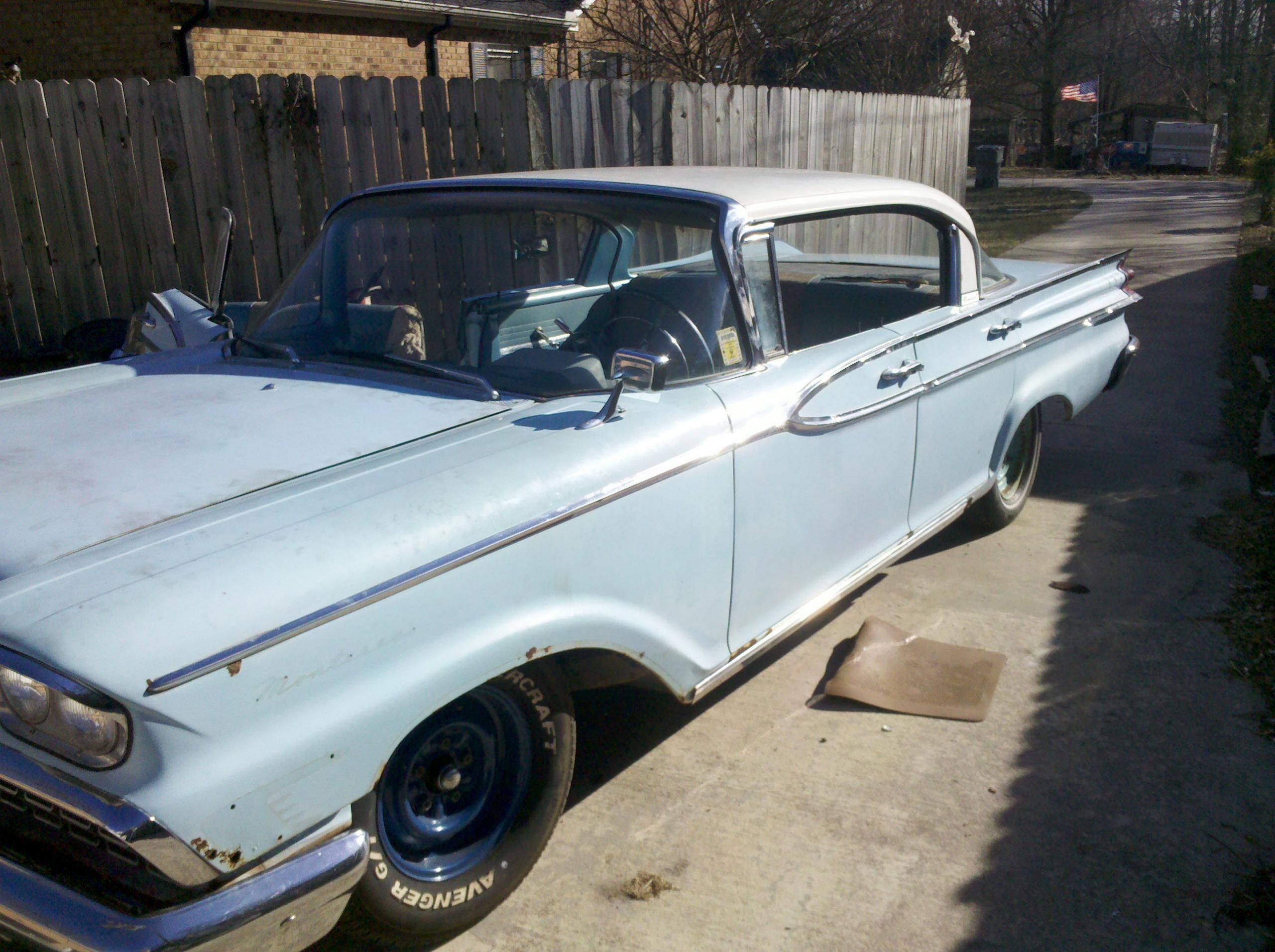

    Bought myself a great driver yesterday, 1959 mercury monterey. Brought her home and didn't do much with her. Figured id start going through it this week to see what all needed done. This afternoon the bf and I decided to take her for a short drive to our friend's house and, well, we got a couple of miles down the road and the wheel flew off. Thanks to some friends, we were able to get a wheel on and limp home. Needless to say, she's gonna need a bit more work now :(

    Posts: 451
    garagerods

    Looks like they spun off. I have no idea how. The mounting holes in the rim were all wallowed out

    That ****s, but luckily the damage is fixable. I wouldn't even want to try to find a replacement fender for one of those.
    I would question the other wheels if this one had wallowed out lug holes. I had a front wheel fly off my '53 once and while it didn't do much body damage, it is horrifying and it makes me always pay special attention to wheel fitment and lug nuts.

    sounds like they were loose, and for probably quite a while.
    I'd be checking all the others

    I know, Jeremy drove it around the block a few times before we took it home and we didn't notice any problems on the way home. I honestly can't understand how this happened. They weren't loose....

    Anyone who wants to judge me and throw their opinions out can go ahead, but I know that this wasn't a situation of shoddy work or idiot fng. I can tell you the wheel was not loose. I don't know how it fell off, but it wasn't because I drove off with a loose wheel.

    He beat me to it. Check the others before you drive it again.
    Take a real good look at the other wheels too as those may not be the correct wheels for the car. When I blew the photo of the car up to see the wheel it looked like the center of the wheel might not fit the hub right. Double click on the photo ( either one, my screw up) and the photo will enlarge for a good look at the wheel.
    Please check them very closely to make sure that they actually do fit the car correctly and aren't just wheels that someone stuck on the car to get rid of it with.
    My wife lost a front wheel off her Caddy on the way home from work that I still think someone tried to take off in the parking lot where she worked then. She had driven that car at least 10,000 miles without a problem and then all the sudden the wheel falls off 3/4 of a mile from the parking lot.

    on left side of the car the natural opposition to the forward rotation of the wheel, is for the lug nuts to come off. they may have been tight but just not as tight as they should have been. It ****s that it happened to your car, but you're not the only one here that has been p***ed by your own wheel. Mine was on..or off of an elcamino

    Did you find any of the lugs? Do they still thread on? Do they go on smooth and tight or do they seem to wiggle around on the threads?
    I had a tire come off a beater once. Turns out the PO put some funky metric lugs on the normal SAE studs.. They threaded on but just wasn't right.
