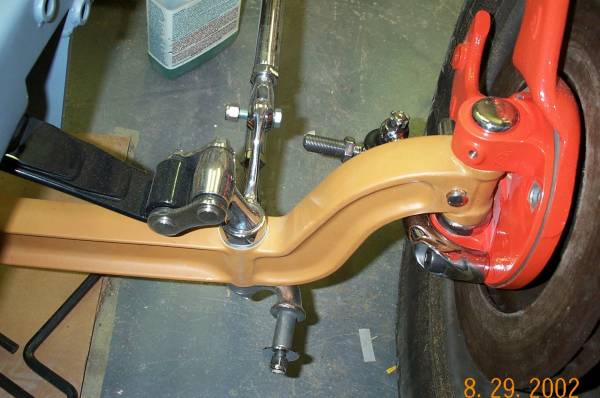

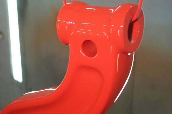

    Now imagine taking that rough axle and using abrasives on a stick of wood to get it flat and uniform, and working on it with progressively finer abrasives over and over until you can see your reflection it, with no ripples or waves. That's what I do. The C-E axle that I polished (shown on the top of the picture) needed three trips to the TIG welder to fill in small low spots. Any axle, old or new, is a ton of work to polish. They're all rough and they're all relatively crude.
    Some of you may not realize who so many of us go through what we do with these old Ford axles. None of the new axles look like an early Ford axle. Once you learn what to look for, you can spot a reproduction axle easily.
