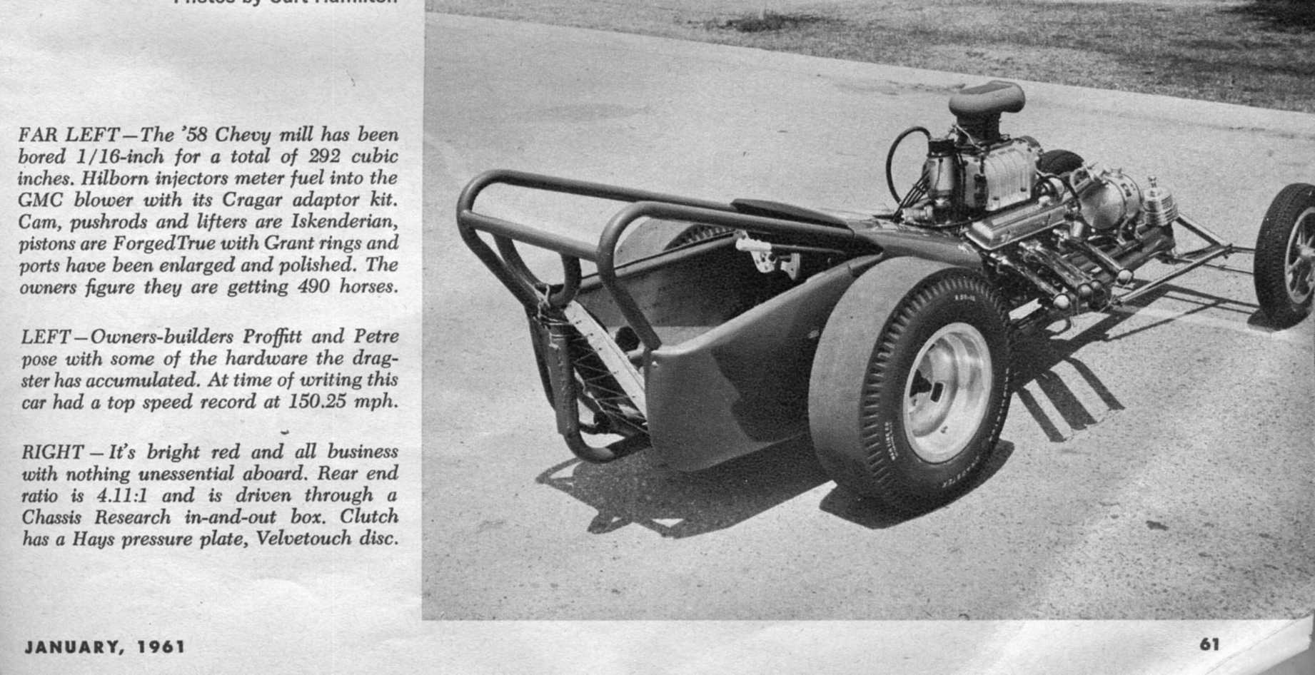

    Hayden Proffits B/D from 1960, doesn't give a w/b but it appears to be shorter than 125"

    Back to wheelbases, I think that you'll find that your inspiration car (nice choice by the way!) has a REAL short wheelbase, about 100-110 inches. I once read that Scotty Fenn (Dragmaster chassis designer) had a theory that a dragsters wheelbase should equal it's rear tire circumference. I don't know if that is true or not, but I have noticed that most cars up to about '64 or '65 were pretty short. That seems to be the turning point that cars got longer, and faster.

    In an attempt to redeem myself, I just quickly cruised through the Hot Rod yearbooks #1 & #2 (1961 & 1962) , and of twelve dragsters featured that listed wheelbases, they were all 93" to 112". The two longer cars 105" and 112" were both twin engined cars. The Chassis Research cars were all listed as 93" to 96". A little shorter than I thought.
