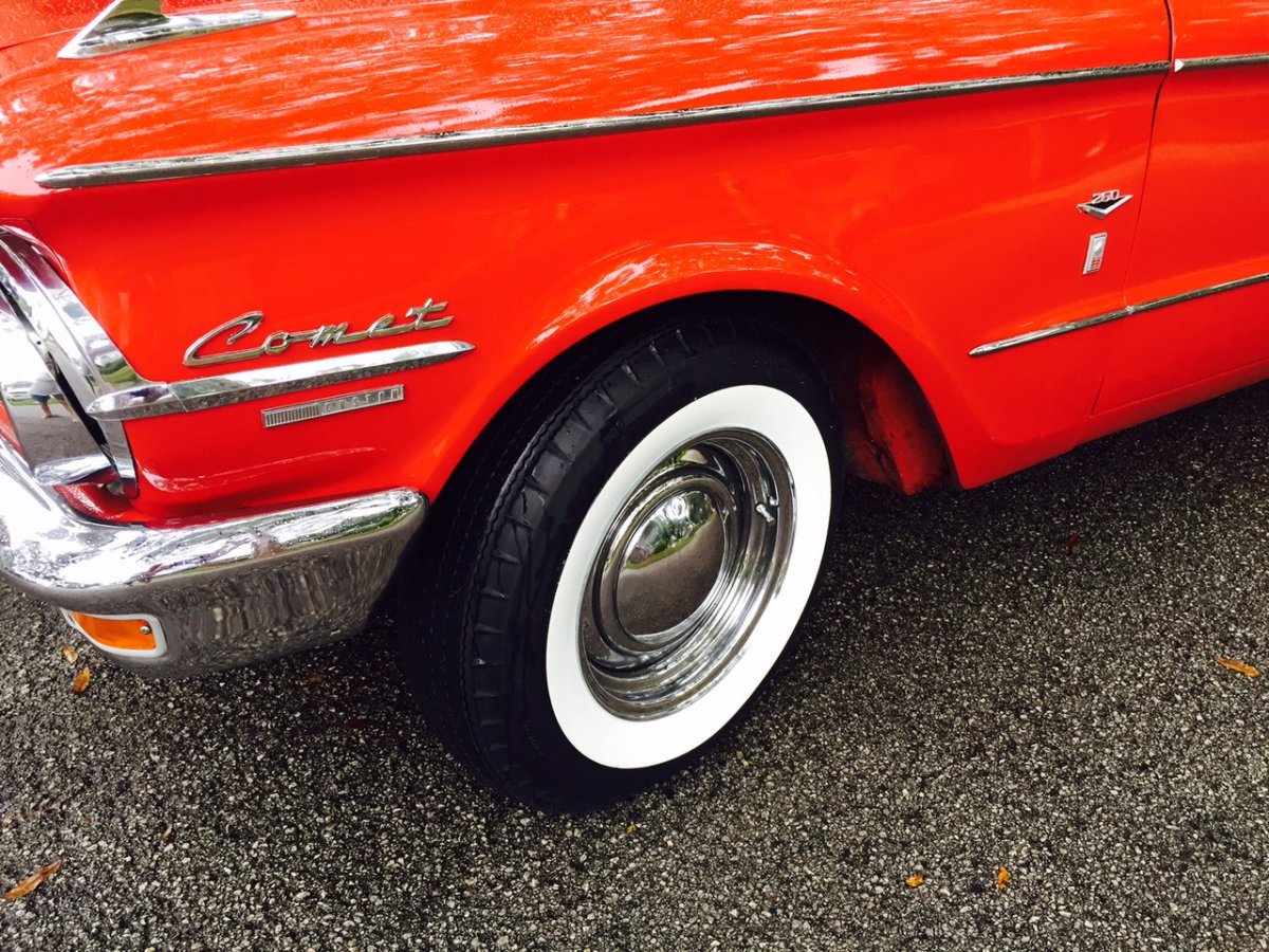

    After reading SR66's post I decided to go with the exact same tires - 750-14s replacing 205/75-14. Very early in my experience but huge difference in ride! Comparing these with the previous beefier 205/75/14 its like having power steering. Also like the way the car sits with the extra inch taller profile. My car is a little later than typically seen with the wider whitewalls, but always thought the 63 Comet was more 50's than 60's in styling. Anyways, at this point very happy with the choice - they were easy to balance as well.
