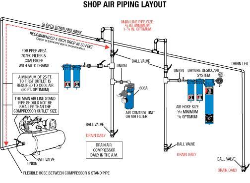

    Which every pipe you use , be sure to use a flex line from the tank to your hard line

    For 18 feet I'd just get a longer hose.
    If moisture is more of a problem than a normal filter will pull out then I'd set up a small second tank (carry tank?) with a fan on it to cool it off.
    I'm going to use the AC radiator from a pickup to cool the air as it comes out of the compressor before it goes into the tank.
    I'm in a humid area so I'll set up water traps at the tank and at the tool end.

    That's some good info. What type of solder should be used for copper air lines? Some of the copper air lines I've seen were silver soldered. Is that over kill?

    I wouldnt say silver solder is over kill at all but it is alot more costly. But if you paint alot and want to have less of a chance of contamination (flux) its not a bad idea. Purging nitrogen as you go will keep the scale of the insides as well. I would use a silver/ nickel type brazing solder (BRIDGET) is the brand I like the most. It is very common in plumbing supply houses. It is considered a soft solder and needs to be used with flux. you can use propane or mapp to heat it.

    PEX joints are not glued.A br*** sleeve or elbow and compression bands are used at all joints.I'm not saying PEX is better than copper but if you're argument against it is based on glued joints ,it ain't so.

    We use Transair epoxy coated aluminum tubing for the air system that are connected by push-to connectors and fittings. No soldering, gluing, threading necessary. Very neat!

    Plastic can and does fail explosively. I have seen it in person, and the shards could have been lethal. 30hp screw compressor, big shop. I asked about the lines the day I was hired, and got the same old "been there for years, just fine" answer.
    One morning at 0600 I walked in the back door, stabbed the compressor start switch & walked the length of the building to make coffee in the office. A minute later I though a grenade had gone off in the shop. A PVC line had shattered mid-span. Not a fitting, just a 4 foot length of pipe missing. Lucky it was in the area that went over the pallet racks, and nobody was in the shop yet.
    Pieces of that pipe had sliced through gaylords, and were stuck in oak pallets. if you had been within six feet of that you would have needed s***ches. It takes an effort with a good utility knife to slice open a gaylord.
    A look at the pipe showed discoloration on the inside of the pipe, penetrating about .020 into the surface. Pieces of that pipe still felt "flexible". Our engineering department believed at the time it was the synthetic compressor oil from the screw compressor that was carried past the oil seperator as vapor that had discolored the pipe.
    There is a lot of stored energy in compressed air or g***es. It is not the same as a hydraulic system.
    PVC pipe is not allowed in a commercial operation. OSHA says no, and they have anecdotal evidence to back up that finding, have a read:
    http://www.osha.gov/dts/hib/hib_data/hib19880520.html
    Copper is the way to go. Vertical drops with a drain near the floor on each drop. That gives you a good 3 feet below the coupler for crud to build up in. Drain the drops once a month, or more often if you have a lot of moisture.

    If you use plastic,CPVC is better but nomater which you use,use ONLY Sch 80.

  14. Be sure to label the lines "compressed air". I would go with copper and the biggest I can afford.

    Over 40 years ago I added a couple hundred feet of additional black pipe to an at the time 25+ year old black pipe system at my old job and plumbed my current home garage with black pipe 25 years ago, both systems still going strong with no problems.

    It was not even very satisfying saying "I told you so". I was just glad it let go when & where it did. To the owner's credit, he called in the local fire sprinkler company & had it replaced with steel & Victaulic couplings. Since it was a 2" line that was what they thought was best.
