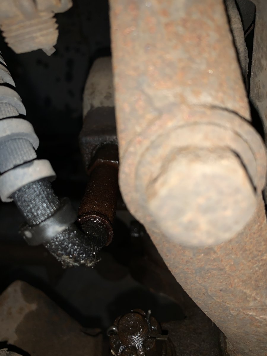

  8. guthriesmith
    Joined: Aug 17, 2006
    Posts: 13,237
    guthriesmith
    I think I found the culprit. Already making me feel like a kid again fixing stuff every night so I could get to school or work the next day. ;)
  9. Elcohaulic
    Joined: Dec 27, 2017
    Posts: 2,213
    Elcohaulic
    Yep you found it..

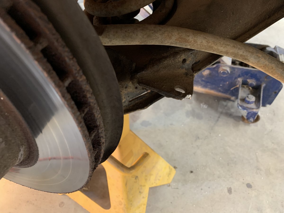

  11. guthriesmith
    Posts: 13,237
    guthriesmith
    Pretty sure I found another problem while fixing the brakes today. These brackets on the a-frames were added at some point which I can only guess might have been stabilizer mounts or something. Anyway, they line up perfect with the lip of a 15” wheel and become the steering stop/wheel weight stripper... Hoping cutting these off after getting the front tires balanced this morning will resolve that annoying vibration it had. There were no weights on the rear of the wheel and pretty sure I know why now.
  12. 4 pedals
    Joined: Oct 8, 2009
    Posts: 987
    4 pedals
    from Nor Cal
    I think you're right on those being sway bar mounts. My friend's 57 retractable hardtop mounts the factory sway bar that way. It looks like you have one mounted differently?
    Devin
  13. guthriesmith
    Posts: 13,237
    guthriesmith
    Yes, there is one mounted through the actual a-arms. These appear to have been added since the welds weren’t pretty. They are gone now.
  14. guthriesmith
    Posts: 13,237
    guthriesmith
    Back in business and the vibration also seems to be gone as best I can tell. I’m sure I’ll keep finding things to fix, but we are at least back to driveable again. :cool:
