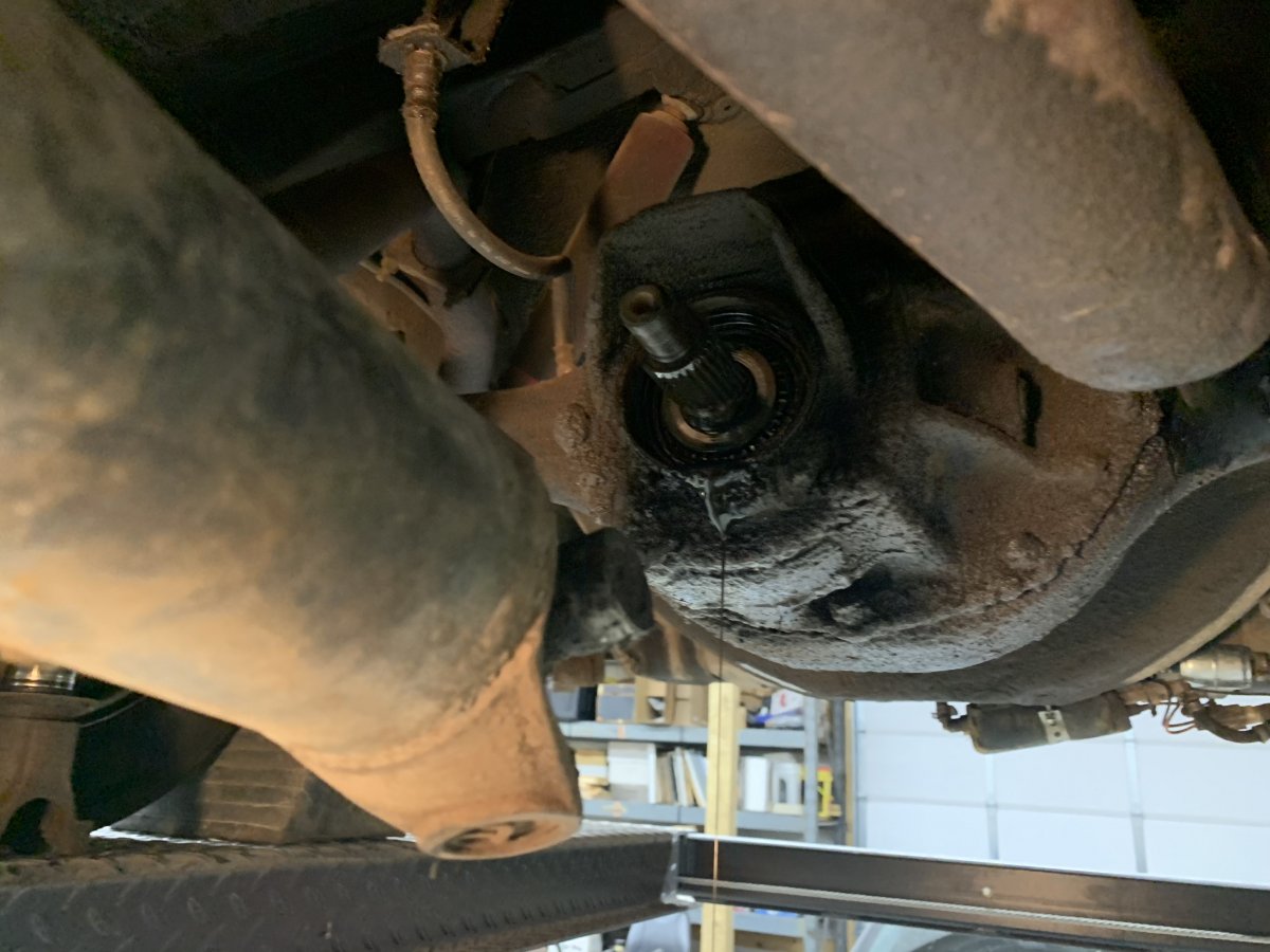

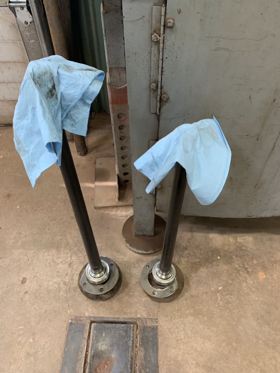

    Pretty sure I found the rolling noise... The bearing on the right was not long from going out since it spit out it’s seal and was puking out the grease. Thankful the left side gave me enough warning to stop driving. I will take the axles to work tomorrow and press the old bearings off and new ones on.
    Hoping I can get it all back together this weekend, but I also have tons of tree limbs to clean up that the ice storm broke off for us.

    Thanks for sharing the wounds. Stay safe during clean up.

    Almost back in business. Just need to put them back in and replace the brake pads while I have it all apart. Nice to have use of lots of tools at work that I can use over lunch break. In case anyone is wondering about the plates...they are spacers to help center the rotors in the calipers and are replacing the 4 washers I pulled out that I didn’t like. They will be sandwiched between the retainer plates and the axle housing. Also nice to have use of a water jet to make stuff like that. :cool:
